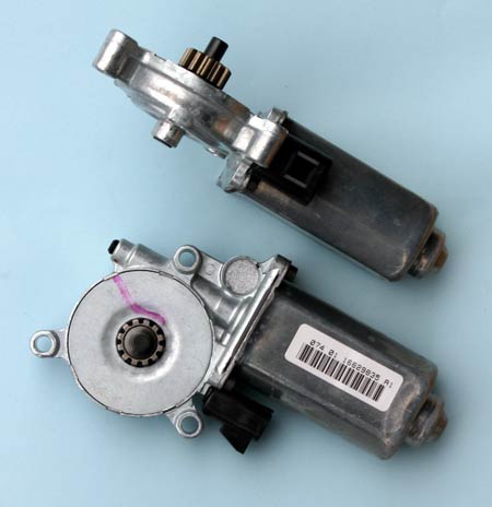

I was opening my window about a month ago and it stopped about half way down making a gear skipping noise. My cheapo 4 year old window motor decided it had had enough, The large plastic gear in the motor lost a few teeth.
Instead of ordering those same motors, I went on a hunt to find an alternative to the crap cheap window motors that the Fiero (and every other GM vehicle) was using at the time. I spent hours on ebay looking at pictures of window motors for various GM vehicles when I finally stumbled on these...
It has the right number of teeth, AND coincidentally, it has the Fiero's connector too! It also has one less gear reduction, so the output gear is naturally faster. So I bought this one (22155409) and its mirror image (22155408)
Once I got them in, I wanted to make sure that the gear shared the same diameter, as well as tooth pitch.
Clearly, it does, It also has the same shaft stub diameter... This was looking pretty promising now.
So I went ahead and made an adapter plate. I also had to make a stub shaft extension, as the shaft is a bit shorter, and it didn't quite reach the hole that the original would ride in. I tried running the motor without the stub shaft support. Although it did work, it was causing the Fiero's window motor bracket to flex much more than it should have. The shaft doesn't rotate fortunately, the gear only rides on it as a guide, just like the Fiero's motor.
Mounted!
And... Testing!
I did have to extend the connector for the window motor a bit, this motor's connector is on the other end of the motor itself, so there are a couple of little mods required to make it all work. Totally worth it!
My motors are also on relay control, so that the weak amperage capacity of the window switches are not slowing things down. I'd say with this motor swap, that these windows are as fast as any modern cars windows, and for the brief time being... I probably have the fastest window's on a Fiero. I have yet to do the passengers side window yet, so the adapter bracket hasn't been designed or tested yet. Another perk, it's practically silent. These window motors don't really make any noise at all.

I plan on making an adapter kit. I just have to build one for the passenger side. I did cad out the adapter, so soon I'm thinking I can offer a kit. We'll see how that all goes.
Any idea what vehicle these motors came out of? Great work BTW!

A search of the GM Part No reveals a long list of donor vehicles:
22155409 / 22155408 Window Motor Driver New GM OE Part

Excellent research! I had thought there may be "faster" motors we could use.
But finding information to compare was difficult beyond the 9-tooth, 10-tooth or 12-tooth (Fiero) drive gear.
These appear to be the same with a longer stub shaft.
It would save the hassle of having to make a shaft extension.
Chev Express / GMC Savanna vans pictured.
These guys have window motors for everything!
Maybe they could find an even closer match.
https://www.a1electric.com/motors.htm

Those motors look physically the same as the ones I found, but the connector appears different. The shaft length looks the same too by a visual.
It was hard to tell from comparing the pics.
Is it the adapter plate that makes lengthening the stub shaft necessary?
I just got a set from a 2001 GMC Savanna at PnP.
The shaft is 5/16" diameter and 3/8" long from gear to end for comparison.
Overall length from face of motor to end of shaft is 15/16"
The different connector isn't a problem as I got and chunk of the harness, as you mentioned the stock wiring is too short anyway.
It may that the only reason for the different part number is because of the different connector.
The Cadillac motors mt22062567 mt22062568 appear to have the wider gears like the Fiero motors.
See here https://www.a1electric.com/.../cat_cadillacmtr.htm

I found that even if the adapter plate was non existent in thickness, the shaft would almost reach the hole, but not quite. The plate does two things, it gives the motor something to bolt to, and it guides the partial gear on the arm. I tested the motor without the stub extension and it worked fine, but once it encountered the end of the partial gear, the shaft moved significantly. So I knew it was going to be a requirement. The shaft is about 1/8" short. Really though, the shaft extension isn't complicated, though I can make something better than I did on this first window.
The motor you describe from the van pretty much is exactly the same as mine. I'm betting that the connector is the only difference.

Looking at the pictures its hard to tell but just what is the thickness of the adapter plate? looks to be aluminum 1/4' thick?
would putting the plate on the other side of the motor help in any way with the length of the shaft problem?
just questions, many times when fixing a problem I find after the fact that if I had done something just a little different it would have made a big difference or worked better.
