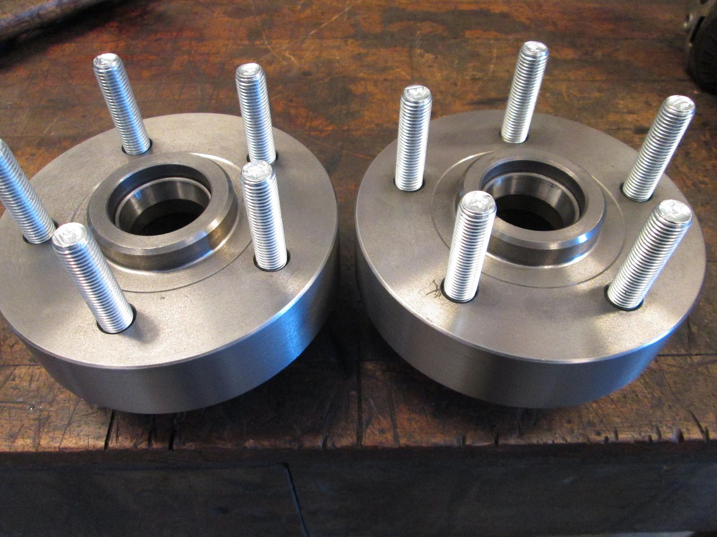

Well I found a few things out when chucking these hubs up in the lathe. First one of the two wasn't even initially machined centrally from the factory. There is an obvious "wobble" as it spins (viewing from the backside) where the thickness is not consistent. It goes from 0.2 inches to 0.4 inches roughly in thickness on the backside. Even the other hub measures at roughly 0.4xx inches and I am afraid any more machine work will leave too thin of a wall.
I'm currently working on uploading some pictures to show my issues and will be contacting the forum member who sold me them to see what we can do about the product I currently have. One of them seems pretty off to be balanced properly and I don't think it's useable for any brake upgrade.
**Looking again at the pictures fieroguru posted, maybe I don't need to worry about the thin wall and just cut more material off to remove the wall entirely. This would reduce the "uncentered" cut that the hub came with initially.
You should be able to see the difference in the hub on the left if you look at the outer wall thickness around it's circumference.

Report this Post05-28-2014 11:07 PM Click Here to See the Profile for Lou6t4gtoSend a Private Message to Lou6t4gtoEdit/Delete MessageReply w/QuoteDirect Link to This Post
Man, that looks to Me like that hub is Unusable ! that'll be so unbalanced there will be No way to rebalance it.

Report this Post05-29-2014 12:50 PM Click Here to See the Profile for fieroguruSend a Private Message to fieroguruEdit/Delete MessageReply w/QuoteDirect Link to This Post
Many cast parts are not completely uniform or true as they are cast... while you might not like the look of these, you will be hard pressed to buy new ones that are cast "perfectly". I buy a lot of new hubs from my local Napa and see some from time to time that have the same "as cast" irregularity.
Once the hubs pictured are turned down to fit inside the Grand Am rotor, the thin side of the outer ring material will be completely removed and the thicker side will still have material in the outer ring. On the hubs I machine for the Grand Am swap, I take the rear portion of the hub down and completely remove the outer ring and only leave the 5 support spokes. Doing it this way isolates the remaining "as cast" imbalance to the center hub surface.
Rotational vibration comes from 3 main factors: mass of the imbalance, distance from the imbalance from the rotational center, and rate of rotation. Since this additional weight will be quite small, about 1" from the rotation center , spin at about 880 rpm at 60 mph (24" tires), I doubt there will be any noticeable vibration.
If you wanted to, you could take the hubs in and have them rebalance by removing material from the exposed webs.
