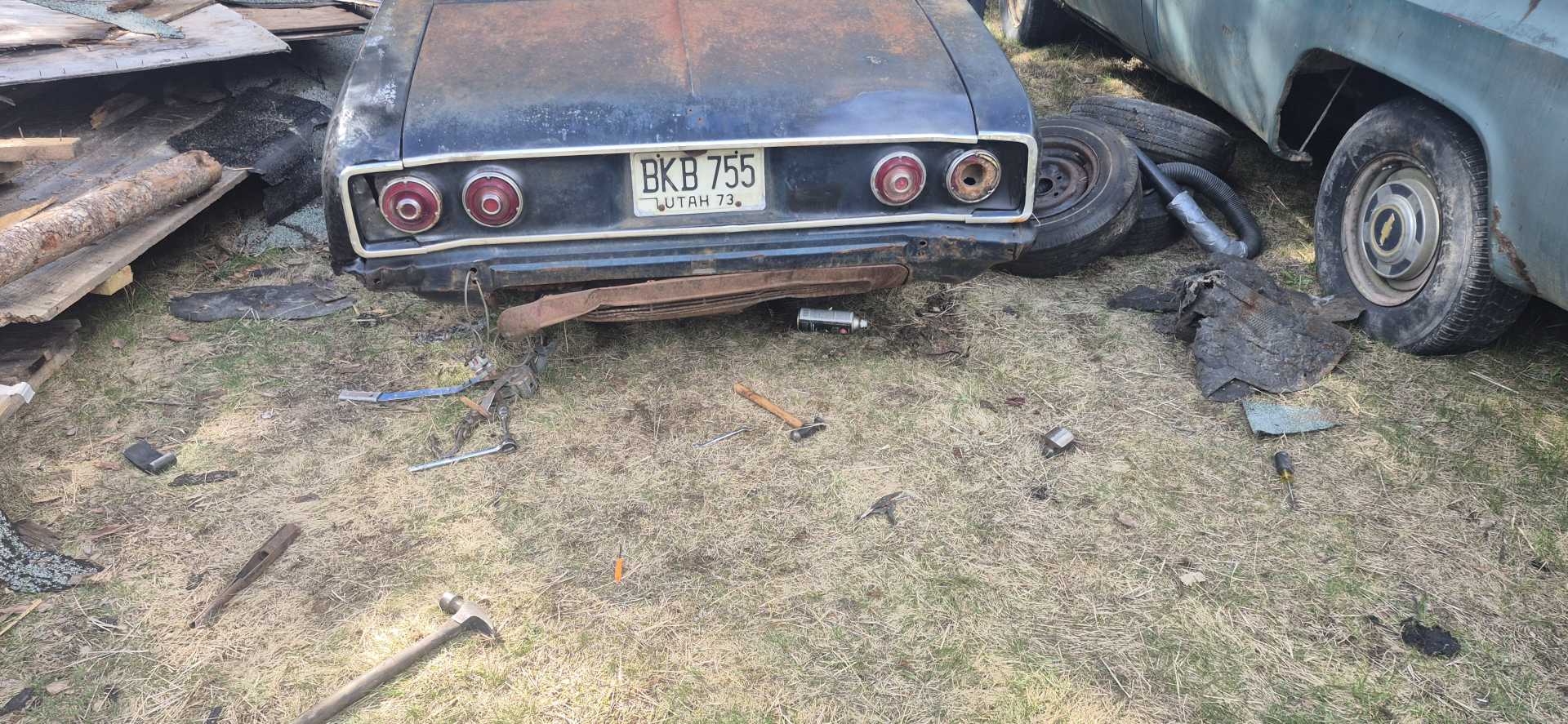

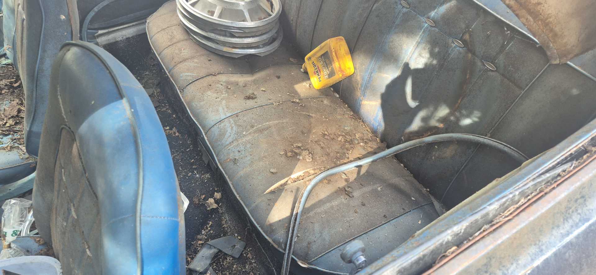

got it home and ended up finding everything but the rear bumper. managed to save the rear drums while getting the rusted pads removed. lotta deadblow hammer, heat and pb blaster but hey it rolled onto the trailer and i can begin some bodywork and cleaning. next week im getting some help to rip the rat infested headliner out and begin cutting back the rust to strong metal and fabbing patch panels and some frame reinforcements (unibody is in great shape but the battery tray area is gone and the edge of that rail needs help and i have a section from another car)
the engine is probably gonna have to come out since its pretty stuck and needs the pulleys repaired and carbs....dealt with...
