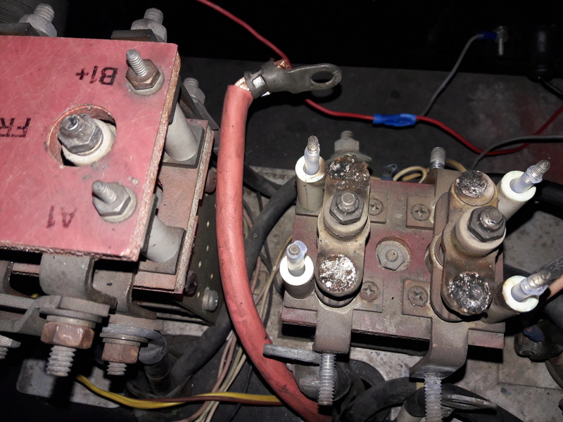

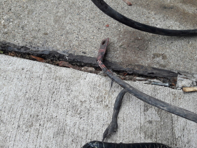

the electric system on this is hillarious. non insulated spade connectors on everything. So tarnished and oxidized every last one of them. The acc. system runs on 12v for some of it, 18 for others. some of the 18v circuits use a resistor to drop it to 12v at the device, for example the wiper motor.

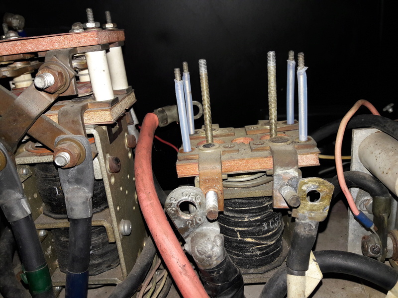

The drive system uses a series of contactors essentially giving the gas pedal 3 positions rather than a pot setup. It switches batteries parrallel through a monster resistor for speed 1 (10mph), parrallel without resistor for speed 2 (20mph) and series for speed 3 (38?mph) Its wonderfully archaic. If it drives me nuts, I may consider switching to a modern controller. For now, I only have one set of contacts that look not so hot, but I do think i can save them. Many of the electronic boards have riveted connections for terminals. Most of these are loose. IDK yet how to approach that repair, re rivet or solder.

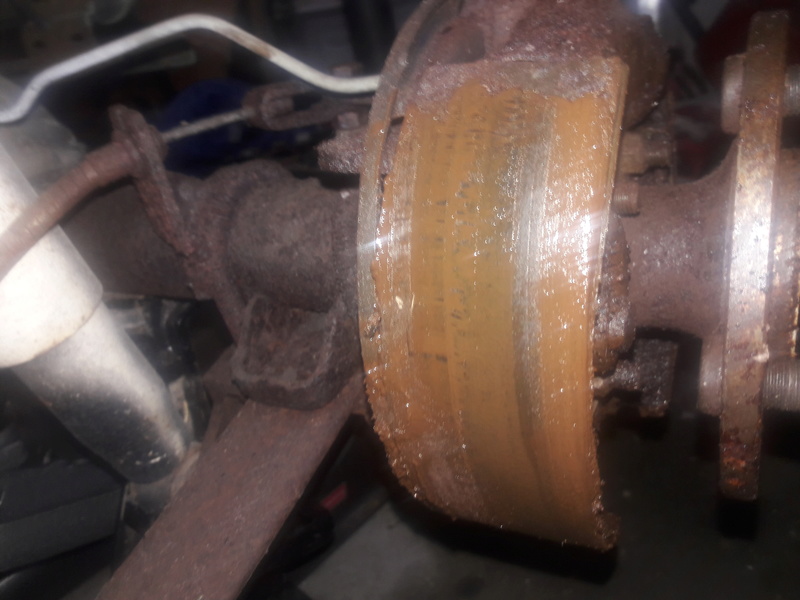

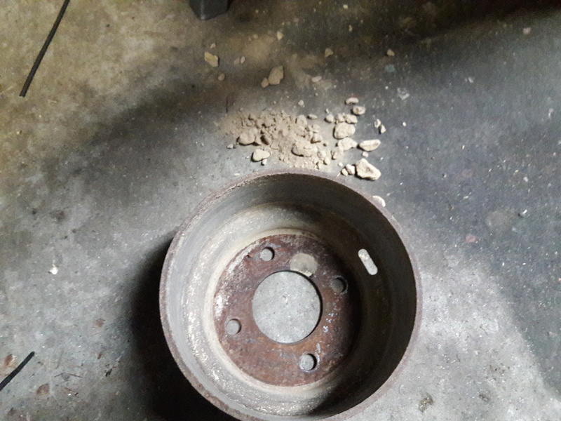

The early cars had disc brakes up front. They were so bad the late cars went to 4 drums. Go figure.

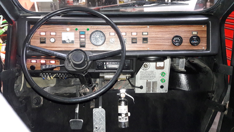

I had to pick somewhere to start, so I have begun cleaning every connection in the car. I started in the dash hoping to become familiar with the whole thing, and have it clean when I begin testing the harness. If you are familiar with Lucas products you might recognise the turn signal stalk. I find it humorous that an American electric car used Lucas electrical.
Here are some shots of the dash and connector cleaning. I think I'm going to need some deoxit. this is all pretty crusty.

Its going very well so far, I have all the dash connectors clean now. I removed the extra aftermarket fuse panel. It ran the horn through a stupid extra switch electrical taped to the steering column, the radio, dome light, and put 12v on an 18v gauge. I dont know why. In the process of sorting those back the way they should be. The wiring seems like a breeze after the fiero swap. I did put 12v on the control system last night and it came to life! The contactors are functioning, along with the pedal controls, as well as the wipers, lights, turn signals. I tested the 48v charger that is out of the car and has clip on terminals instead of being mounted under the dash. I dont know why either. It tested ok for me, so I'm going to put it back under the dash, and wire the plug to the fender receptacle again. It seems plausible that the p.o. had put a battery where the charger was to run the 12v system rather than pulling off 2 of the 6v. That might explain the strange wiring and charger pulled out. I don't know why anyone would want that, unless it was driven at night a lot, or the radio was on when parked hanging out for long periods. I don't plan on doing much of either of those things. If the horn button on the turn signal stalk is bad, I'll replace it. It is still available it think, a lucas part common on the MG spitfire?

I know, all unsealed copper spade connectors. I feel like this thing was built for Russian cosmonauts. I'm nearing completion on the front half wiring. there were a few chop jobs throughout. One interesting find, and you cant do this unless you have a plastic car... The marker light had a 12v supply going to the light frame instead of the bulb terminal. the bulb was grounded instead. It didnt work anyways since one person did some wiring, then another I expect as the supply line was also spliced to a ground (since it looked like a ground). I still have to deal with the horn, courtesy lights and radio.

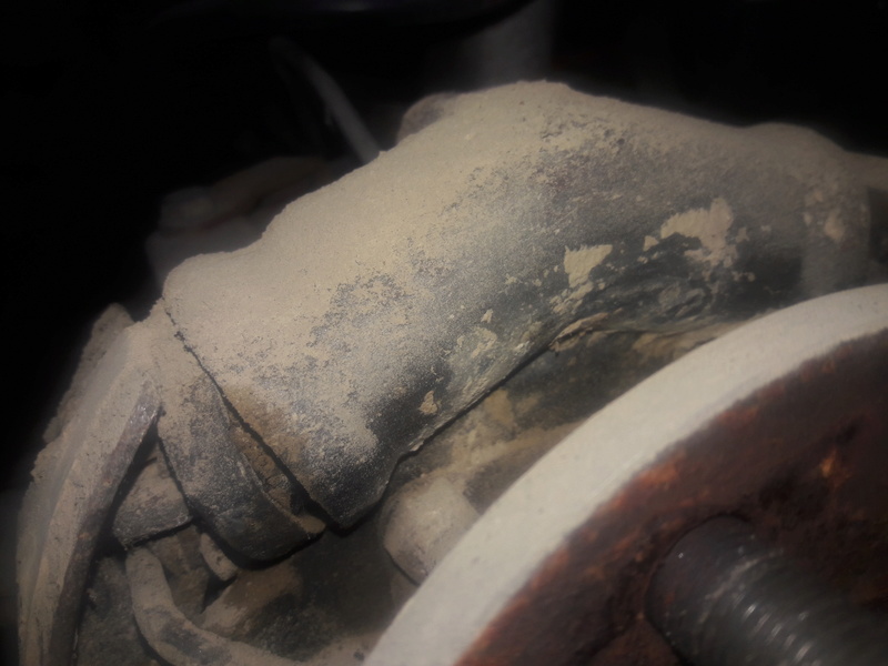

Whats up with the mud daubers in WV? I've never seen so many. Almost every air vent was full of them (old dead thankfully), packed almost completely. fist size!

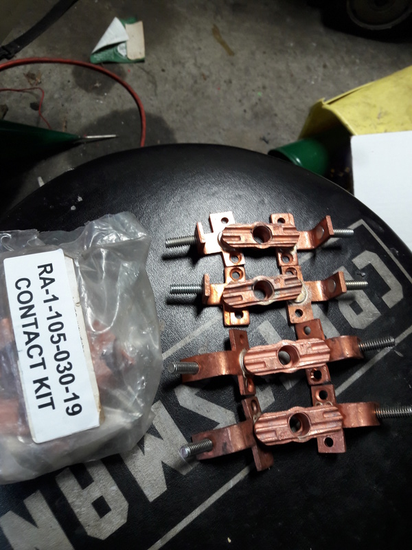

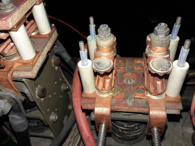

Hopefully, I'll be on to the High power side this weekend, including the contactor array and motor. The speed control on this is something to behold. I'll make sure to take some pics during the process, and the completed mess no more dashboard.

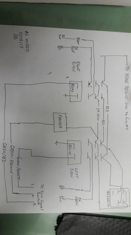

I finally completed the turn/head/parking light circuit. I ran into some problems in the rear where a ground wire had burned up. Generally, every ground is a copper (or steel) ring screwed into an aluminum frame. Corrosion is a real problem with all of them.
I'm going through the brake lighting now. In all the diagrams, there are 4 brake switches referenced, and not always clearly noted as to which one is referred to, just "brake sw". Is it the parking brake sw, the brake warning sw, the pedal sw that cuts power, or the brake light sw. So I fight through it.
An interesting note, the brake light switch is on the brake line and is a pressure switch. So, if you loose hydraulic pressure and are frantically pumping the brakes, at least nobody will know. I've never seen a pressure switch used as a brake light switch, so thats new to me. For a while I really thought it was part of the warning circuit.

This picture from whenever shous the lights on. It prove that the wiring has been jacked for a while. Both the parking lights and turns are lit.
This is a page from the service manual. It is lies.
I was really annoyed with the brakes and turns. As it turns out the manual was misprinted, or never updated to a newer schematic. Which really threw me for a loop.
This is how it should have been drawn, and how it is wired now.
to put it simply, the contacts in the relay really go from top to bottom:
NC
NO
COM
The manual has it drawn as:
NC
COM
NO

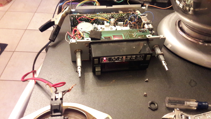

All of of the 12v circuits are now complete, except the horn which is tonights project. along with mounting the charger under the dash where it belongs.
My radio sucks, the power switch does not work right. I'll have to decide if I want to address that while the dash is open. Its an aftermarket "rampage" head unit. It is a post/knob mount radio. I'm not sure if they still make stuff like that. I may just source a period correct replacement from some other manufacturer. There is only mono. 1 speaker in the dash. I'm not even sure modern stereos can output to 1 channel.

I got a lot done this weekend.
The dash is wired and fully functional, the whole 12v and 18v system is.
I also got the charger mounted. As it turns out I have a charger from an early model. The newer ones are a different shape and are not so visible. Really, I like this setup just fine.
I fixed the stereo too. the on off switch on the vol. pot went bad. I'd really like to replace this with a period correct delco of some sort.
Then, I moved on to the contactors. There is a dpst and a dpdt. The contacts are pretty bad. I cleaned them up enough they will work, but I need to decide an alternative in the future. Either source new contacts, repair these ones, or go all electronic controller.
I swapped the worst ones to the reverse circuit. Only about 4 contacts were what I would normally consider useable, but I filed the rest to get some testing and the end of their service life out of them. It's not ideal, but it's all I've got for now. I have to go through some books to reference the contactor parts. I think forklifts use a similar setup, but It may turn out to be very difficult to find the correct ones.
I'm leaning towards a new modern controller. The curtis ebay imitations are pretty cheap. I'd need at least a 500a 48v controller, so it gets $ fast. Perhaps someone will wreck a golf cart on craigslist in the future. The Newer alltrax ones would be right on for what i'd need, but are even bigger $ for good reason.

I found some contacts and bought them off ebay, from a raymond forklift. My mail carrier can't read and delivered them somewhere other than my house. I'm bummed out about that. IDK if I will ever see them and they were not cheap. If they never show, I might have to go with a modern golf cart controller.

If you are comparing these to the drawing in the service manual, you are right that they don't look the same. The later cars have a slightly different contactor arrangement due to the location. Some were under the seat. Some like this were in the cargo area. The wires point different, and the bridges are different. These appear to fit mine just right.

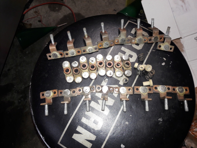

Out with old
In with new
I'm lucky they fit! All the contacts and springs are a match,. The ceramics did not all fit the f/r contactor. Since it is a little taller. I just re used my good used ceramics.

Lots of work done. All electrical should be good to go. My hi voltage cables were really bad.
So I replaced them all.

Well, I got in to the rear brakes. They are going to be a bigger problem than I had hoped.
The right rear could be worse, It too was chock full of mud daubers, which may or may not have contributed in the disintegration of the shoes. The brake spider looks like I might be able to rebuild it.
smallest drum ever
Now, the left side... this chunk of metal was floating around. It is a tab from the cast spider that holds the shoe. The whole spider needs replacement. Which are still available, Or I guess I could weld it, but it's cast and has to be pulled to weld it anyways so that seems stupid since it's a brake part.
It's leaky, wet and rusty in here.
Unfortunately, my manual does not get in to detail for the dana axle (used on transitional citicar and comuta car)
Soooo, Best I can tell, the axle needs to be pulled to gain access to the spider. I think the retainer is on the outer bearing, so the whole axle shaft/brakes come out then get pressed apart. I've been told its a similar process to a ford 9" I can still get a retaining ring for this process, although not cheap from ev performance. I'm unsure at this point where to source a seal.
Good news, the fronts are much easier to do when I get there.
