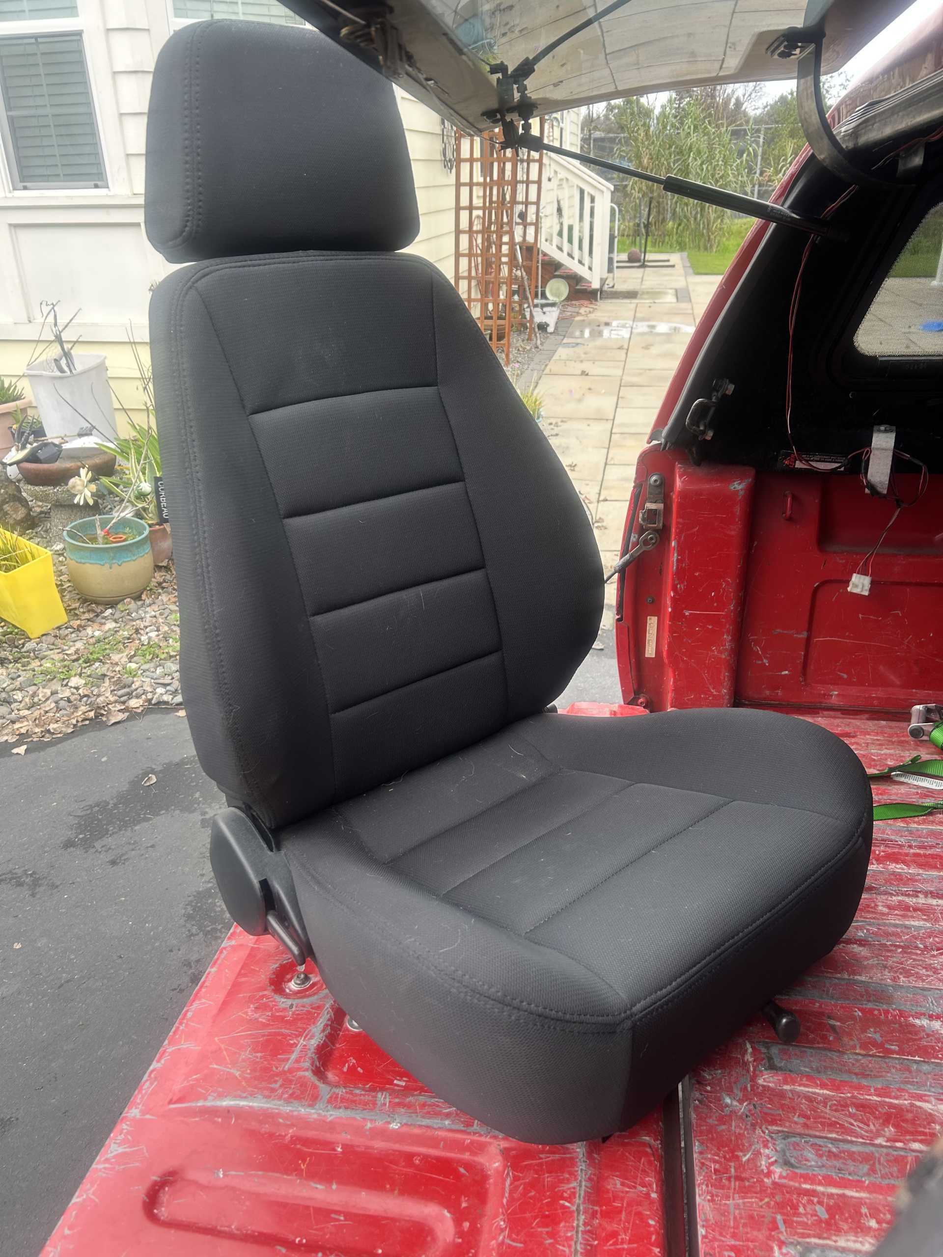

I just purchased a set of new Corbeau Sport seats and wanted to share my experience. I did not purchase the Fiero specifics adapters offered because I wanted to see the fitment first. I simply unbolted our STOCK seat rail, unbolted their seat rails, and there were 3 other sets of holes. One set of holes were EXACTLY our set pattern and made this a simple bolt in. No need for there special bracket. I have an intermittent failing back problem and sitting in the stock seat driving a stick shift really hurts after an hour or so. I am hoping this will help. They make you sit about 2” higher than stock though. But, I’m 5’11” and my ride is a T-top so I have “more headroom”. Car is not road worthy yet, I’m doing a 3.4 swap and it’s going real slow in my more advanced age LOL.
