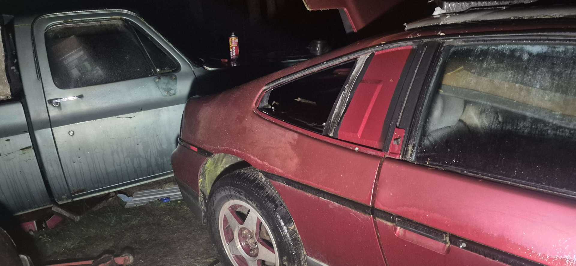

made more progress, ive dropped the tank for the 5th time since i got it and apparantly i lost the new pump i bought a year ago.....at least it was only a trugrade
also uhh dont jack your car up like me ig? corvair rims make good jackstands at least
edit:awful picture and im cold and wet so im not gonna take another.
