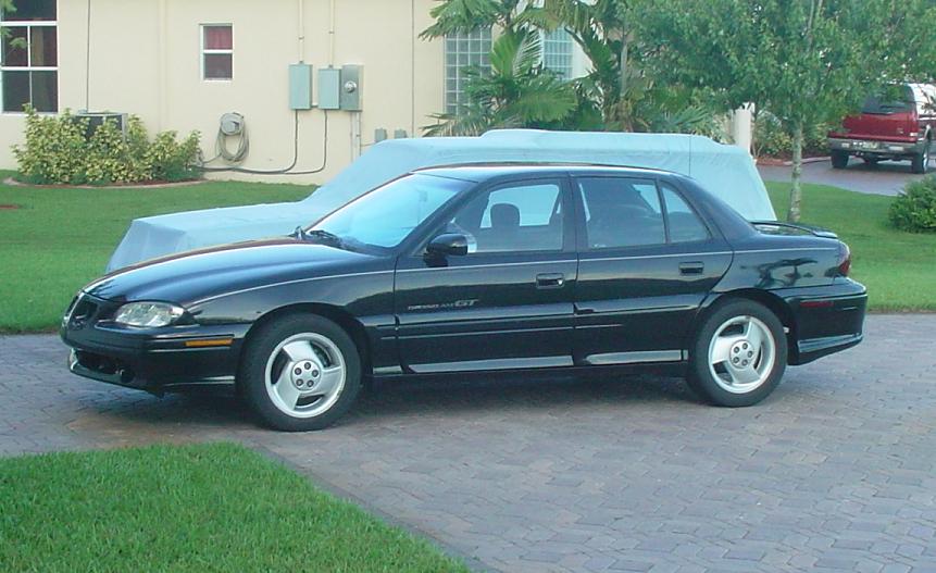

I had a 1997 Pontiac Grand Am GT... I LOVED that car.
It had a 2.4L Twin Cam engine with a 4T60E in it. It was a decent car, actually pretty damned quick too for being a 4 cyl sedan.
Anyway... it suddenly started driving really poorly. No matter what I did, I could not get it to run properly. I replaced the fuel pump, replaced the timing chain, all the ignition coils, you name it.
I ended up selling it to someone for $3k (as it looked there). The guy spent another grand trying to figure out what the problem was. He finally pulled the motor and was going to completely rebuild it... and then discovered the catalytic converter had melted and was blocking the exhaust.
Both myself, and the next owner, had spent thousands, needlessly... because of a stupid catalytic converter.
When I sold it to him, I asked him to tell me what was wrong with it when he found out... we both couldn't believe it. Anyway, he reinstalled the engine since it didn't need anything, bought a new cat, and had it back on the road the next day.
