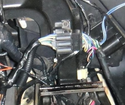

No, it should work. The original subwoofer is meant to go inline of the factory radio... between the factory wiring harness for the speakers, and the radio itself. This is the subwoofer wiring...
The adaptor screws into the middle post behind the dash.
