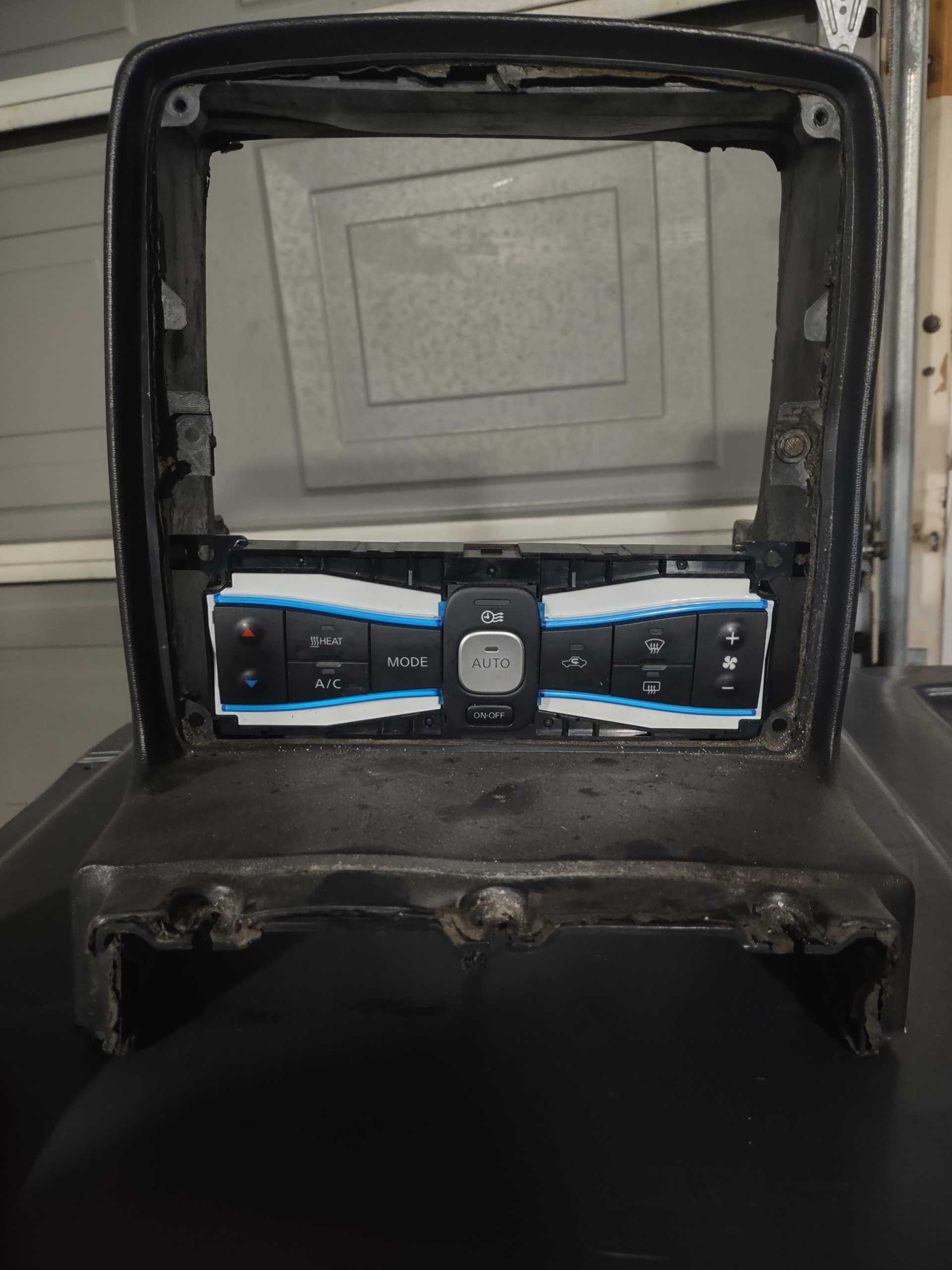

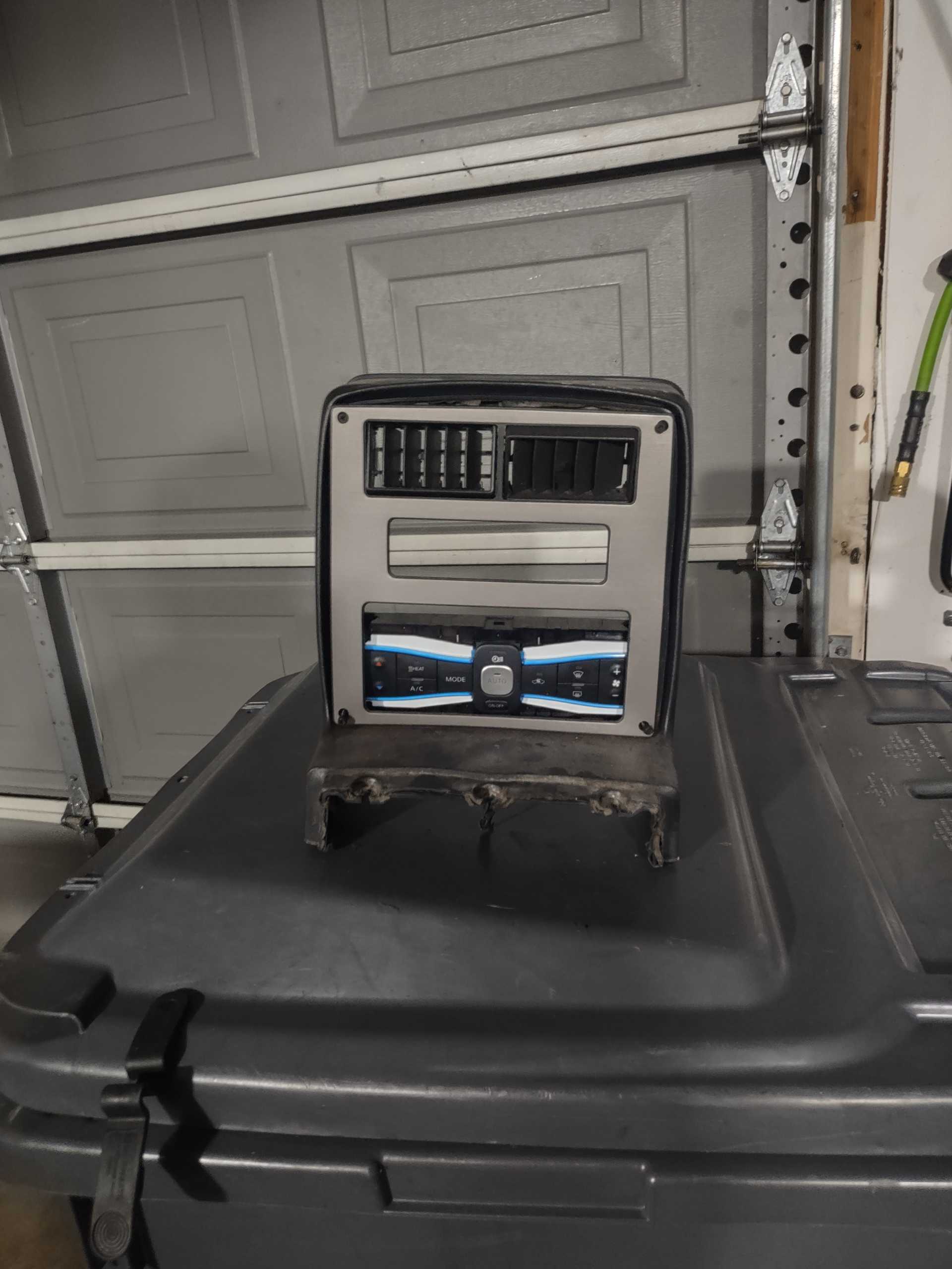

I'm starting on an ambitious project to update the HVAC system in the Fiero.
It's a doozy: I will need to change the blower motor, HVAC control, evaporator, accumulator/dryer and lines.
Reason: I'll be using an electric heat pump compressor, which is already installed. The system has a three-way valve able to change the flow where It will have access to both cooling and heating.
I'll be deleting the heater core from use as it's no longer needed. I can keep the condenser on the Fiero, which is probably the only thing in the system that will be native to the vehicle.

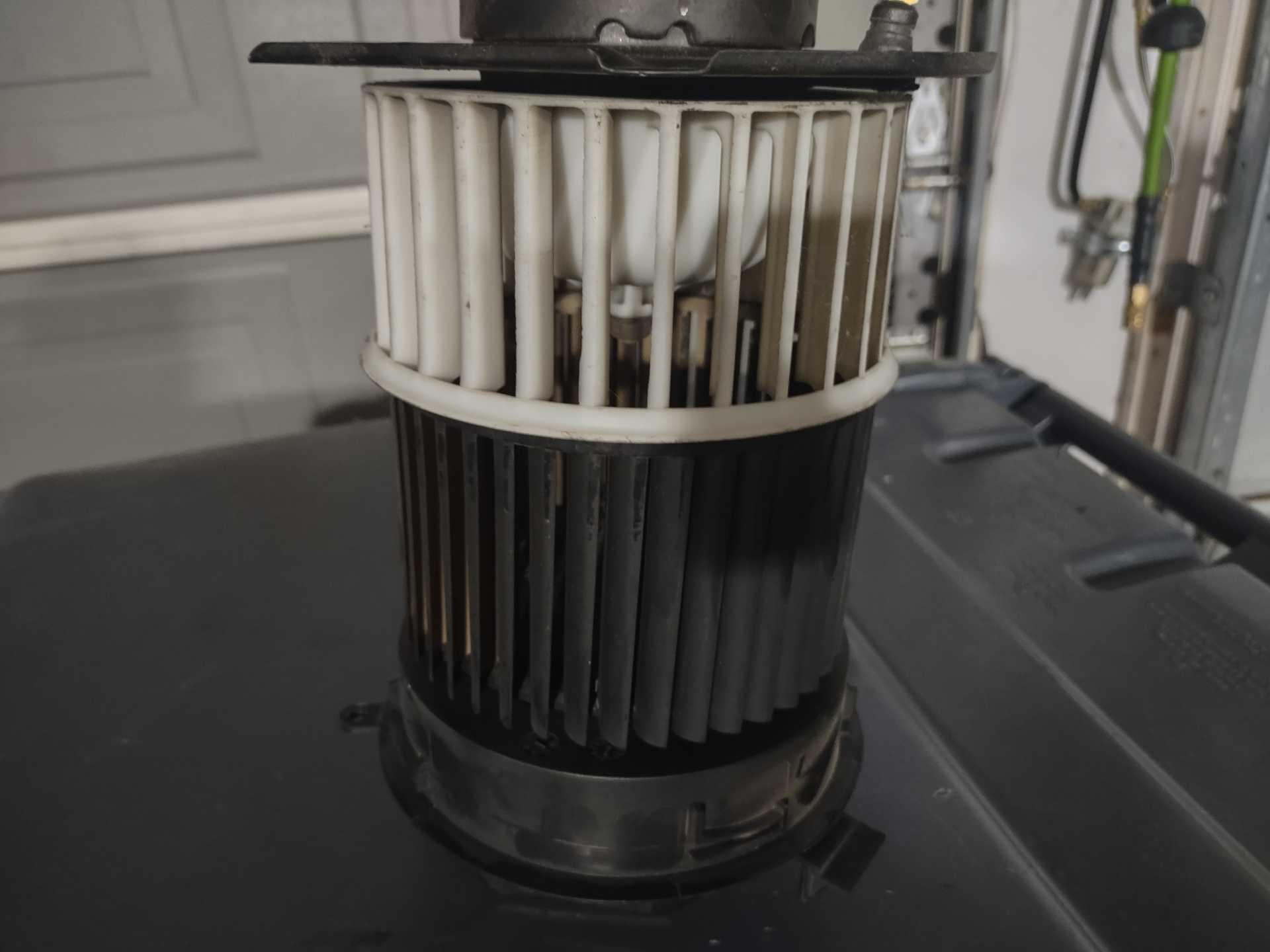

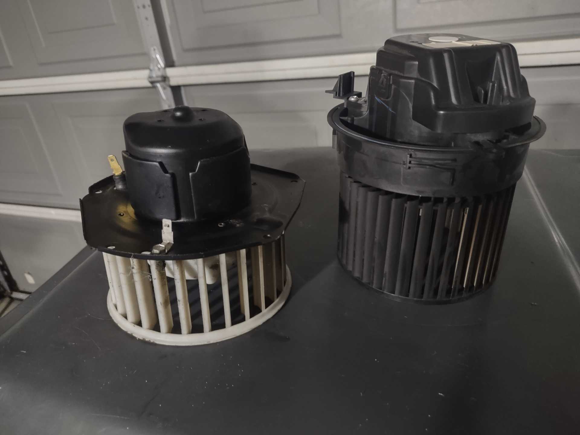

The good? I have everything I need from a donor vehicle. I'll figure out the AC lines in all, so that's the least of my worry. The HVAC control is a perfect width to fit. The blower fan isn't far off to the point that I could put the Fiero's squirrel cage on the new blower motor.
I cannot use the existing Fiero HVAC control panel as the donor HVAC control is CANBUS and controls the compressor and the switching valves, and also the blower motor which is controlled by PWM.
The bad: Probably trying to figure out or beg someone to help with a 3D printed stereo HVAC bezel cover for this. My 3D design and print skills are quite sorry.
