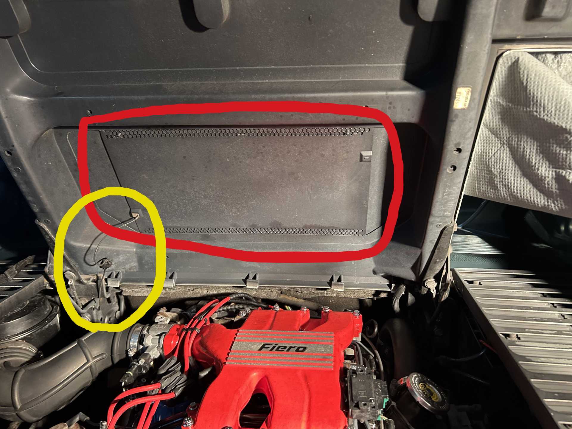

Recently, my radio began to squeal while the engine was running. (It’s a GM Monsoon radio from a 1994 Pontiac Grand Prix. No external amp and no premium sound base reflex speaker.). The squeal would get louder as the RPMs increased and would quieten when the RPMs dropped. While chasing the problem, I noticed the wire connecting the metal shield in the trunk lid over the engine was broken. When I repaired the wire, the squealing went away. I’m not saying this is your problem but it may be worth a look.

Hmm?? Thanx for the feedback. Curious, because I do not have a shield. Hope that's not it, because in my application, there is no place for one.
I think Mike is onto something.
Most of us don't follow who's done what to their Fieros, and you appear to have one (I looked it up) with a heavily modified body. Your decklid is not factory, which explains why you have no shield. Pontiac put a shield in the OEM decklid for a reason... to cut down on RFI noise. You may need to explore other options.

I think making a shield would be simple. It appears to be just a 1mm steel plate coving the engine bay. The wire is small gauge and appears to be grounded to the frame through the left hinge. (I’ll confirm that this afternoon.)

This is the picture of the RF Shielding that I mentioned. The shield is circled in red. The jumper is circled in yellow.
Thanx Mike and thanx for the pic. I do know what it is, it's just a little more difficult to install on my car.
It also squeals without the ignition operating, so it's not noise from the back.
