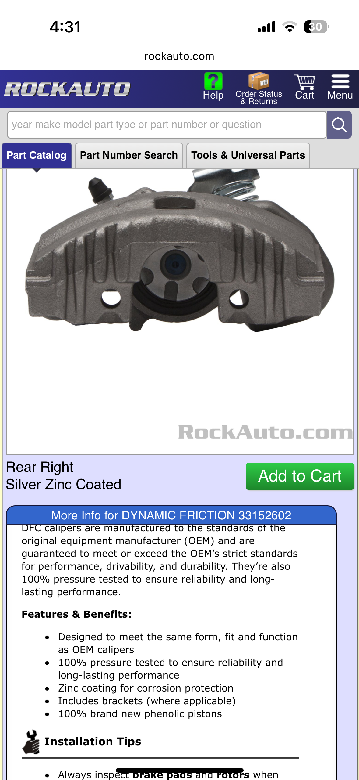

So I noticed you can buy New calipers on Rock for the 84/87 fiero.
Has anyone used them ?
fierojunky
Posts: 431
From: Pittsburgh, PA, USA
Report this Post05-06-2025 11:53 AM Click Here to See the Profile for fierojunkySend a Private Message to fierojunkyEdit/Delete MessageReply w/QuoteDirect Link to This Post
I was looking at them the other night. It looked like they had plastic pistons. I’m interested in other people’s experience as well.

Aren't the originals plastic, the ones gm originally installed? Sure metals better, but it's not "cheap" or "junky" if that's the original design.
Edit, yeah pre 88 front ones are plastic, rear are metal, have to be for the screw parking brake mechanism, I would imagine the replacements are also metal. The plastic is cheaper to make, and insulates the brake fluid from the heat of braking.

How about that, I had no idea...
https://safebraking.com/tec...ns-phenolic-plastic/

i think they fit one other car.rockauto has a list.my rear calipers came from rockauto but last year.

Last fall I bought rear calipers from Amazon and was worried they would be junk. Wrong they seem to be high quality and work perfect. They even had the original GM part number on them. they aren't rebuild they are new and I believe they are built by GM in China. GM has several plants in China.

Just for reference new rear Fiero calipers 84-87 are now being sold on eBay and Amazon. I ordered a set ($123.00) and have yet to install them but they look well made. They are Chinese of course but at least we have replacements available..
