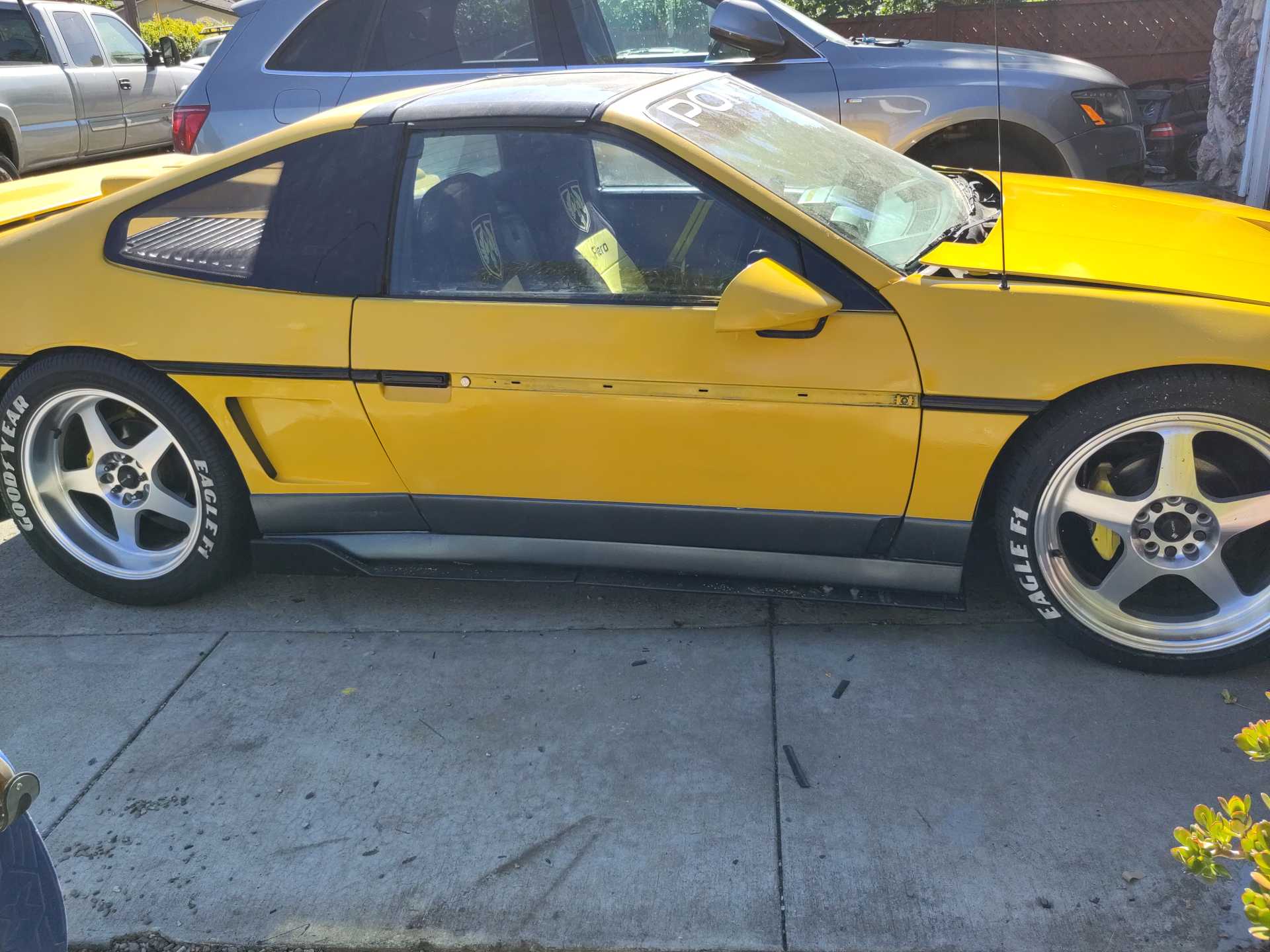

Thank you Dennis but im just a fluffer lol. I like that some people dont like the car, I make so many new ones do! Bumblebee is getting love from everywhere, prolly put about 50 miles on it now. Still havent smogged it, theres a new guy at the place I usually go and didnt get a good vibe so drove back home. Speaking of fiero haters...... Doing an electrical job for one of my kid classmates parents(new customer), and hes got a new vette in the garage I keep having to squeeze by. Finally he address the elephant in the room, putting out his hands and saying what do you think. I smiled, nodded, and said, "nice, the new fiero." At which point he starts going oh oh oh and is about to say something im not gonna like lol, pauses, catches himself(gears churning), and asks, " Wait you dont own a fiero do you?" To which I reply with a semi disgusted look on my face and shaking my head, " no..................... I own 2!.................................................................and a kit car!" lol He pauses as hes think about what to say(havent discussed price yet for all these electrical jobs im doing), and the best thing he can say is, " You know those werent great cars right?" I immediately reply, well they never put an engine in it. And when they did , guess what it blew the doors completely off of. He argued a bit more but saw he definitely wasnt winning this one, tried to change it up to chatting about the vette. I hate vettes, the first 3 gens are cool.
Any who, I swapped the wheels over, got some gauges. The cars temp gauge works perfect but I want a second opinion so I made something to hold the temp sending unit of the new gauge and plumbed it in to those hoses that take coolant to the throttle body. Yeah those two lol.
Everything working good and got a momo for the lolo. 3d printed some dashtrays for the car too, luv that thing!

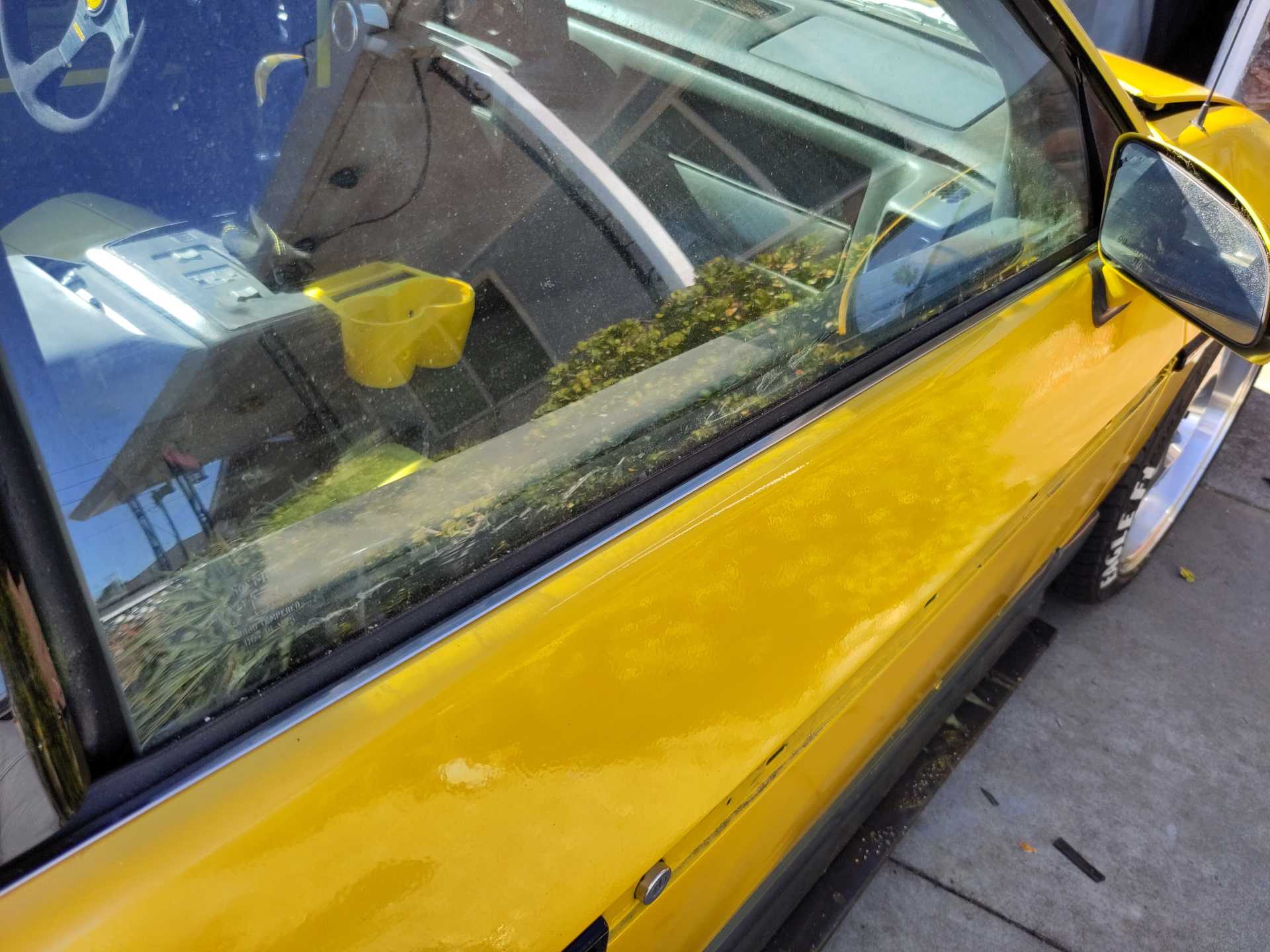

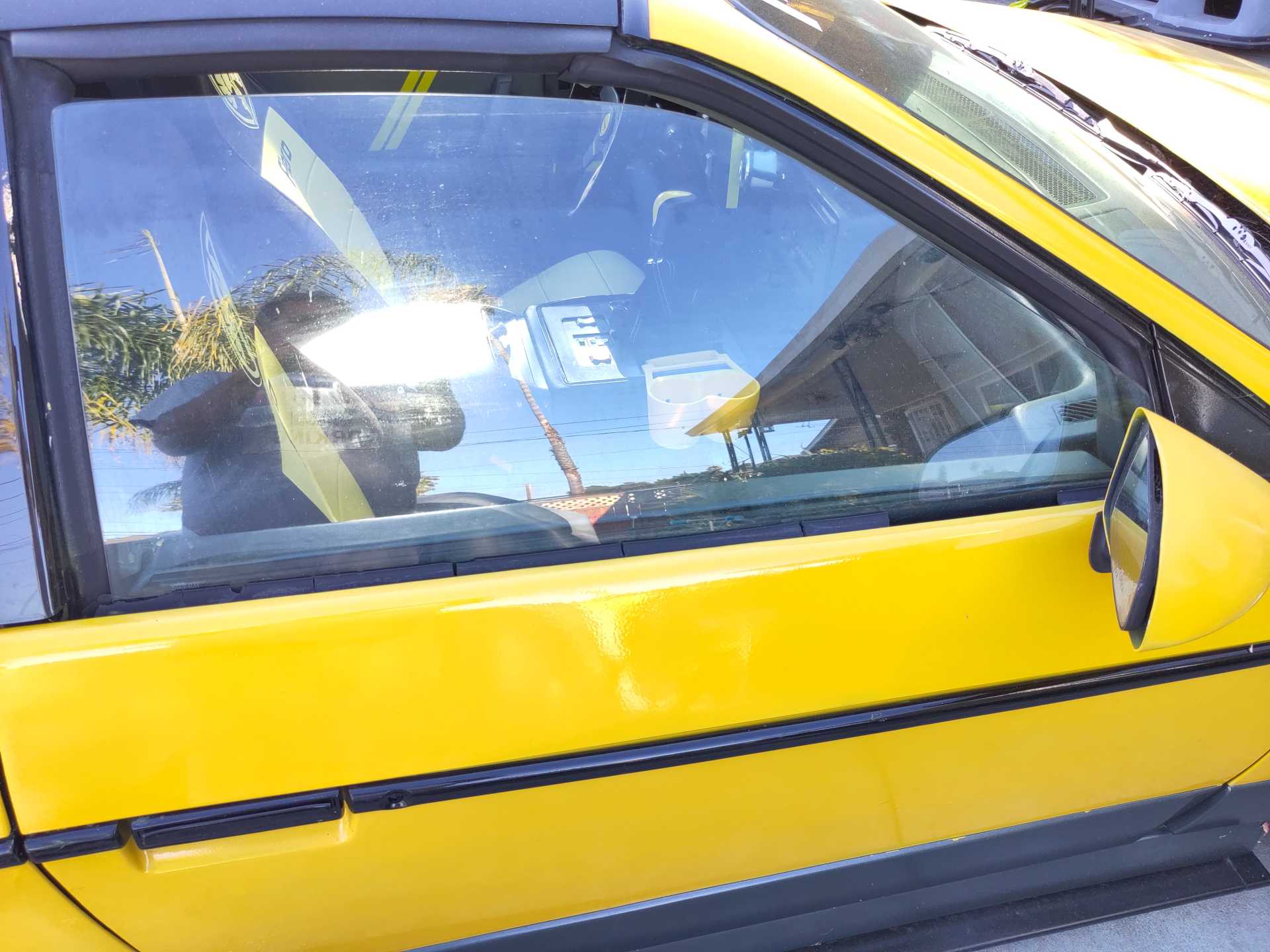

Report this Post07-08-2025 09:02 PM Click Here to See the Profile for shemdoggSend a Private Message to shemdoggEdit/Delete MessageReply w/QuoteDirect Link to This Post
Just read this thread again, good times good times. Been driving the car often, my kid really loves it. Picked him up in it w the tops off for his last day of 1st grade and he was proud. Tons of thumbs ups and people going nuts when we drive, he likes the power. Car runs perfect too! Just the jingle of the nonexistent sway bar bushings I have but havent changed yet. Exhaust is crazy quiet and motor purrs. Put some dew wipes on and changed the door locks. Had some bubbles on the hood from a leftover epoxy primer experiment that failed, so shot those today and a few nicks the cars had.
Ran the new ones the entire length of the door and I love it

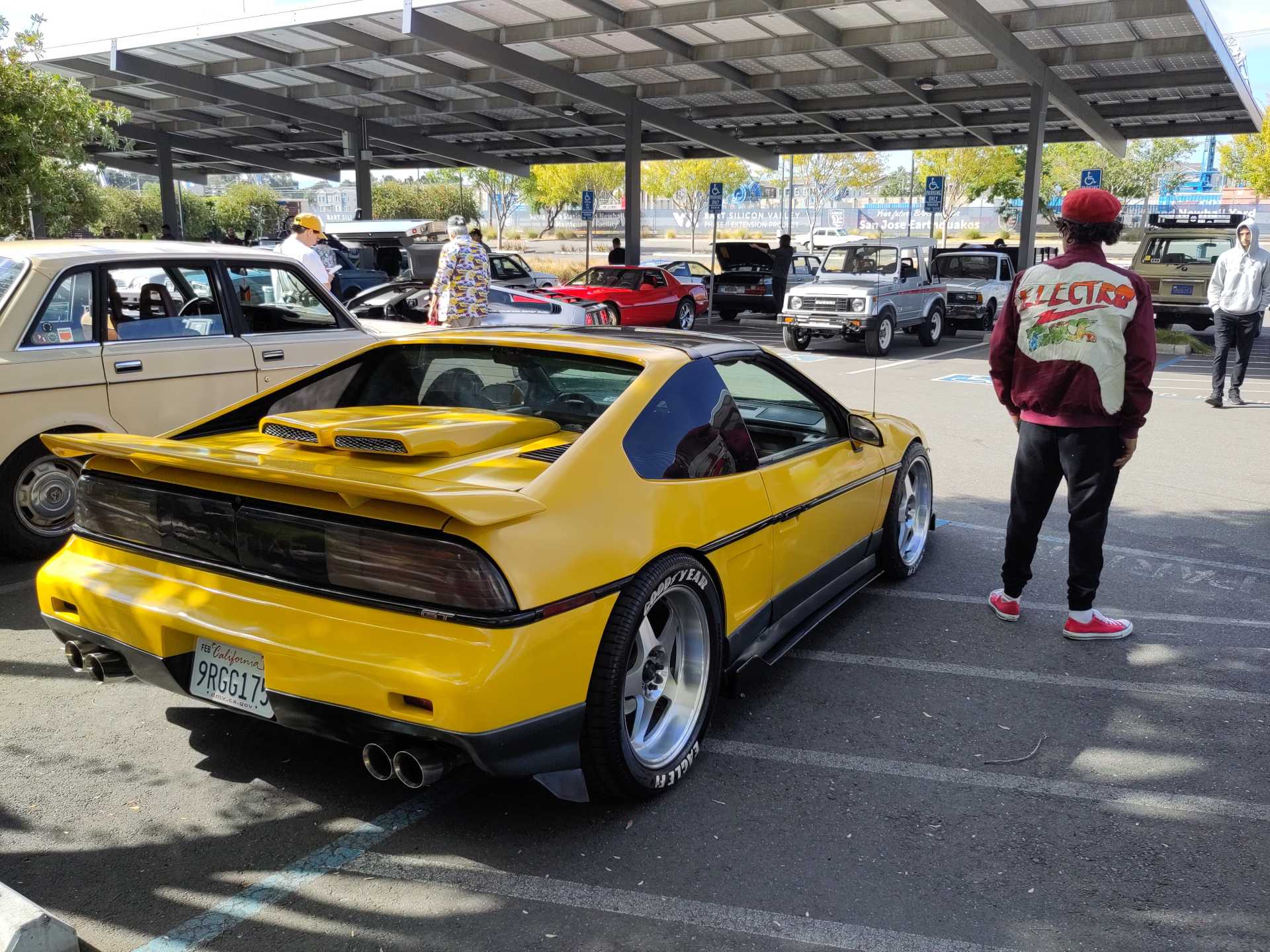

Report this Post07-27-2025 01:59 PM Click Here to See the Profile for shemdoggSend a Private Message to shemdoggEdit/Delete MessageReply w/QuoteDirect Link to This Post
Matt the fiero bug is sated for me now, I have 2.5 fieros lol. Earlier this year a cop came by to talk shop and is big on 80s vehicles, and toyotas especially, told me a guy across and down the street has a fiero in his driveway. He told me about an 80/90s car show called radwood, I went to it yesterdayw a buddy dressed as a bboy. I was the only fiero there but everyone took pictures and it was giant smiles all around. Really no haters, it was solid love all day for the fiero and my costume. I resprayed one rocker and the front air dam the day before, didnt have time in the morning to get the driving lights in. Lotsa cool cars and plenty of shade
This guy had a 2 rotor display run by an electric motor on the back of his rx7
Never thought id see these wheels in real life. Now that I have, still hate em lol
Plenty of more pics, definitely going next year. Hopefully in the fubabbi
