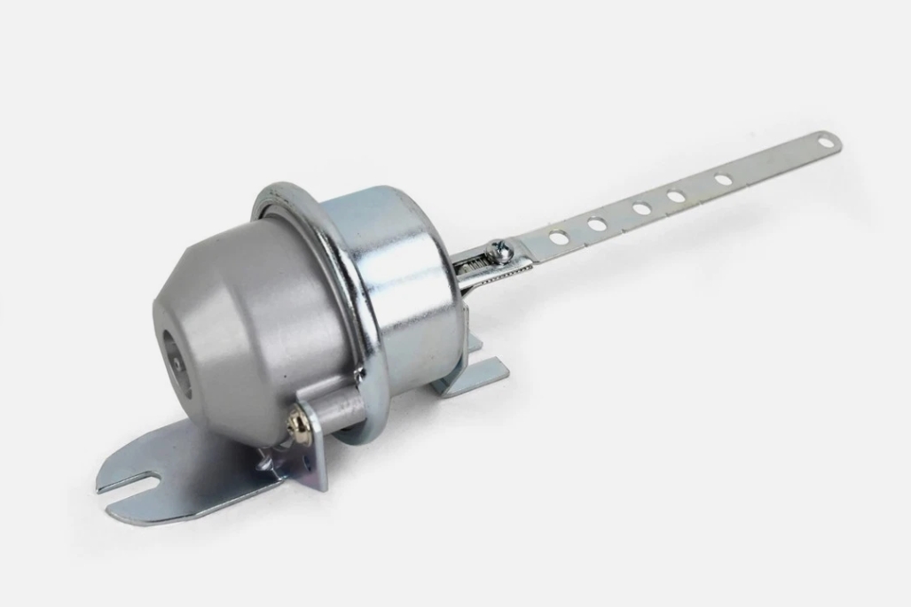

Yes... soo... I don't know how much higher flowing. I realize the Fiero doesn't really have a breathing problem from the factory side scoop (at least the stock 2.8 V6 doesn't according to several tests). But I ran across this air cleaner lid at the junkyard several years ago. For the life of me, I absolutely cannot remember what car it came from... it was like a Buick or some such.
Anyway, it is the identical size of the Fiero's V6 air cleaner canister (I remember test-fitting it). I don't have a V6 Fiero in front of me right now to see, but I'm almost 100% sure that the lid is exposing the inside of the air filter, which is where we want the air to come from.
I picked it up just in case as I thought it might be a kind of cool thing to use if someone wanted to install some sort of vacuum operated vent-area additional intake. You'd simply need a threaded dowel that was long enough (just a little more than an inch longer than the factory one). Obviously, I know there's hot air in there, but I'm assuming if someone were to use this, they'd likely have ceramic coated headers or header wrap, etc.
I'd imagine something like what I had in my 82 TransAm... you floor it, and with the increased vacuum coming from the engine, it flipped open a cowl flap allowing additional cooler air from the top of the air cleaner.
Posting here in case anyone finds it interesting...

Cool, one thing though, I think it would be closed with vacuum, open with less vacuum, as when you floor it, manifold pressure gets closer to ambient and vacuum forms when the throttle closes.
You know, I honestly don't remember now. I'm not going to argue with you... I was a software engineer before I became a person that sends e-mails all day, so you're probably right. But I seem to recall in my 82 TransAm that the flap was closed when parked... intentionally because it would prevent rain from getting in (it was basically a conduit directly into the air cleaner, with a small run-off for rain). When you'd floor it, it would open up. But my 81 TransAm, which had a shaker hood, that actually had an electronically controlled solenoid. But that **** never ran so I couldn't tell you... hahaha... I think there was a momentary switch on the carburetor that engaged along with the secondaries.

But yeah, it would obviously need to be cool air, which if you're driving probably wouldn't be too bad. I'd love to figure out what the temperature is of the air passing through the decklid vents at speed. Worthless for a 2.8, but if you were trying to keep a stock look, and had something on top that looked relatively stock to allow a little bit of extra air in... I'd be interested to know if it does anything, or if it's still bottlenecked even by a larger throttle body (assuming DAWG mod and everything else, on a 3.4).
It would likely end up being one of those $500 for 1 hp kind of solutions.

It's not a high flowing Air cleaner cover, it's from a FWD application that has a hood intake design. 89-94 Cavalier Z24's have a lid with the center completely open. This style is no benefit to a Fiero, probably a detriment as it would certainly suck in that baking hot air in the engine bay.
Shoot, you just looked at the pictures and the title didn't you, haha...
I said if you can get past the hot air (fabricate something) and use it with the stock air canister (for which it fits), you could get air coming from both the top and the bottom of the filter canister.

If wanted "more air" w/ OE Fiero V6 air cleaner... RD make/made a mod kit to open up the section holding the cover bolt. I doubt actually helps w/ OE & most swap engines.
Worse, let all kind of crap dropping into the filter from air vent above it. IF still have Fiero box bottom etc. then might plug that in time from crap from above.
Many fools rip out the wall in the separator box to "get more air" only causes problems including destroy V6 air filter driving on wet roads.
see https://www.fiero.nl/forum/.../HTML/144683.html#p3 How intake air muffler works...
Most Air filters Hate getting wet & polluted water close the "pores" & stay close after drying. Even a new clean filter will restrict air flow after getting wet.

Unless you are converted to a mass air system these changes amount to little. The factory closed loop really does not adjust yo more air or colder air.
Also the air coming in is pretty cool and that is why the intake is in a cooler part of the car on the side.

To everyone:
1 - I know a factory 2.8 Fiero will not see any benefit.
2 - I also know the air under the decklid is hot
3 - Thank you

I found this air intake canister on eBay that came from a 1984-1989 V6 Pontiac Firebird / Camaro:
Now, I don't plan to use the air cleaner assembly, but I do plan to use that "hood" that's sitting on top of it. Not sure exactly how I plan to do this, but my goal would be to use that hood, along with the air cleaner lid (image posted in the first post).
Granted, I'm well aware that the stock air intake is adequate for the stock V6... and other than removing the water separator, there's not a lot of benefit. Of course, I'll be going with a 3.4 and larger TB and bored intake. I like performance modifications that LOOK totally OEM. I don't think I'll gain millions of horsepower, but maybe 1 or 2 at peak acceleration with my 3.4 when it's built. But we'll see...
I have about a dozen 1982-1984 Pontiac TransAm vacuum controlled louver systems that I can butcher. Basically... works similar to a ThermAC valve, that when a decrease of vacuum occurs, it initiates a vacuum solenoid which flips open the flap.
Personally, I think this would be pretty cool... just not sure how it all connects, but I assume this plastic piece merely snaps on top of the canister... but we'll see.

Ok, revising this thread because I'm starting to work on this again. I got another air canister... haven't received it yet, but hoping / assuming it's the same diameter as the canister lid on the top of the Firebird V6 air cleaner. From what I can tell, the Firebird actually has two air inlets on the air cleaner... one (which comes in from the bottom like the Fiero V6's air cleaner), and the black plastic "hood" on the top.
And then, it connects in a similar way to how the Fiero V6's throttle body connects, with a big tube off the side. The Fiero's V6 canister "appears" taller, but I won't know until I get it in the mail.
When I look at, for example, the air intake on the side of the Fiero's air intake panel, the diameter of the inlet (from the water separator), is more or less the same diameter as the throttle body (probably a little bit bigger). I'm not sure there's any huge difference going to be made here, but I like the idea of more air at wide open throttle, than what is currently available to the engine. I'll have a 3.4 V6/60 at that point, and my hope is to keep it looking relatively stock looking... but upgrading with things that are OEM looking. I've got a bored TB, and I'll have the DAWG mod done.
As 85 Fiero GT said above, at WOT, there is less vacuum, and during idle, there is more vacuum. So, I'll want to build a little flap that gets installed behind that air cleaner cover "awning" that's closed during idle, and open during WOT.
I found this little A/C vacuum solenoid, which... I don't know which direction it works. But I can either have it push or pull a spring-loaded flap. So that's something I'm looking to do.
I think it'll look decent under the engine vent, and I don't think it's really going to cause an issue with rain. To be honest, I doubt I'll ever drive the car in the rain anyway since we're in 2025, and it's a 38 year old car.
