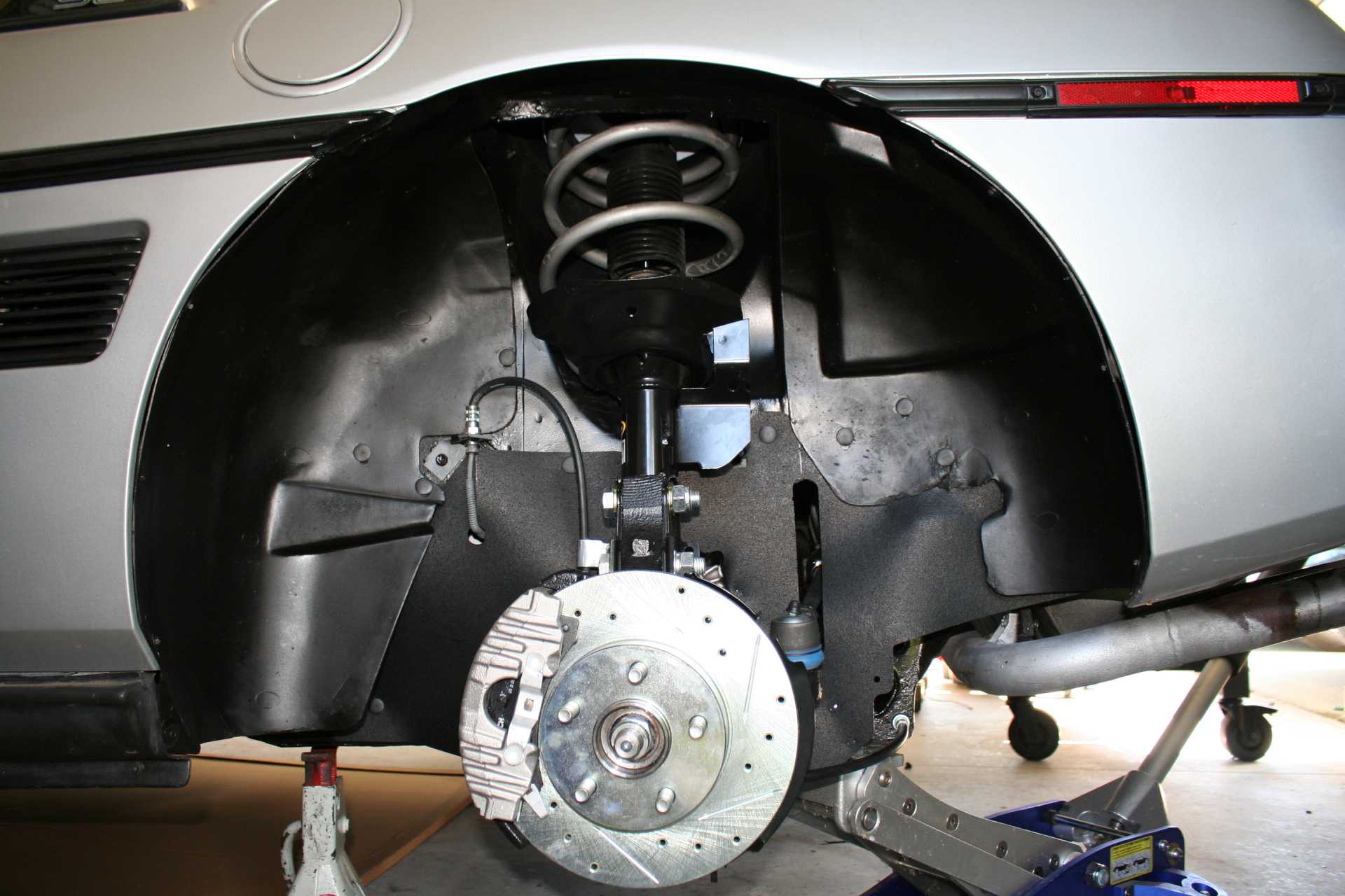

Just a quick update... figured this post was as good as any to continue the "random" posts regarding the overall progress. We got the engine fully in yesterday:
She's about 8 videos behind, but I think she's going to end up condensing this into 4 videos since she's so far behind. The next one will be finishing up the top end of the engine, then the interview with cliff and cars of the Netherlands, then building out the engine and transmission on the stand, and then prepping the engine bay and installing it in the car. Not sure yet what she'll do.
Just some quick points... we removed the rear quarter, repaired all the rust we saw. There were a couple of small holes in the rear-most part of the upper frame-rails, but I was unable to get replacement metal, so we ground it down to bare metal, and Por-15'ed the entire thing. She replaced, restored, and renovated basically everything. Re-wrapped all the wiring harnesses, replaced the tree clips, you name it. She also installed new insulation matting on the rear firewall, and a bunch of other stuff.
When we removed the quarter "shell," one of the bolts broke free in the fiberglass, so I had to use a sawzall to cut it. It was the driver's side screw. There was too much gunk on the threads, and we were unable to get it to spin before it spun free inside the fiberglass. She pressure washed the entire thing, and I was able to tack-weld the cut side of the bolt (after cleaning the threads, etc.) back to the top part of it on the fiberglass roof panel. I then used a grinder to smooth out most of it so it would fit in the hole when re-installed, and I used a bunch of JB Weld to re-assert the bolt so it didn't spin freely within the fiberglass. She let me do all of this, but was nervous... I'm actually kind of impressed I was able to do it, haha.
Everything went back awesome. She Por-15'ed the entire roof and B-pillars when it was off, and installed all new foam insulation (outdoor / water proof) before we installed it. She used RTV sealant on the mating surfaces to prevent any leaks as well. It came out really well.
Engine went in quite easily... she did a good job with this, and I monitored to make sure she didn't get under the car despite the desire to do so several times because it would be "easier." The passenger side rear cage nut broke free... unfortunately. But I have insanely long fingers, and I was able to get it out through one of the existing slots in the side. I don't know if there's supposed to be a "cage" in there, but there was no cage, just a diamond shaped plate with a threaded bung attached to it that was loose in there. I had to help her with this side, but I slid it back while trying to thread in the bolt, and once I got it threaded, I used a long screw driver to hold it in place while I used the impact gun. Everything else went in very smoothly... so she's really excited.
Next, we're going to rebuild the entire rear suspension (have all the parts ready to go, everything is painted... it's just assembling Legos at this point). And that'll be the video that comes after that.
EDIT: Nothing in the picture above is hooked up. The engine is literally installed in the car, and the only thing hooked up are the four cradle bolts, and a screw driver going through the frame to dog-bone hole. She'll do that over the next few days... but she accidentally threaded the water pump neck with an M9/1.25 instead of an M8/1.25 tap... so we had to special order two M9 bolts which won't come until early October... lol.

For example, just the rear wheel wells... everything has been cleaned, sanded, painted, or outright replaced. Nothing too fancy... she did install cross-drilled and slotted rotors (since they were not too much more than stock), but everything has been replaced... hah...
She'll drive it around her Junior and Senior year of high school, and then when she goes off to college, we'll get her something more responsible like a Civic or something (I dunno)... and then I'll just keep this car for her and when she has a place of her own, she'll get it back.
