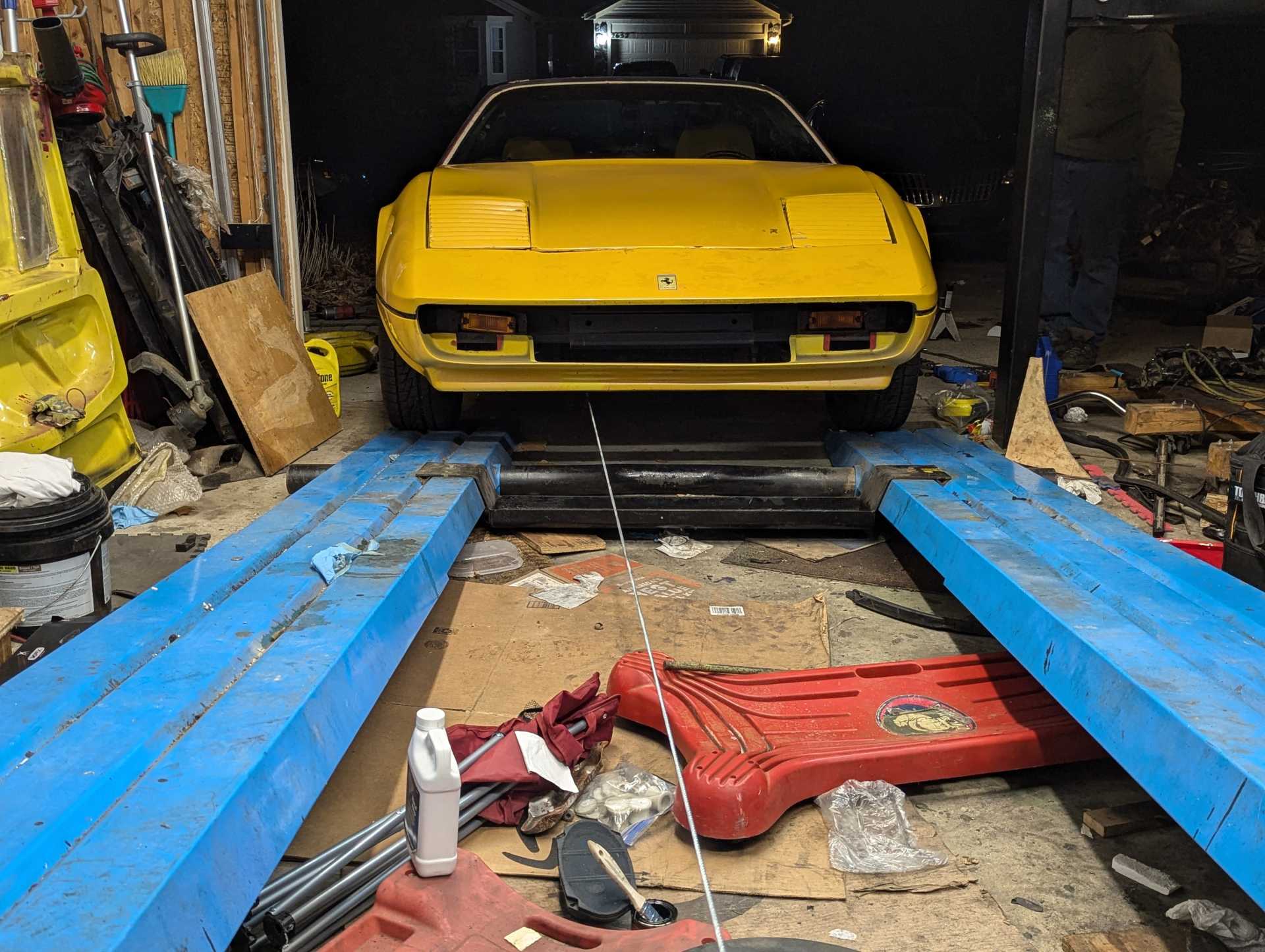

So basically I bought an unknown body with many many layers of paint. It has MERA taillights, oddly, but I have no idea who made the body, Artero dash (yeah the ugly dash is the pisa artero dash), wheels, and a bunch of spare parts of very questionable quality. But now I have an extra cradle to build the new engine on, I think.
Reality is I don't want to pay $14 for a combo at Arby's either but prices aren't what they used to be.
When I bought this, there were three other options. Two I could afford, one no way . One body for $6500 and 10 hours driving, that also needed a new chassis because it was hit, and another for $4000 in Cali that was non running and a mess. That owner wasn't exactly being nice at all, and also refused to ship/sell it to Michigan. It's likely to have needed a ton of work as well, so I got the best I could find at the time and arguably the cheapest. I wasn't about to spend $15,000 for the third, beautiful, compete one because that is no fun and I'd have been bored of it within hours.. also it was red, and I really like these in yellow.
But yeah. Today.. goodbye old, nasty oversprayed frame with mold, three piece rear window and likely tetanus
It looks as though smartaxle purchased basically a Ferrari style fiberglass body. It was obviously worth the $5,000 to him but as they say beauty is in the eye of the beholder. IMO, this vehicle had more problems than most of us thought. I'm certain that the end product will look great but perhaps after 100 hours of labor. Its great that this replicar was saved and I look forward to seeing the final result.

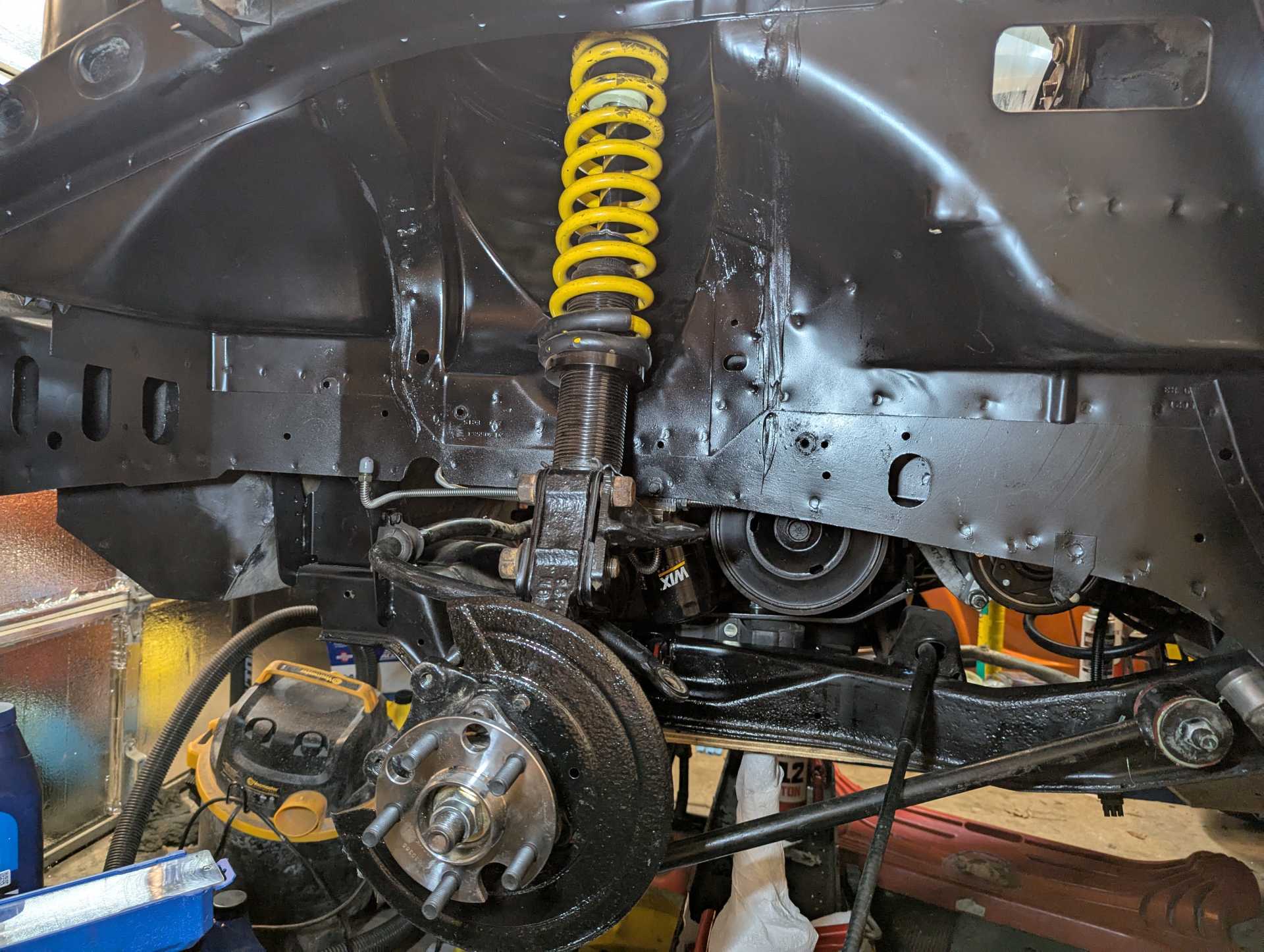

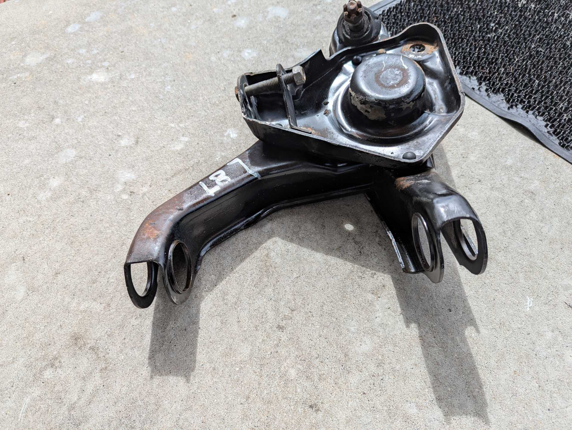

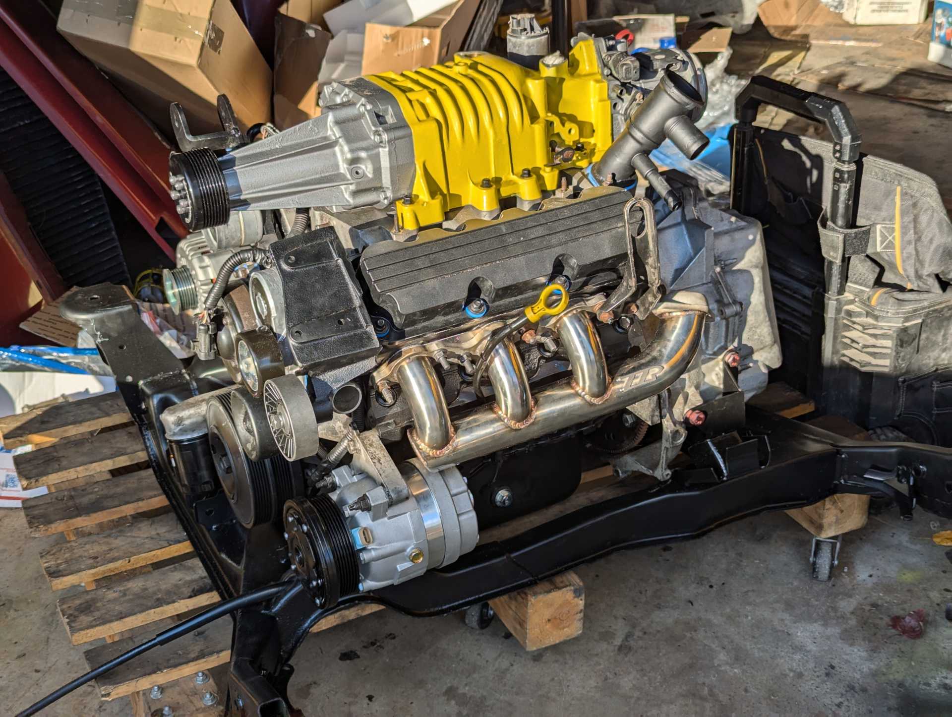

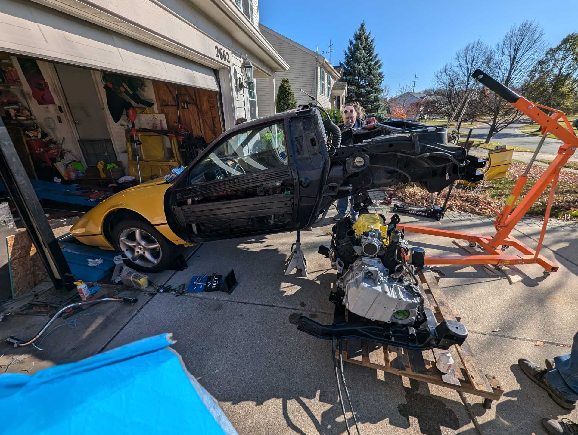

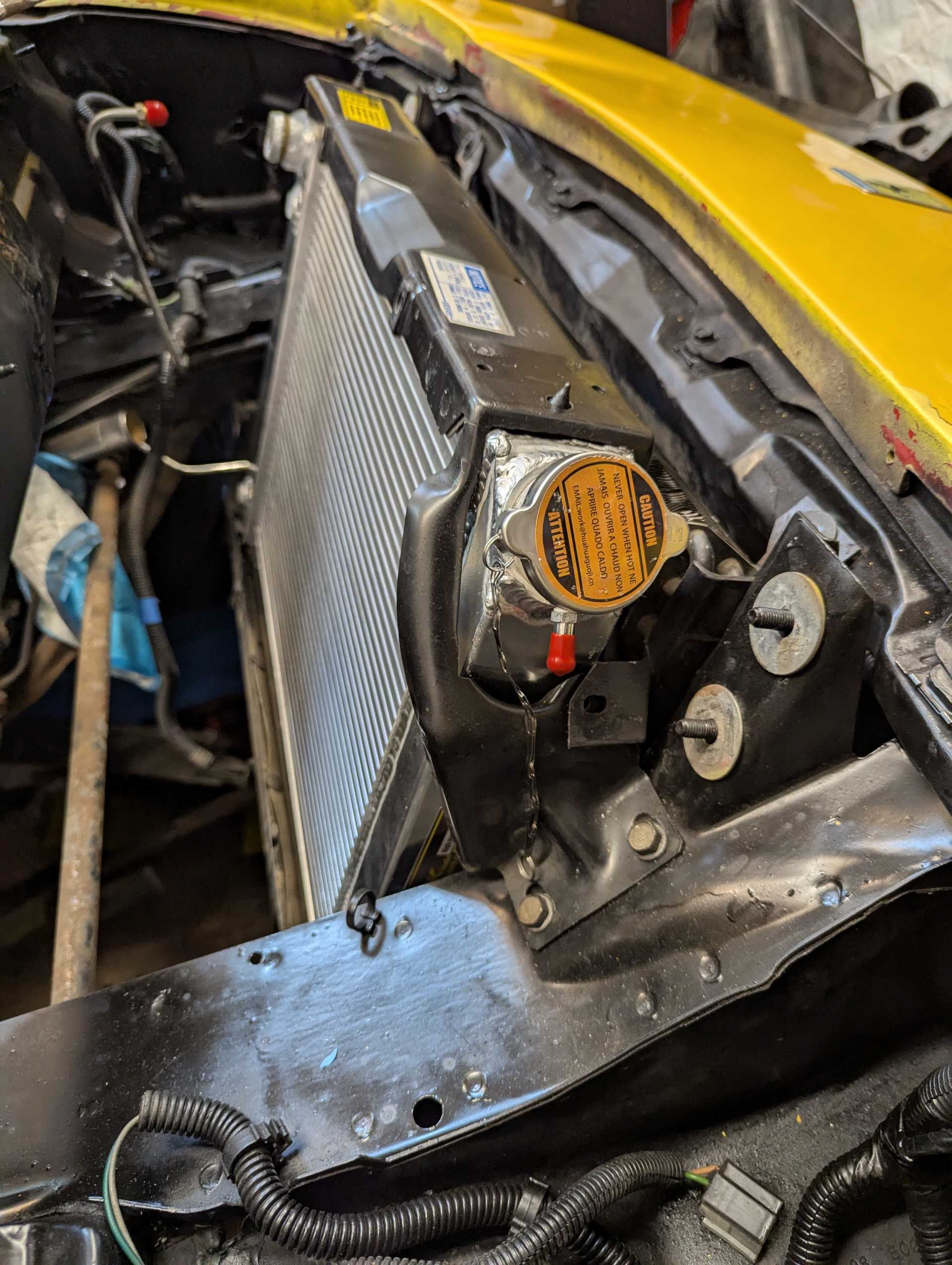

Report this Post04-27-2025 09:28 PM Click Here to See the Profile for smartaxelClick Here to visit smartaxel's HomePageSend a Private Message to smartaxelEdit/Delete MessageReply w/QuoteDirect Link to This Post
Its been a long while. I had surgery so it was stored for a bit and I have been working slowly on it since.. its nowhere being complete yet. I got the (dumb) idea that while its an 1984 chassis, I wanted to upgrade it to 87-88 spec and get rid of anything that was an 84 weakness, so I added a C500 near the battery, swapped out all the 84 wire harnesses to 87,88., swapped out larger gas tank, installed 88 undercar coolant and AC hoses, swapped out smaller 84 brake vacuum line and booster, converted to auto trans, swapped in tan interior, Meyer double DIN radio skeleton, and its getting a 3800. Also cradle swapped to an 88 with rear coil overs and it getting front Grand Am brakes and new brake and trans lines. Also swapping out front springs and lower control arms to 87 GT. The body is still off, 3800 and cradle is in, but the fuel, trans lines arent hooked up yet. I wanted the engine startable by the end of this month but life gets in the way. I went down the path of upgrading "everything"and each thing ends up taking forever or needing me to locate some part I cant find locally.. For example, I had to find an 88 cradle and suspension, sway bar, get the kit from James Brown, then get it blasted and epoxied. Needed to find longer bolts for 88 sway bar link brackets. It wont be a show car at all, just a daily restore, but I'm slow and anal about getting the right parts. Had to locate rust free control arms and rebuild, find good trans etc.. Also upgraded to power locks and windows, larger radiator, new 88 headlight motors, new radiator fan motor, Its plain slow process.
Originally posted by Patrick:
Smartaxel, it's been awhile. Any progress reports?
[This message has been edited by smartaxel (edited 04-27-2025).]
smartaxel
Posts: 2826
From: Michigan
Feedback score:    (15)
Total ratings: 83
Report this Post04-27-2025 09:53 PM Click Here to See the Profile for smartaxelClick Here to visit smartaxel's HomePageSend a Private Message to smartaxelEdit/Delete MessageReply w/QuoteDirect Link to This Post
smartaxel
2826 posts
Member since Feb 2002
Slow but steady I suppose... Still have to add 87 auxiliary gas expansion tank. Chassis is very clean though for 84 Michigan.
