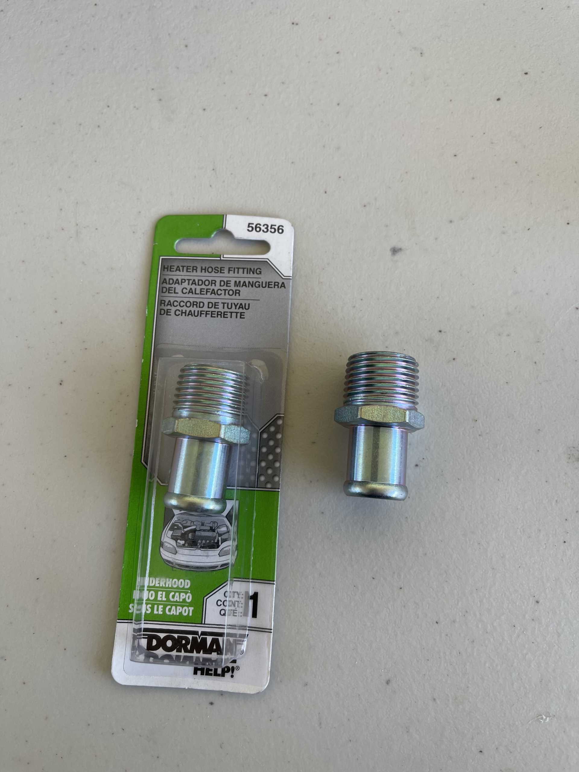

"Small" heater hose...
First get new hose. 3/4" I believe and often Non Stocked at many local stores but can order often overnight w/o shipping change. Order 2 or 3 feet min because cheap and use it in other places on Fiero. Example: Often need this to eliminate connection near F-filter just behind right rear floor on V6 and DIS Dukes. Maybe other dukes have same but their F-filters are on the engine.
Use a "Dremel" and cut off wheel to split the crimp.
Then use standard clamps w/ new hose.
GM use the crimp and more on coolant system just to save time making cars. Can easy replace many of that but not all.
See my Cave, Heater
If leaking at connector under the intake need a new connector.
Ignore Dorman etc saying the part won't fit Fiero.
I keep one in case I have to disconnect for any reason. While seems PnP often fails and leaks when reused.
Is why you try fixing other issues w/o disconnect or moving this joint.

I bought that coolant hose quick fitting for under the intake from the Fiero Store already.
I didn’t want to disconnect it in case it turned out to be a fan of worms.
The heads up on that is much appreciated that it leaks when snapping it back together .

Regarding the Heater hose that goes to that Quick connect fitting under the intake manifold….
I bought a threaded heater hose fitting that threads directly into the intake manifold, and the other end is 5/8” hose size that I can use a hose clamp on; eliminating that quick connect.
The part number is
Doorman Help 56356
Photo attached
enicho1
Posts: 37
From: Phoenix, AZ
Registered: Feb 2022
Report this Post02-27-2023 08:30 AM Click Here to See the Profile for enicho1Send a Private Message to enicho1Edit/Delete MessageReply w/QuoteDirect Link to This Post
The part number is
Doorman Help 56356
Photo attached
I installed the heater hose fitting under the intake manifold and had to recut the 5/8” hose as it was just slightly too short.
I had used the old one to copy, and then when installing the new hose, I realized the new fitting is about 1” to 1-1/2” shorter than the quick connect set up.
The next thing is since it’s such a narrow space to work in, I couldn’t get both hands in there …. One to hold the hose clamp, the other to tighten.
With patience, I was able to do it with one hand and a little socket with 1/4” drive.
I tightened the clamp just enough to get it up over the hump on the hose at the fitting, and tighten.
It was a dexterity balance using the ratchet and a finger or two to get it tightened .
I see why they used a quick connect.
I have the quick connect set up if I ever needed to change it, but for now I feel better that it won’t leak at a quick connect.
It took me 20 minutes or so after screwing in the hose fitting into the manifold to get the hose clamp tightened.
I put the hose on the intake side first, then lay down and through the wheel well, slipped 2 hose clamps and then plugged the other end of the hose on to the heater pipe.
Then the dexterity balance described above on tightening the clamp on the intake side hose.
The hose connected to the heater pipe was easy.
Just wanted to share in case anyone else decides this route.
