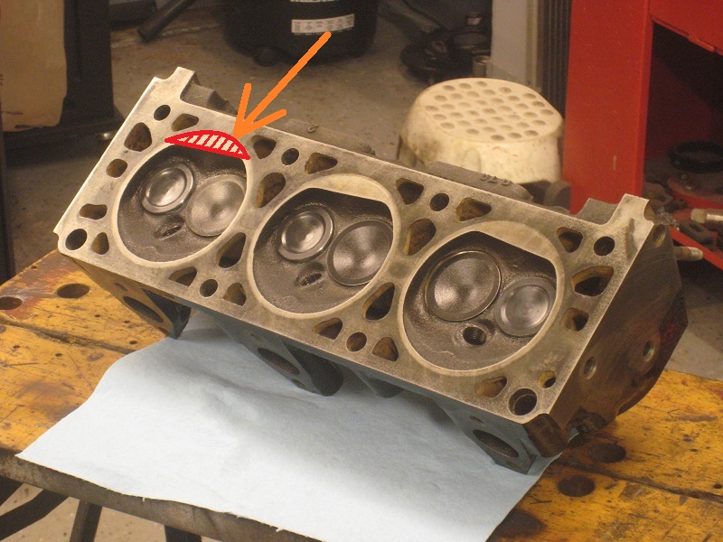

Rope can be tricky in the sense that it can get lodged between the quench zone of the head and the piston:
When the rope gets stuck there, the piston can't move up any further, but the valves are not held up. I had this issue with a 1/4" cotton rope. With a 3/8" nylon rope, I was able to make the rope method work. This was with a dished piston though; probably this is less of an issue with the stock flat-top piston.

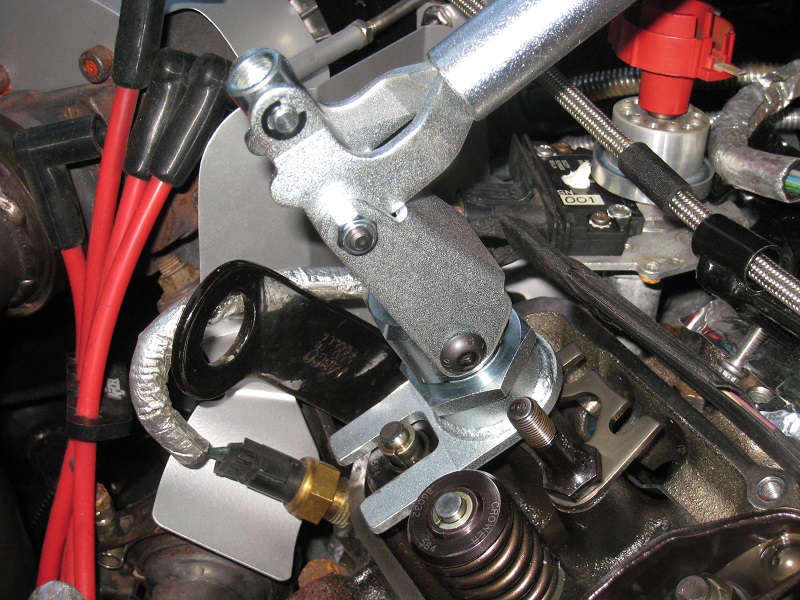

Do you have a good spring compressor?
I used this kind:
Once the spring is compressed, it holds itself hands-free.

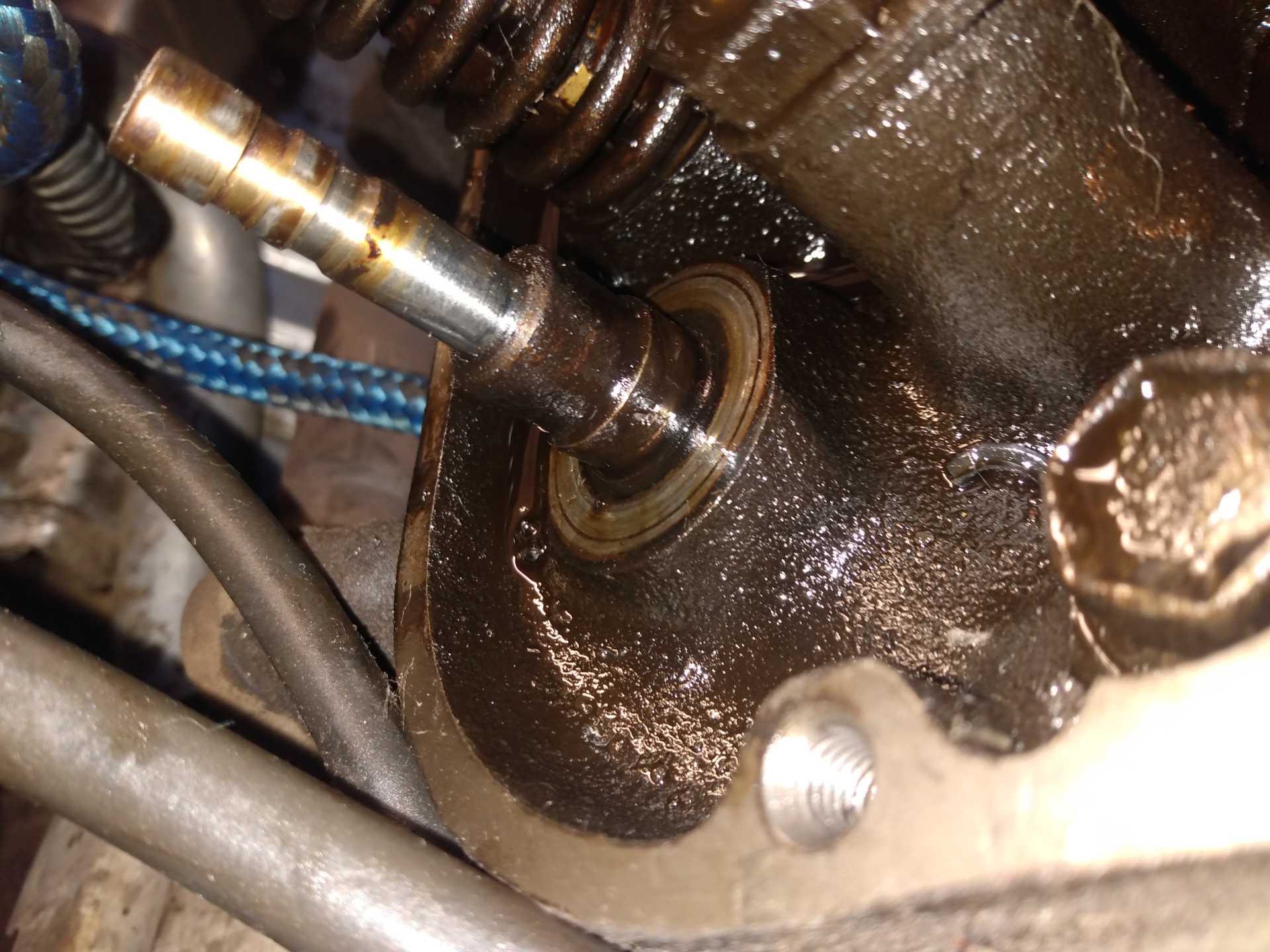

So far so good using the rope method I've got the easy side done I got to wait for some more valve seals tomorrow because I decided to do away with the o-ring and put seals on both sides the hard part for me is going to be climbing my fat ass up in there to do the back and then set setting the valve lash I'll get her done though.
I can't be the only person to have ever done away with the o-ring and put seals in both sides and a brand new engine it might not be the hot setup but considering this thing has got almost 200,000 miles on it the guides have enough clearance to suck plenty of oil past that o-ring that's for sure

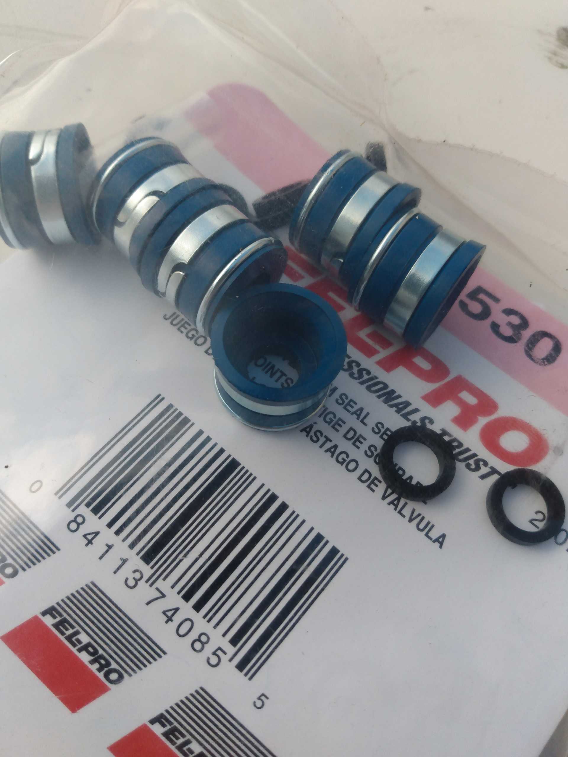

When I did these on my 2.8, Felpro gave me two sets of seals, they looked similar but were different colors, the exhaust seals were supposed to be able to handle the heat as compared to the intake seals.

Felpro gave me two sets of seals... the exhaust seals were supposed to be able to handle the heat as compared to the intake seals.
Interesting. I'm curious about a valid point that the Ogre brought up. With oil seals installed on the exhaust valve guides (where there is no vacuum being exerted), just how do the exhaust valve stems/guides get lubricated?

Well at least on all the engines from different manufacturers that I have worked on, there are always seals on both intake and exhaust valves, and they are always different from one another. My 2.8 also had seals on both sides even before I rebuilt it.
Looking into it it looks like the valve seals are designed for "controlled leaks", and the seals on intake and exhaust may have different rates of "controlled leak". Having no seal on the exhaust would probably allow too much oil to enter the guide and therefore the exhaust runner.
On my first 2.8 motor it used to puff smoke on startup and it smelled oily when engine braking. I replaced the seals and while it helped, the real issue was valve guide wear in my case. The point being though that even with new seals, the seals do let oil past in an amount calibrated for a non-worn valve guide. Otherwise my issues should have been solved. Getting the heads rebuilt did solve the issue.

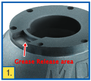

Some seals or parts they work with can have intentional "defects" to make sure a little oil will get thru.
For Parts... Sim to Rear Axle knuckle "seals" w/ a drain hole at bottom. Those seals are mainly a dirt shield to protect the rest of axle and bearing assembly that has own seals to keep out water and grease in. (and is another reason to never drive most vehicles in water deeper then a few inches...)
For Seals... Things like Moog BJ w/ grease release at the stud so prevent boot blowout when greasing after install. From Moog DYK11_102_ENG-R.pdf to install BJ boots.
(in the rear knuckle... most never see the drain hole at bottom of inboard seal even when they replace the seal. Is fairly small and hidden when you have the axle in the knuckle. I have spares w/ axle installed and the drain is nearly hidden by axle's shield/guard ring and tip of stud of the BJ when in the car. is nothing to take pictures w/ axle installed and don't have just a knuckle.)
