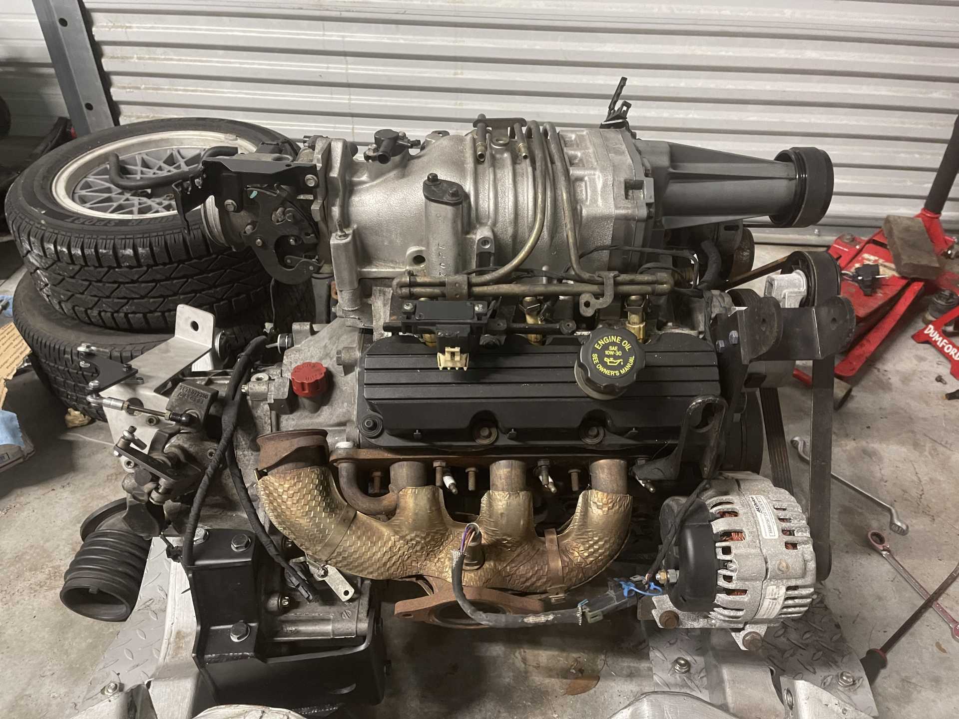

After putting a few hundred KM on my newly swapped F23 /3800 SC combo, I have to say I am very impressed. Brackets fit perfectly, cables are great, and the kit is well made. Took a little longer than expected to arrive when initially ordered, but I would definitely recommend this kit.
Very glad to have the FY1 gearing- big difference from my previous F23 that had the regular 2000-2002 Cavalier gearing, which was not really adequate for the 3800 motor
Special thanks to members SaturnTO (Brian B in Barrie ON) for finishing a careful and excellent swap and Yamaha94 (Marcus for fixing PCM issue for VSS)

Are there any pics of the brackets and hardware, before it was installed?
When you changed to the FY1 gearing... did you swap the internals? Or did you just flip the front bellhousing half, as has been common practice?

Hey Raydar
Gearing was changed by someone else- but he took apart the internals as far as I know
F 23 kit looked the same as what you see on WCF website. Not sure if Brian has photos, I can check. But it really is working awesome. Love the transmission...and I am so glad that I am not with the stock F23 gear ratios. First gear and most of second gear was useless with my last F23. This is great

+1 on the wcf mounts, i have a set going into Snyders car, nicely built, took about 3 weeks to get everything
