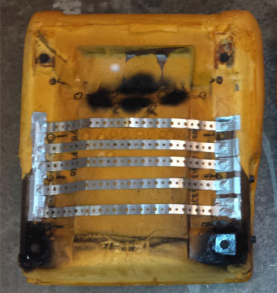

The seat bottom is a steel frame with an opening in the middle- then foam was bonded to it- this worked for 15-20 years just fine. But after a while the foam starts to sag in the middle. I realized this after taking the seat out to be recovered with a passenger-seat cover. I asked the upholsterer if he could do anything about it. He installed webbing straps across the bottom to support the foam in its original shape. Still good after (at least) 10 years.

MrMikes has a fix for your seats.
http://www.mrmikes.com/fierotipsfallenbottom.htm

That’s funny, because I actually emailed MrMike about this and he didn’t mention. I’ll give this a shot.

The Mr Mikes fix is the thing you need to do. I did it two years ago.
I did one change I went with heavier straps like you hang a garage door with vs the roll straps.
Also if you need more you can add padding between the straps and seat bottom.
Home Depot has all you need.

I did the fox with plumbers straps today, it didn’t fix the problem. The seat is tolerable, but I went on 3 separate drives totaling roughly 90 minutes and my tailbone is still hitting metal. I started feeling around the material nearest to the seat back, and there’s about 1 1/2” of metal without any padding whatsoever. I now believe that’s what my tailbone is hitting.
I used an old Yoga mat as added padding between the seat and the plumbers straps, so I’m thinking I can use some remaining foam from the Yoga mat to cover up that metal. I’m not sure how it’ll effect the seat’s ability to fold.
The alternative would be to figure out the seat back. I’m guessing if the padding is ripped off that, it’s give me the ability to sit back far enough for my skeleton to impact the seat’s frame.
The frustrating part about all this is not it’s taking me so long to solve, it’s that I’m seemingly the only person who sits upright enough to hit that part of the seat.

It is very possible your seats my be too far gone if the foam is more than just sagging.
Keep in mind too that in a Mr Mikes kit he will have you glue foam on the top of the west before the leather covers are added.
One last thing. If these seats are like new they are not soft. The factor seats are quite firm as are many performance seats. I have my original set and they are still in like new condition and they are firm as the day I bought the car.
. My HHR SS had the GM performance seat option and they were about as firm as my Fiero seats.
One quick note I bought my car new. Yen sagging seats are out of another car to put my leather on since my original seats were like new.
We also just put a 30,000 mile car back on the road and it has pretty firm seats.
