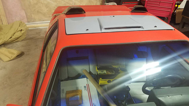

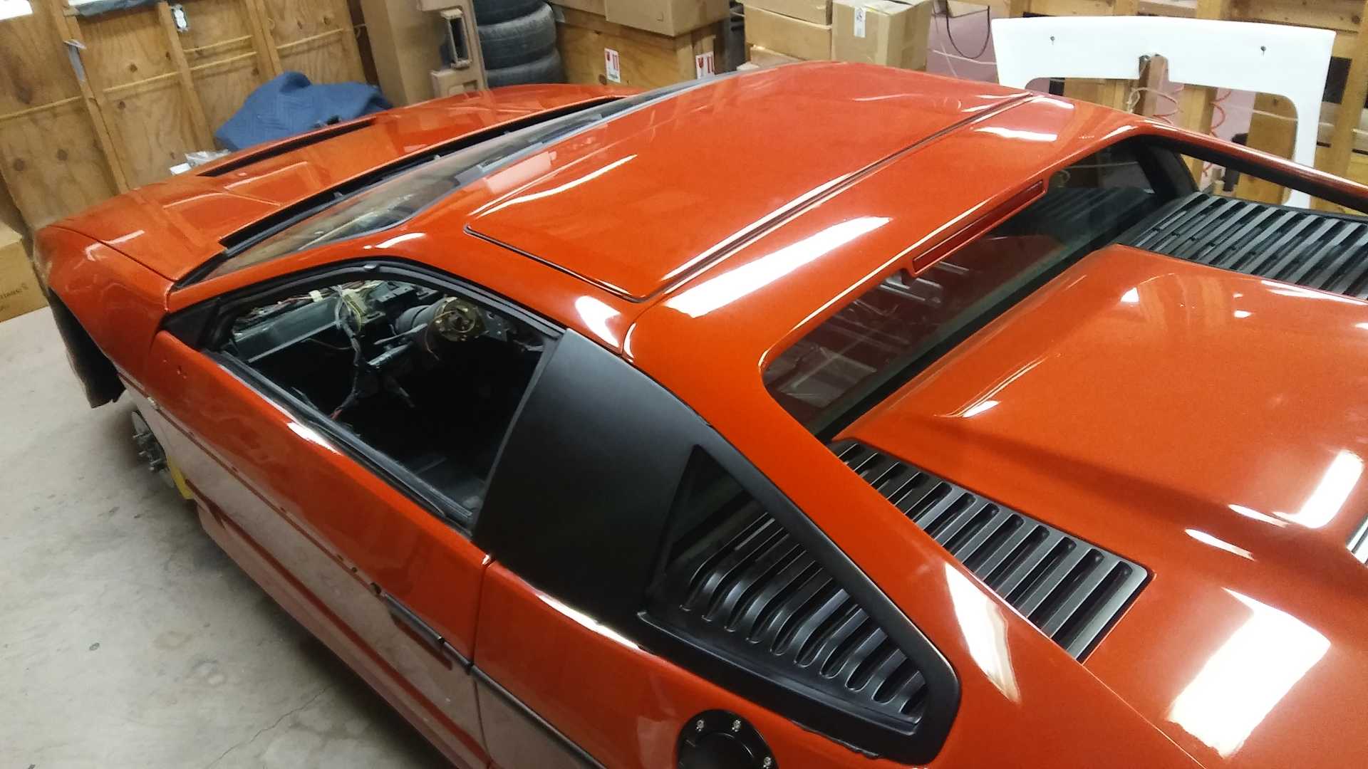

I just made my own. Made a one time mold from the original sun roof glass and cast a fiberglass one. Hardware/Nuts are bonded into the panel, to attach the Tabs and Latch...Now I can swap between the glass panel or the the fiberglass one.

Orig88GT-NC...That's exactly what I was looking for! Very clean. Would love to see any build photos on how you did it, fabrication details, etc.

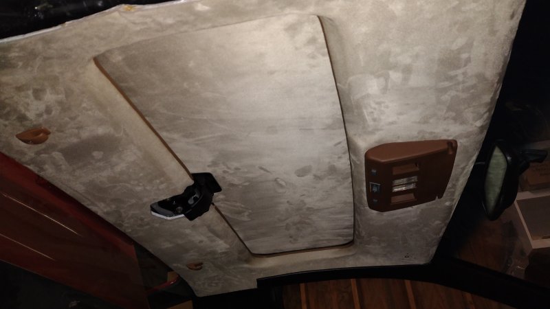

I did paint the underside (Dark Gray) to sort of match the look of other OEM panels on the car... ie. underside of Hood, Rear Deck or Sun Roof opening.. But I did fabricate a new Sun Shade panel covered with the same Headliner material to give it a more finished look.
Fabricated Sun Shade
Headliner.. It's a Light Tan Suede material.

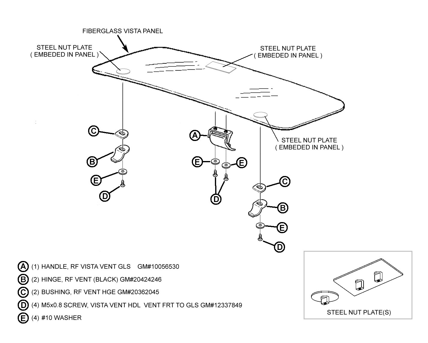

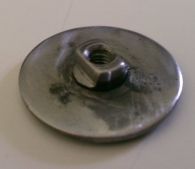

● The first thing I did was obtain the hardware... Latch Handle/ Tabs .. and make some steel nut plates to embed into the fiberglass.
One of the Nut Plates

Fantastic i put in a Suede leather liner light tan so looks similar. I used to have factory bag for roof but someone took it. Finger up to them.

Dude !! You are back ! Awesome,.. I see you painted the car too ! Looks great ! Need to update your build and videos.

Hey... Glad to see some old friends still hanging around.
Wondered if anybody would notice my little teaser pic. The car has come out looking nice all around. Just going to put some rubber on the new wheels before I post any real pictures and upload a new vid on YouTube. Probably be about a week or so..
