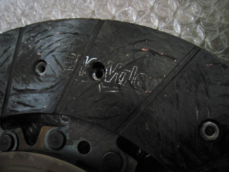

After 12000 km of mixed-use driving (cruising, city, highway, dragstrip), the "Valeo" writing was still visible on the clutch disk friction face. Maybe with a better break-in I would have had better results, but I thought that 12000 km would have been enough.

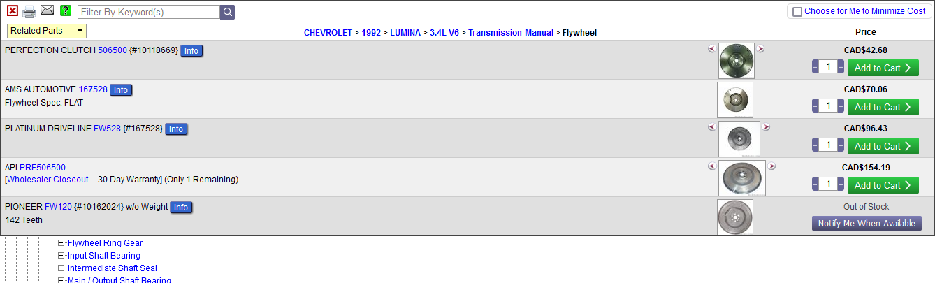

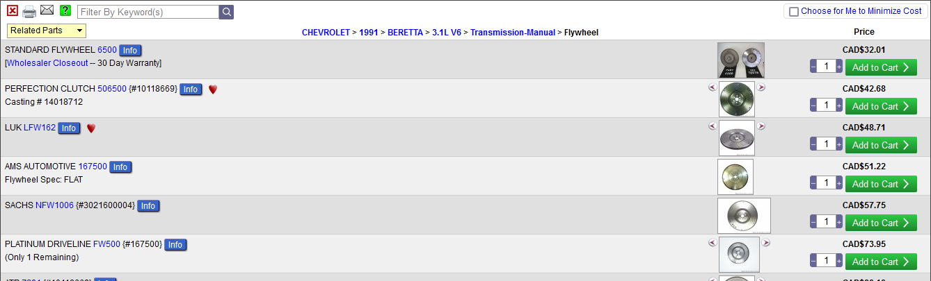

Comparing flywheels... I like to use Rockauto (other vendor websites could work as well):
3.1 Beretta:
3.4 Lumina:
The PERFECTION CLUTCH 506500 is listed for both, so apparently the same flywheel can be used for both.
However, other for manufacturers such as AMS AUTOMOTIVE or PLATINUM DRIVELINE the suggested flywheel is different.
Clicking on the "Info" button reveals that the pressure plate bolt pattern might be different for the Getrag 284 pressure plate.
Sometimes there appears to be contradictions within the listings
[This message has been edited by pmbrunelle (edited 10-08-2021).]

The 3.4TDC and 284 getrag used a pull style pressure plate for its clutch.
The 282 getrag and all fiero manuals use a push style clutch.
If they list the same clutch kit for both applications, the listing is wrong and I wouldn't buy it for either.
Rock Auto is one of the worst sites for having wrong info.
