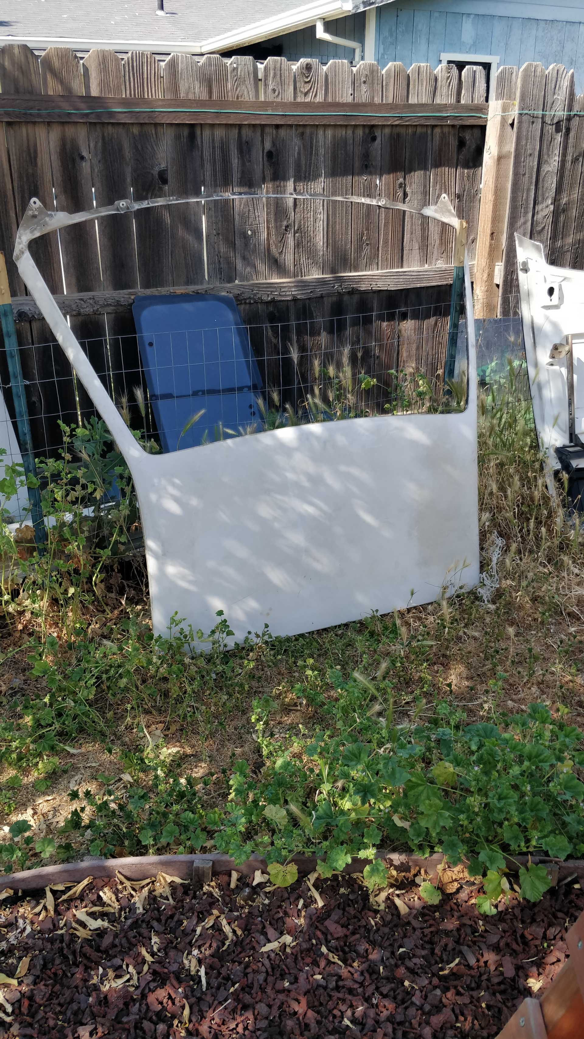

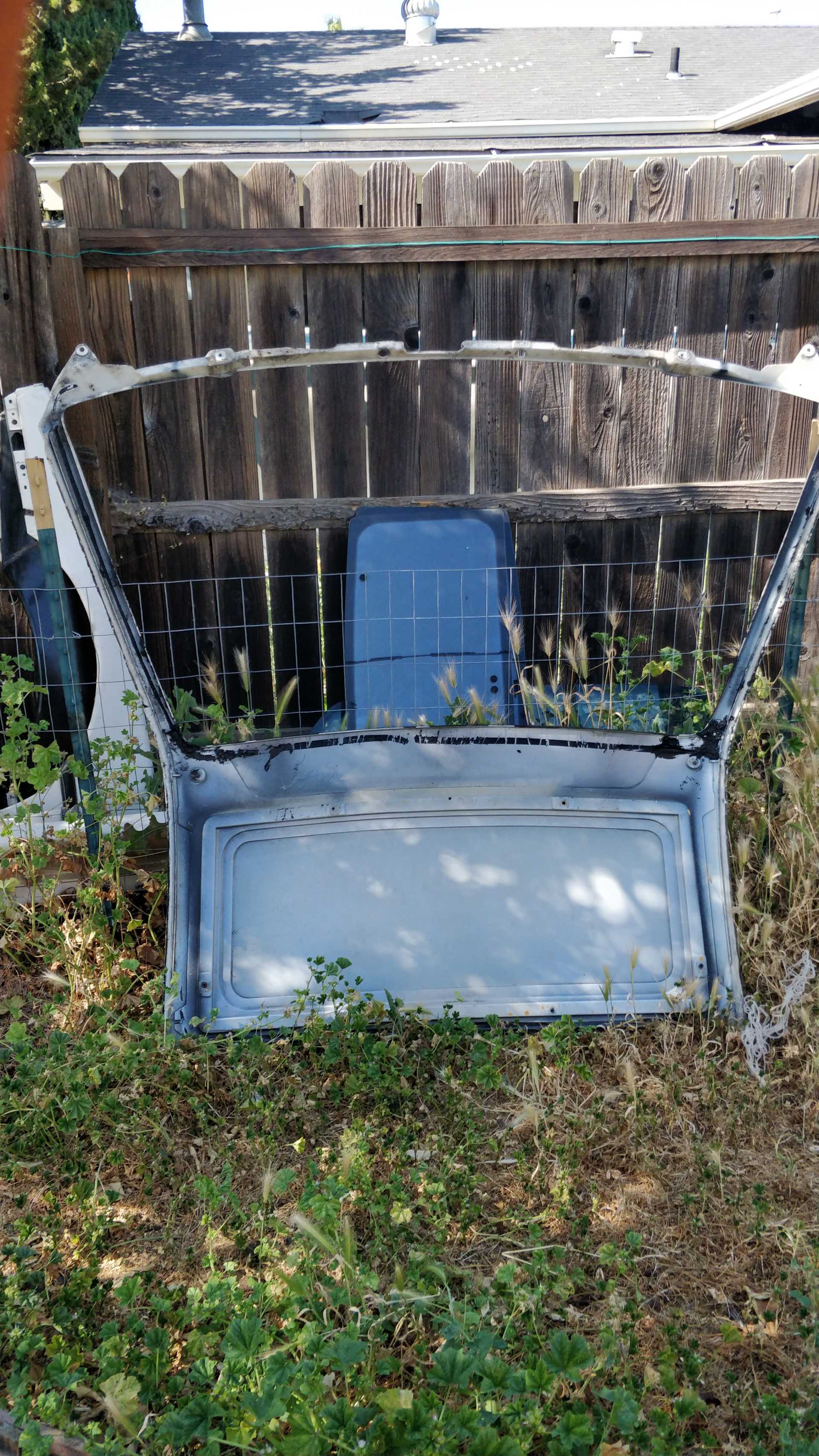

OMG 4th times the charm. I finally managed to pull a roof whole.
No cracks no busted studs just a roof.
Tips:
Do it on a hot day or have a heat gun.
Make sure you have all of the nuts and bolts removed.
Pull the window rubber trim between the roof and a pillars and the windshield.
Run a razor blade on the inside of this channel.
Take your time use lots of wedges and also you can stuff flat Paper or cardboard between the roof and the strip caulk. The strip caulk will want to glue back together.
Make sure you lift the roof section that runs at the bottom of the windshield up above the glass. It will wedge itself against the glass so prop it above.
