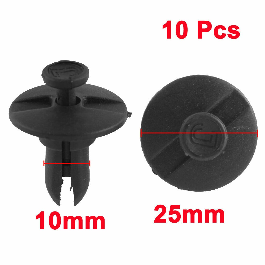

Pull up on the centers of all the black plastic push-nuts found on the top and bottom of the fascia. Some of these are found when tail lamps are removed, some by the exhaust splitters can be hidden.

Remove the tail lights and you’ll see a row of plastic clips that hold the top of the fascia to the metal frame. Use a screw driver or similar tool to pry up the center of each clip then remove the whole clip, There are also a few clips on the bottom of the fascia.

BTW - those plastic fasteners get funky with age. I have a ton of new ones. LMK if you need some, just pay postage.
