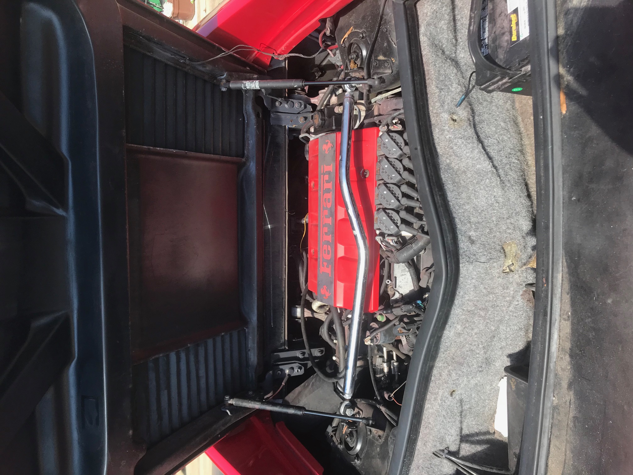

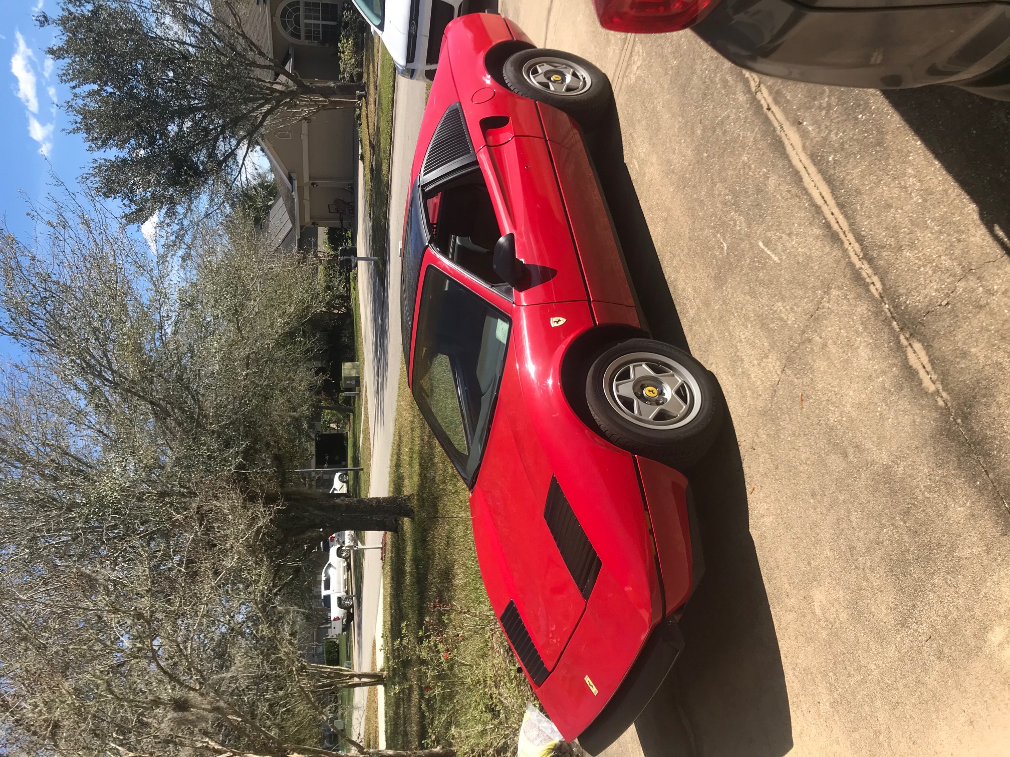

[img]https://images.fiero.nl/userimage s/DrXtreme/Mera%202.jpg[/img] Here are pics of my 1988 Mera with Northstar V8 engine and transmission. As you can see, it needs work.
Rear suspension has lots of red bushings, so I'm guessing polyurethane. It does have KYB adjustable coil over rear shocks, no idea who chose those stupidly big rear tires.

Northstar V8 seems to be well done, shop that changed water pump said it was a clean install. Needs some work on small stuff, big one is AC lines where when I moved them over under the car, heard a hiss so expect to need some line replacement.
Recent paint job, I see bubbles/fish eyes so I know I will have to strip and repaint. Not a prblem, did that to make extra money back in my younger days.

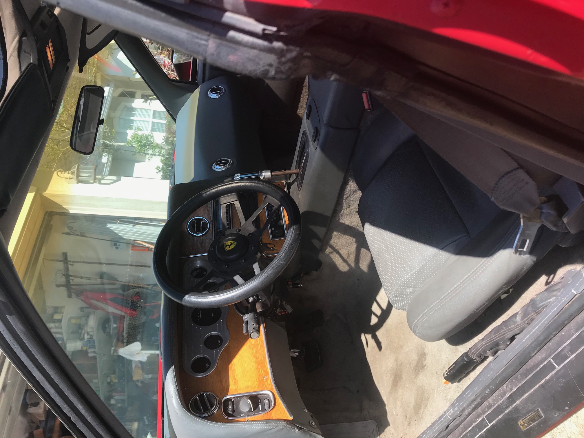

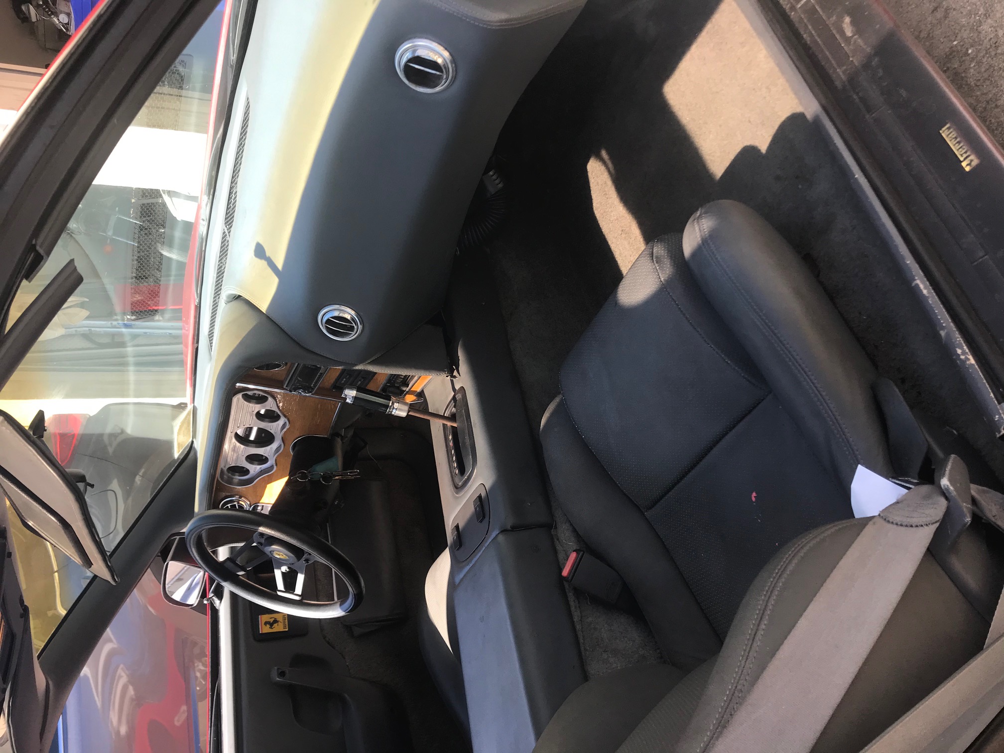

Euro style dash, no idea where it came from. You have to love the wood grain dash cover yet they installed Dakota Digital gauges; has less than 400 miles on odometer. Wood will be recovered in carbon fiber.
Interior smells like gear/motor oil. Took it for a ride yesterday for an hour or 2 and couldn't get the oil taste out of my mouth. Carpet is likely trashed, dash shows signs of strain so will need to be recovered and stereo doesn't work. Seats were recovered but drivers show rub wear on left side.

Looks like a Pisa dash cover. Car looks nice, thanks for posting.

I am not certain what you consider to be ridiculously large tires, but one of my Meras came to me with 295 x 50 x 15 tires on the rear. They have since been returned to the stock size. The OEM tire sizes for Meras are 245 x 50 x15 for the front and 265 x 50 x 15 for the rear tires. You can also use the 265 tires on the front (due to the current unavailability of the 245 tires) but may experience some rubbing on hard, low speed turns such as in a parking lot.

The rear tire is 225/70-15, its much larger diameter like the old school hot rods. Problem is they are brand new and hate to replace good tire.

New tire or not I would change what you have and use something closer to the OEM tire setup. WRT alignment, I suggest that anyone acquiring a car and having questions would potentially benefit from an alignment check. Use a facility that can do four wheel alignment and make certain that they have the acceptable factory specs.

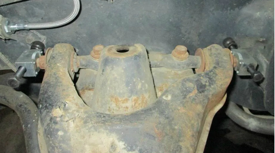

Most alignment shops have never seen a Fiero and probably won't know how to properly set the front caster and camber. The upper A arm pivot shaft has ridges on the underside that bite into the frame to hold the shaft in position. You need a set of Kent Moore J-36419 tools to keep the shaft in place while the mounting bolts are tightened. They show up on Ebay occasionally.

Fix your pictures, they are all sideways.

I'm not sure why pictures showed up sideways as they were taken in normal mode.

The PISA dash emulates the real 308 Ferrari. This is something I have not found who sells it. Based on the aged wood dash, I'm thinking this came from another car and an older build (cup and coin holder?). The seams on the dash are pulled and stressed, so it's not as new as the rest of the car.
