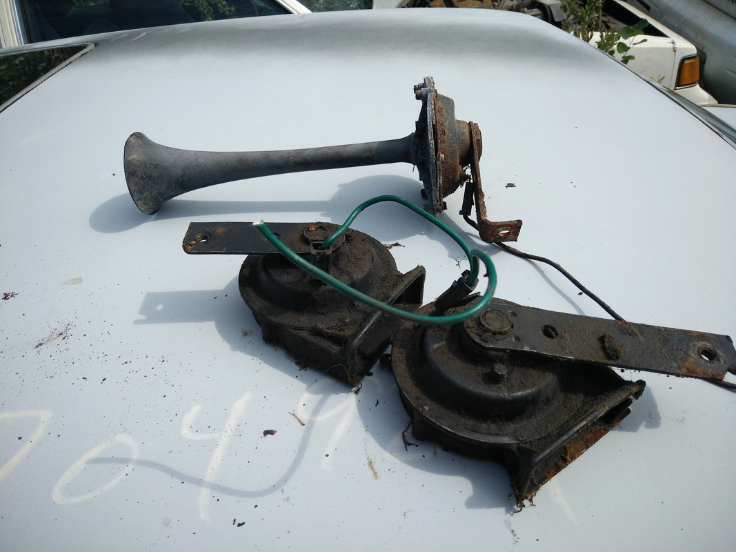

i have always hated my wimpy Fiero horns. Sounds like the duke accelerates. ;-) So reading threads on horns i trot off to the scrap yard to find some. i found a cool one off a Caddy with a TRUMPET attached to it, rusty tho. i also pulled two off an Oldsmobile that are interconnected on the drivers side - one wire to two horns. Kinda cool. They are real greasy - thats a good thing for those of you that don't live in the rustbelt. One horn is damaged in an on-purpose-ident. Here are the horns:
best image hosting
They come from these cars:
Caddy
Oldsmobile
i didn't buy any horns because i came back with more questions than i left with.
As a woodwind musician (horns are my thing) i want to play not just a two note chord but a minor triad or even a minor seventh, which means that i need three or four horns. Can horns be tuned? How? Can i tune my Fiero horns?
Some guys on this forum say that Caddy horns sound good. Are there two of them? i only found one from the Caddy in the pic, and i can't find any horns on other Caddys. Where are they? What do big older Oldsmobile horns sound like? i can't find horns on Chevy trucks. Where are they? Which are the best sounding horns?
thanks

i pulled the horns from the Caddy in the original picture, not the other car. Easy peasy. The Caddy horns were all greasy and therefore not rusted. They were hidden on the drivers side, and the horn with the trumpet was in front of the radiator. i want to assure myself that the trumpet one works before buying it, , because it wasn't greasy and so i has rust. So i just installed the small horns. They are tuned to a Gb and Bb. A major third (or a minor 6th ), in any case they sound like a read car now. i wonder how much better they will sound with the trumpet one installed. i pulled the Y wire so i can hook up two to one side.
Plug right in to the stock wires and ground to the chassis. Along with my power brake booster from a 95 GMC Sonoma, i feel like i have a new car. A Sonoma booster is a good thing to have for an ex-northern California guy.
