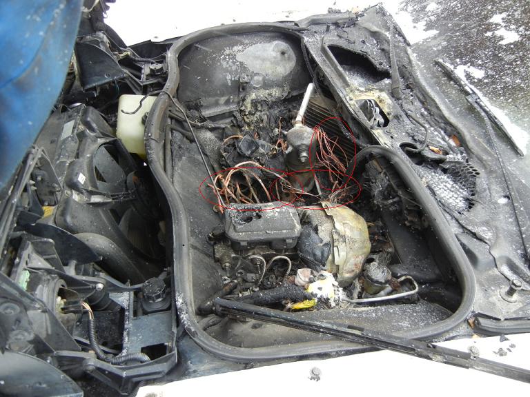

Oh yes they can, and very often do! 1984WhiteSE woke up to the fire department banging on his door at 1am telling him his car was being put out.
The basics are:
There is a large resistor located in the cowl. When you put the fan on low, medium, or medium high it "resists" the electricity going through it, thus making the blower motor run slower. The lower the fan setting, the hotter the resistor can get, and it can get REALLY hot. To keep it cool while the blower is running, it is in the airflow coming into the fan intake. The problem is that leaves, debris, and even nests of mice and such collect in this area. When the resistor gets hot enough the debris can start to smolder. The car can be parked for hours before flames actually take hold, and catches on fire.
This was Andrews car when the sun came out the next morning, December 20th 2011
