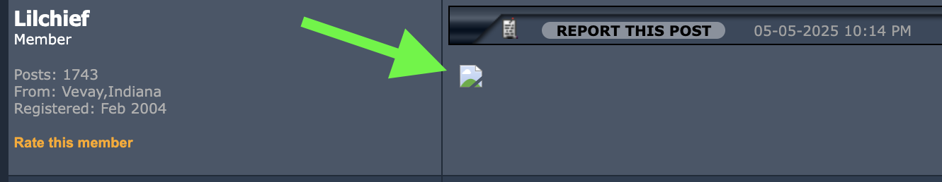

Lilchief's image posted on 5/5 showed as broken for me as seen below. However, I was able to download and convert the image and will upload it here as a jpeg file. Perhaps HEIC files aren't yet supported in this forum, or maybe there was some other glitch:

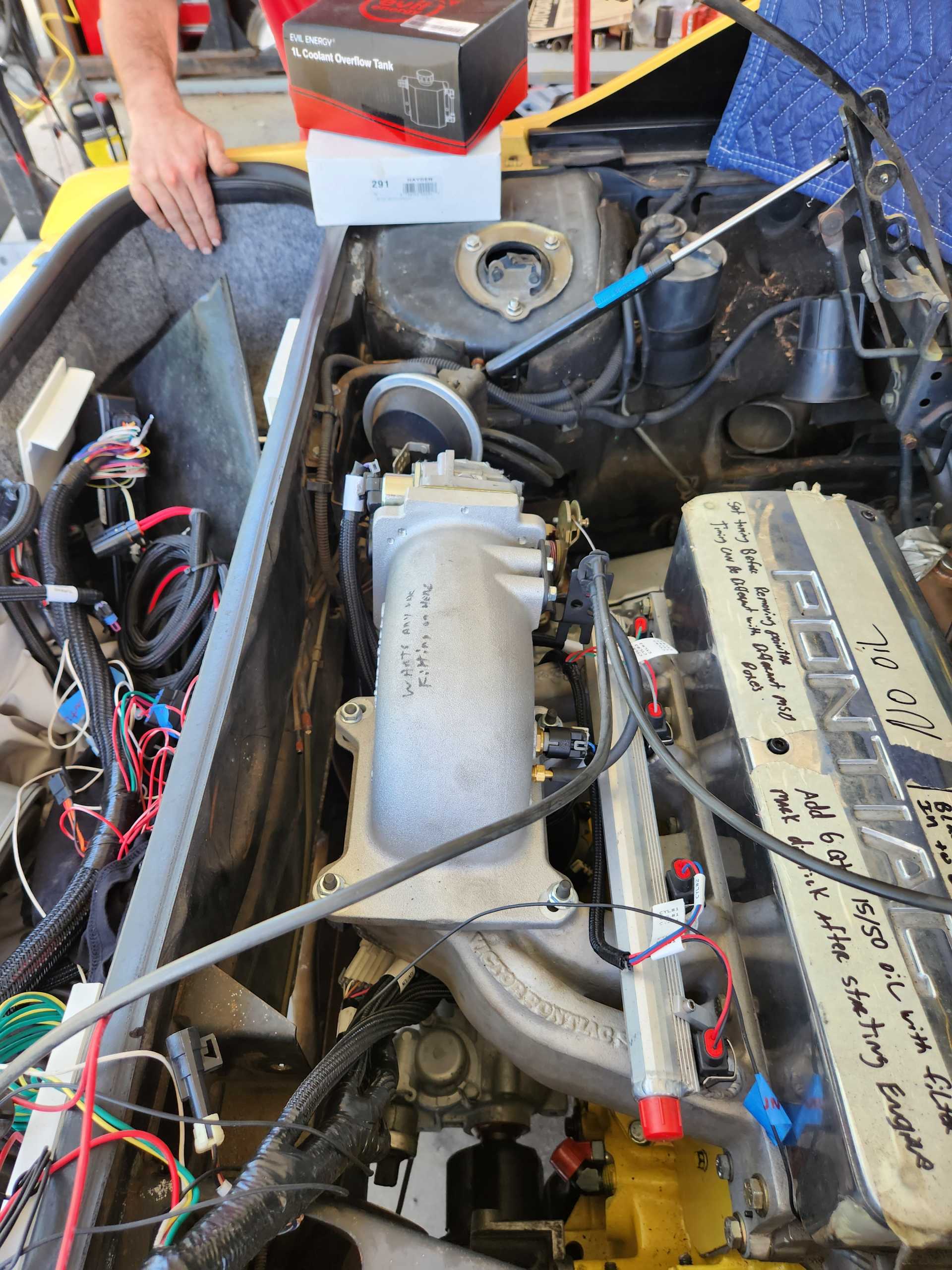

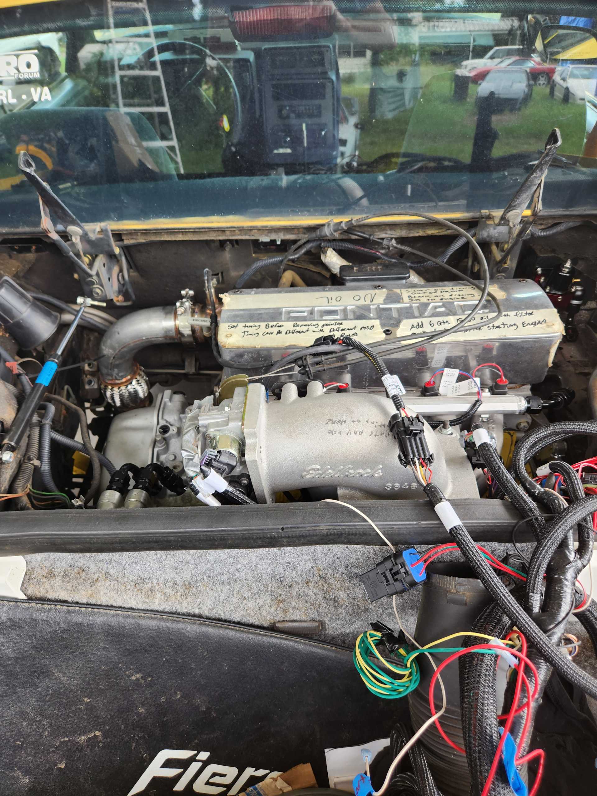

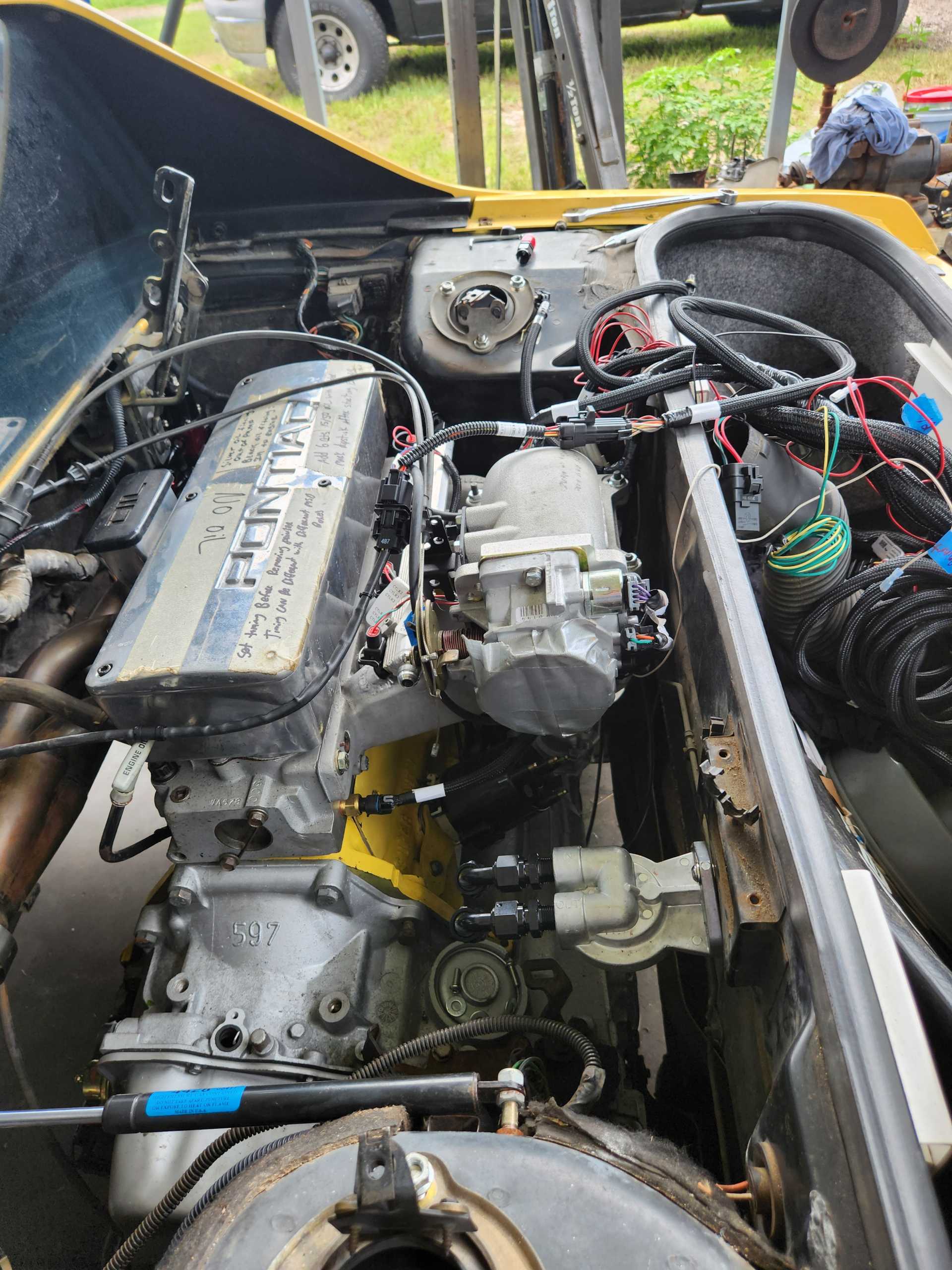

Think we have the mounting issue solved. Now we have an oil pan and exhaust issue. And got battery box moved to the front and fuel pump changed out. Still a ways to go.
