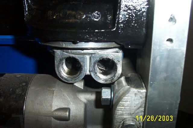

There is a narrow range of adjustment as to where the fittings can be and not have a hose against the exhaust. The fittings may line up and they might not when the adapter is tight. It is also possible to shim or mill the gasket channel so it will line up.
I don't know if you saw my post in the topic about a good or bad deal, but that pic shows more room than normal due to the choice of a gear reduction starter with fully adjustable clocking.
It might be possible to use elbows with such a starter. I didn't try that combo.

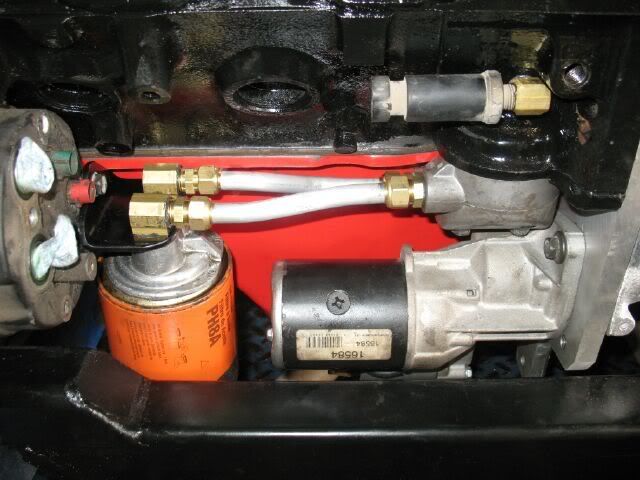

You can use the quad outlet one, but it takes some work. The thread is not right for the SBC, so you can buy the spin on filter kit for the SBC as it comes with several thread options. From there the Ford one will spin on, but then it will interfere with the starter mount face plate. So a little grinding here and there and the right starter (it was a summit brand one) and it works.
Here is another one I did that was an Archie swap, but converted to use the 142 tooth ring gear, so the started needed to be even closer to the engine (Archies flywheel is 153 tooth). There was no room to use the center port, so the oil pressure hole on the side of the block was drilled and tapped to accept a larger fitting.
Another modification I like to do is to machine the adapter to accept an oil filter gasket (forget which one, but it was an off the shelf filter, then just pull the o-ring from it):
On the 4.3L engines and when using the Zumalt kit with the nissan starter you can rework a stock 4.3 4x4 oil filter relocation plate and route it to an aftermarket filter holder. Notice the black fabricated bracket holding the filter housing... to get the proper IN/OUT ports to line up between the two, the cast mounting bracket for the filter housing needed to be cut off so the lines could pass through it. The 4.3 oil filter boss is a smaller diameter than the conventional SBC.
