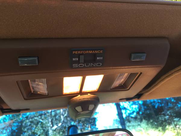

Rodney window helpers - installs a relay between the window switch and the motor. Right now (if still factory) all the current that drives the window motor passes through the window up/down switch. Some have said it helps with the speed.
subwoofer - yes on the cars that had the "performance sound system". There is a sub "volume control" located in the overhead light assembly (can't miss it).
