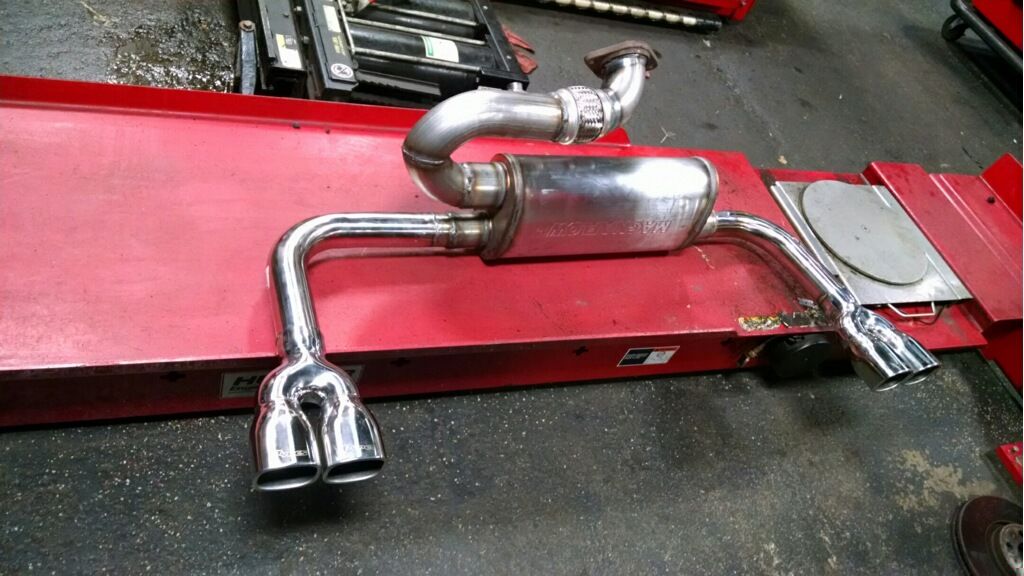

Your friend should get an exhaust from WCF.
No trunk hacking needed, and they should know how to make it fit a Fiero, even if they don't have your friend's specific Fiero at the shop.
If your friend doesn't want to buy the exhaust from them, he can still use the pictures for inspiration on how to route the exhaust.

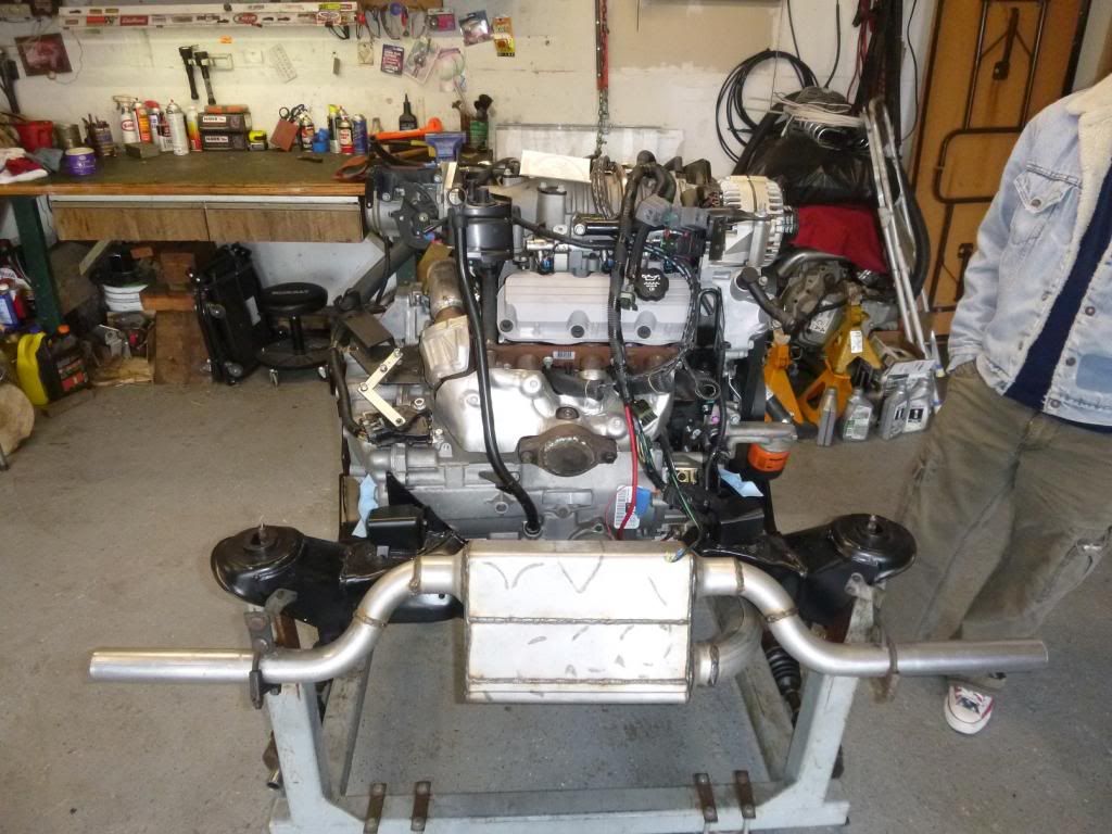

This is the EXACT setup that I went with. I used a standard Camaro muffler, verses the performance.
I did this due to the performance one has more of a "drone" at highway speeds. This is pretty much the setup that 90% of people that do a swap go with. It is close, but no need to cut the trunk, and none of the exhaust is hitting the trunk or frame in any way. Print out a copy of this photo, and take it to your exhaust guy. Tell him that this is what everyone uses, and no cutting of the trunk is necessary. I am sorry to say, if he can not do it, then you need to find another person. Not being degrading or mean, but as far as custom exhausts go, this is a very easy one to do.
THIS IS THE MUFFLER I PURCHASED, and the exhaust shop talked me into using the stock Camaro muffler, as it would not be quite as loud as this one. The performance muffler will have a deeper, "meaner" tone, but I am looking for more the sleeper type I have this muffler new in the box for a good price if anyone is interested.
[This message has been edited by JohnWPB (edited 05-03-2017).]

Thanks. Not cheap. Your average muffler shop maybe afraid to do this custom job. Not because it is mine but I haven't heard a better sounding muffler for the 3800 than this one.

I personally prefer the style I posted above. With that style of Muffler, you have one input at the top of the mullfer. Then, at the botton you have an output to each side of the car. You do not need to bend one around 180 degrees to go to the other side of the car. Also, this setup does sit a little low to begin with. With the one that wraps around to go to the other side, sitting around 4-6 inches lower.
As a bonus, the one with outputs on each end, is neater, requires less parts and fabrication, thus it's cheaper
Are you saying that is the one you bought, but not the one you used?
What year is your car? That Magnaflow one would not fit on my 88 unless I were to bend the trunk wall in at least an inch.
Yes, I bought that one, and the muffler shop said it would be a little louder that what I described to them as for what I am going for. Therefore I still have it new in the box, and they just used a stock Camaro muffler they stock. I do not know the model number of it unfortunately. My Fiero is an 86 GT.
