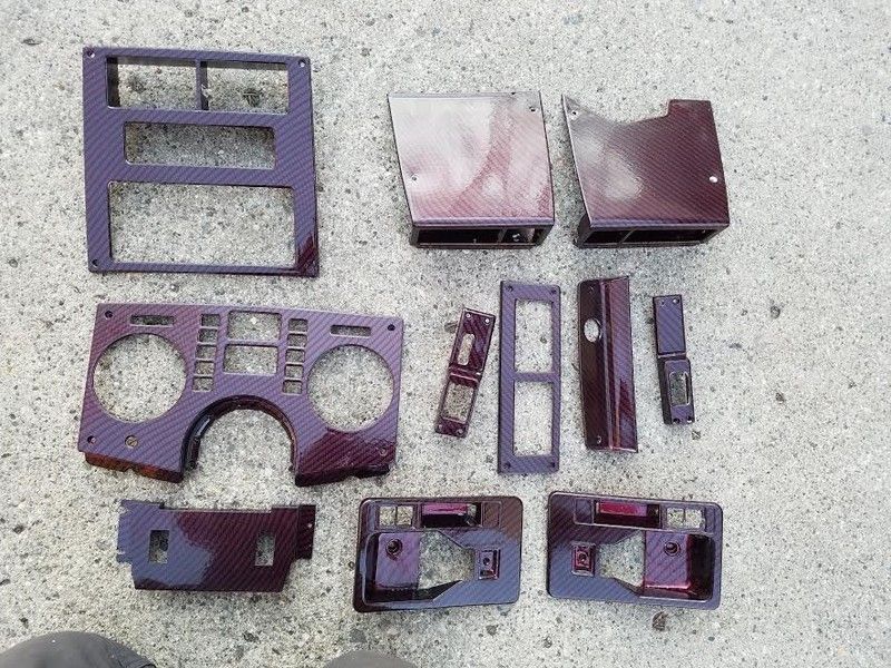

A buddy if mine has a drive shaft shop in town and he gets super slow in the winter since he mainly builds parts for tractors and heavy equipment. He decided to set up a hydro dipping tank and buy the products to do it. I was surprised actually how easy it is to get into it and cheap. The preprinted film comes in 36" in wide rolls and costs roughly .60 a linear foot. The more you buy the cheaper it gets. quite a few test parts, like wheels, interior parts, spoilers, atv fenders, etc... We got the hang doing it right the first place, but if you mess up, you just re dip the pattern again. After dipping you clear the parts with automotive grade clear coat and re-install.
I decided what the heck, why not try my fiero. I was boring and went with a carbon fiber. The film we used for my parts is designed to show the color of the part though it, so you can do any color you want in a carbon fiber pattern. My car is a burgundy-fuchsia kind of color, so the parts were prepped and shot in a base coat that kinda matched my car. Pictures below show how the parts turned out. All these parts took roughly 2 hours of labor start to finish to do.

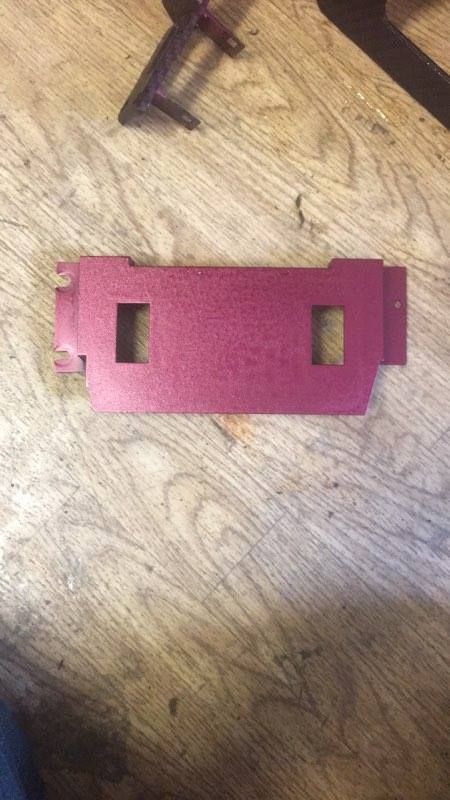

This is the base color all my parts were painted prior to dipping.

More parts that I did, basically I pulled every small trim piece I had to dip.

I really like how this process works, and the film options seem endless. The woodgrain (even fancy wood patterns) turn out amazingly realistic and this is a painless, simple way to dress up a car. I had thought about hydro dipping my entire car, but parts like the whole fastback rear clip would require a massive setup to pull off.

Good to see that masking tape works with hydro-dipping (as in the PRND indicator window).

Nice parts too boysatt - they look awesome!

A video showing various items and various patterns. How durable is this application? In the case of grills and wheels, will it stand up well to the elements?

Should stand up as well as the clearcoat used on top would.
