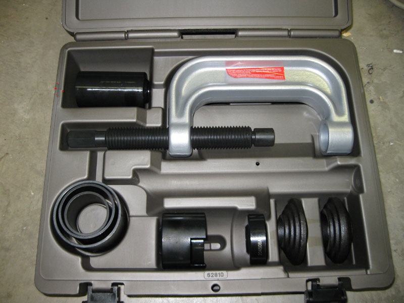

Make sure you get a good ball joint tool if you don't already have one. The large C-Clamp style works best to remove and install them, but isn't cheap. Well worth the money though.

That's for separating the steering knuckle from the ball joints. You still need to obtain (buy, rent, etc) the tool to press the ball joint from the lower control arm. Its like a giant C-clamp with sleeves to fit different size ball joints.
By the way, the tool I rented from Autozone didn't have the correct size sleeve for the 88s so I had to improvise one from something I found in the exhaust aisle.
Neils88
I bought this kit as well. I think it cost me about $150 (Cdn). Well worth the money.

Originally posted by Neils88:
I bought this kit as well. I think it cost me about $150 (Cdn)...
Neil, there's a much cheaper way of doing this!
Originally posted by Patrick in This thread:
Here's a picture of the ball joint press that we were using.
It turns out that Canadian Tire has a "loan" program where you "buy" the above kit for $229 (plus tax), but if you return it within 72 hours, it doesn't cost a cent to use it. I don't understand why they offer this service (I guess they hope you'll just keep it), but I was quite happy to be able to use the press and then return it within the 72 hour period.

I bought the ball joint press from Harbor Freight. It also did not have the correct sleeves to remove the lower ball joints from the 88.
Since I was doing bushings too, and already had the arms removed, I found it just as easy to place the arms across my vice, and pound the old ball joints out, and new ball joints in, using a BFH and a socket.

You can rent a ball joint press from Orillies auto parts. You basically pay for it, use it, and get all your money back when you return it.
