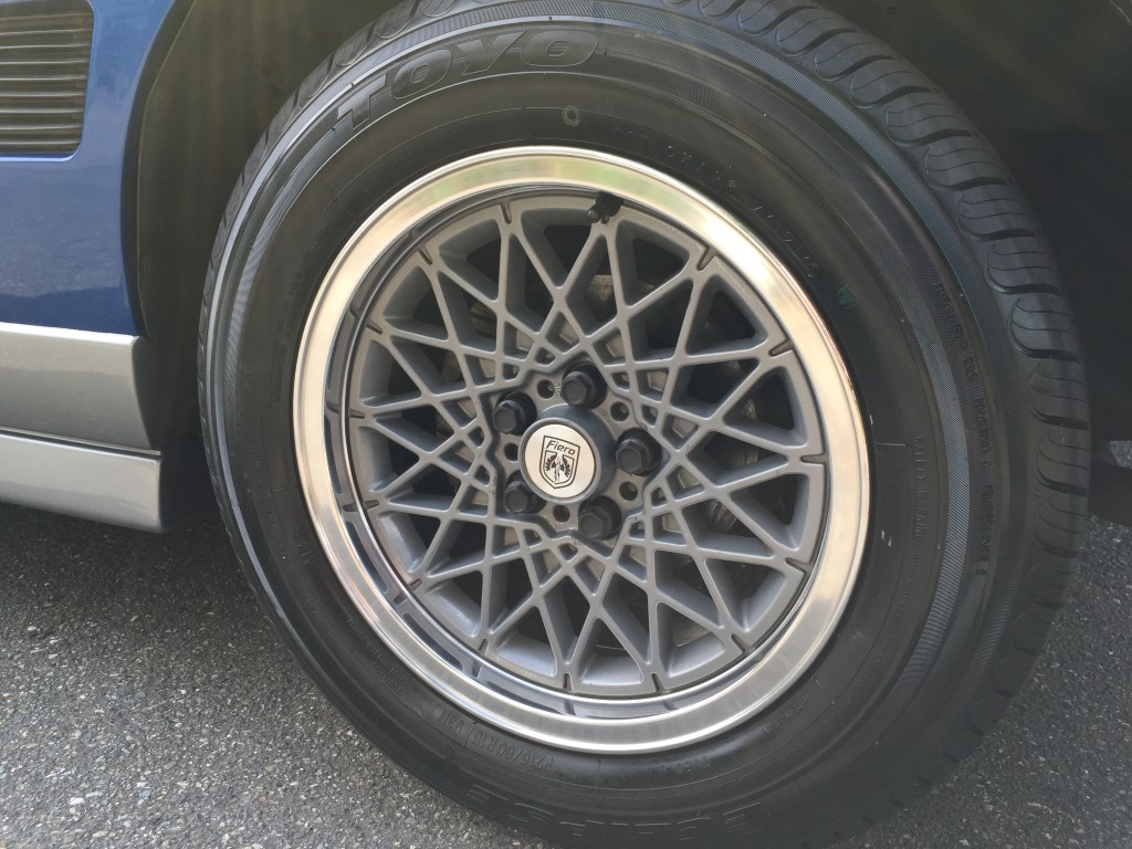

Originally posted by yellow peril:
haha wow, don't think I'll give that a try. I have the " hi tech turbo aluminium wheel" too many holes for my fingers to get caught on.
Another 92 HP engine lathe set-up; sold the wheels for $200. No fingers were harmed during the operation.

the dirty one is very close to what I have to deal with. maybe I should reconsider the lathe treatment
those wheels are gorgeous by the way. nice job

Thanks! They were all corroded like that under the clear coat. I also turned the clear coat off 20+(?) years ago from my '84 SE and never re-coated them.
