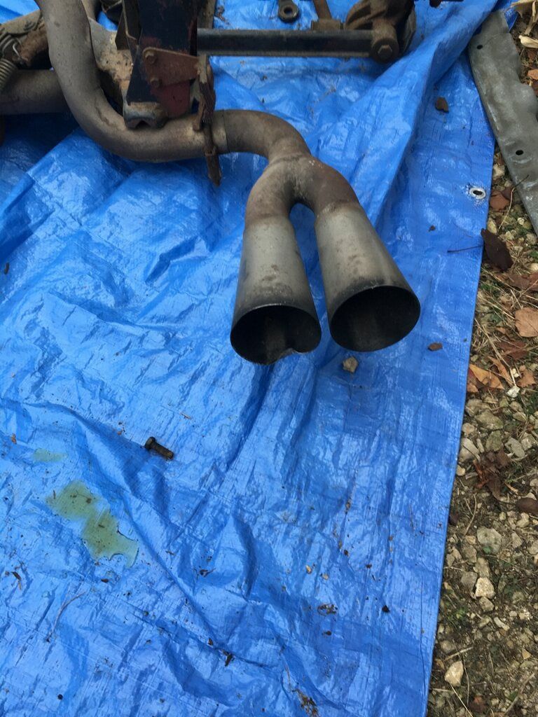

Side note: Anybody else notice when looking at pictures of unmolested '88 GT tail pipes, the drivers side tip is always a little lower than the passenger side.
Mine is, and I thought it was just out of adjustment, but as I have been searching, I see it a lot like that......
eh, I am picky about having a symmetrical exhaust, but that looks like that is the way they put it together... must have had a shorter person working on that side. LOL
Yes! What's up with that?
