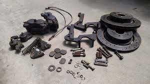

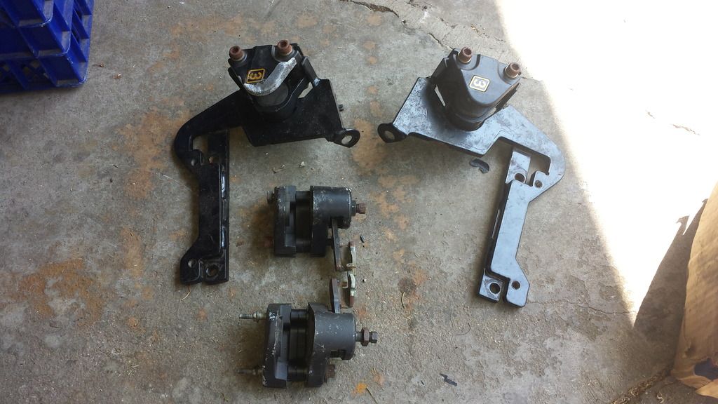

That being said, if you really want to go with the spot caliper setup, maybe we could work a deal. When I bought my 3800 swapped car, among the pile of parts inside the car was a box with 4 of those Willwood spot calipers as well as custom brackets that I believe were part of the 12" Willwood setup that was available for Fieros.
Here is a pic of what I have:
Here is a pic I found online of a complete Rear Willwood setup for the Fiero that has the same brackets that I have.
I believe these brackets are designed to work with 12" Willwood rotor, but may be a good start for what you would need.
