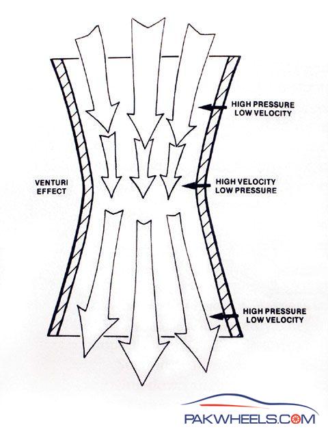

Borla has a solution for their systems when customers complain of drone in their system.
The Borla Venturi is a simple reducer that changes the flow characteristic and hence, the sound waves in the exhaust.
People have said they WORK and experience no power loss (some complaints of power loss with C-C inserts).
I'm expecting delivery next week. So I'll see how well they work after I install it.

cvxjet
Posts: 3926
From: ca, usa
Registered: May 2010
Report this Post08-30-2017 03:19 PM Click Here to See the Profile for cvxjetSend a Private Message to cvxjetEdit/Delete MessageReply w/QuoteDirect Link to This Post
The Venturi Effect is something I show all the kids I know when they turn approx' 13-15....They are teenagers and begin to think "I KNOW it ALL!" so I ask them which way will two sheets of paper go, held approx' 1" apart, if I blow between them? Almost every one of them says they'll go out....And then they are amazed when the pages come together......"Don't think you know it all....You are young, and have a long life ahead- Continue learning- ALWAYS!"
Sadly, there are a lot of adults who could learn from this example.......
