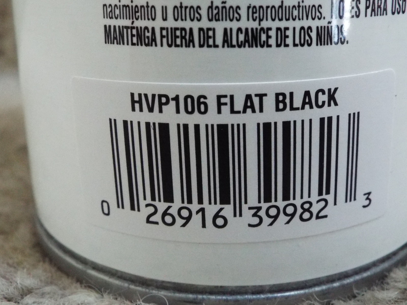

I have converted several interiors to black.
I have tried a lot of products, but I like the look and reflective -ness I get out of the Dupli-Color Vinyl & Fabric spray:
I prefer the flat black:
The gloss black makes it look like it has a fresh coat of armor all on it.
