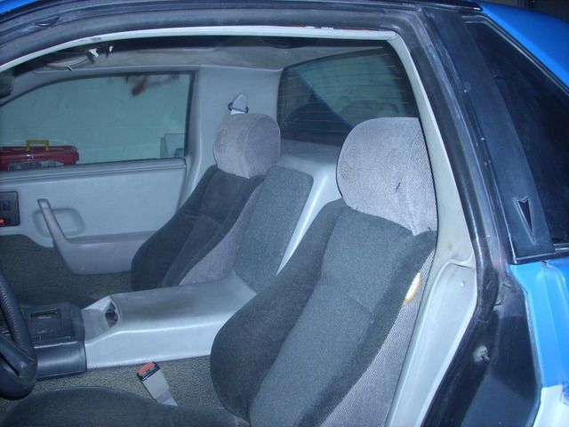

This is what I did with mine.

That's one way to do it. Nice job
Are the subs better mounted towards the floor or near the top behind the seats, like the one that FS sells called the 84-88 Rear Wall Speaker Panel are near the top. What's the advantages/disadvantages of each?
Thanks.
Thanks.
If I remember correctly what the Fiero store sells isn't a sub enclosure it's just a plastic panel that allows you to mount a full range speaker like a 6.5" 3-way or something. For what I did, if you look at the center console you can see the rear wall was extended forward about a inch and quarter at the top. It was about a two and a half inch extension out at the bottom. There is also a channel across the bottom behind some spot welded panels on that rear firewall. I cut those open and sealed both ends to allow the speakers magnet structure more depth for mounting. Those woofers had around a 4-1/2" to 5" mounting depth and sounded awesome. I like when I can turn a stereo up loud enough to make normal conversation impossible to hear while the sound from the audio system still remains clear as a bell.
