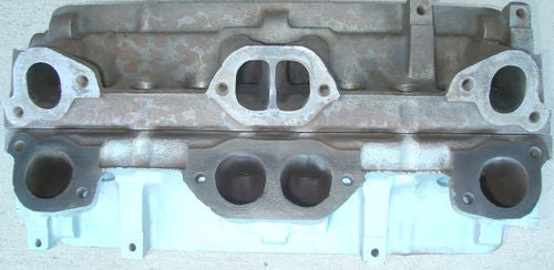

FYI, after 1972 there was no "HO" 455. The mid 70's did have a 455 HO option, but it was the station wagon 455 with "455 HO" decals on the shaker. There was nothing different about it compared to the 455 in a Bonneville.
In '71 and '72 the last real 455 HO, they had a bigger cam, round port heads (same design as the Ram Air IV, but lower compression), and a 2 piece aluminum & cast iron intake with an 800 cfm Q'jet. '73 and '74 upped the ante with the Super Duty and that was the end of the high performance 455 Pontiac from the factory.
The mid-70's 455 had low compression, a tiny camshaft and a heavily restricted intake manifold.
Comparison of regular "D" port heads with "HO" round port heads. Super Duty also used round ports with even larger port volume.
