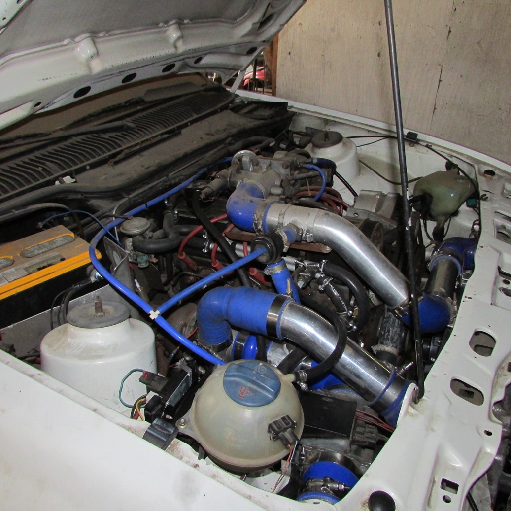

Every two years my guys have to smog this mess:
So they are pretty happy when the Fiero shows up.
