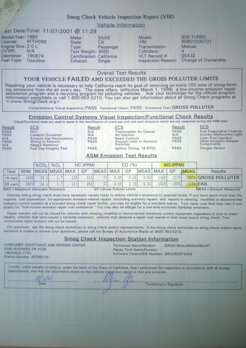

I had easy access to this smog so I'm posting it here for comparison.
This is the last unexpected fail I've ever received (I never expected my '84 T/A to pass ), back in 2001, immediately after swapping a 16v motor into my 8v Saab. As you can see from the report it's smogged as a 1985 Saab, which is the year of the motor.
2001 15mph max are HC:138 CO:0.85 NOx:1169
2015 15mph max are HC:95 CO:0.58 NOx:1136
2001 25mph max are HC:113 CO:0.65 NOx:1029
2015 25mph max are HC:77 CO:0.44 NOx:966
In nearly 15 years HC and CO have been cut by 30% and NOx by 3-6%, so it looks like the first two are at the limits of the cutpoint revision law and NOx is not even close. Why? Because statistical analysis shows HC and CO numbers are being met by most cars and the cut was warranted. NOx however was not cut because Saabs couldn't reliably make lower numbers. The likely reason for that is old Saabs don't have EGR or advanced timing controls, so they have a hard time dealing with NOx.
You can see the analysis->adjustment cycle in action here - it's not some ongoing cut designed to make it impossible to keep old cars on the road. It is a cut designed to keep cars closer to an optimal state of tune. As I mentioned, this is the last fail I've ever gotten on a Saab - not the 2001 numbers or the 2015 numbers or anything in the middle. A good running car *flies* through the test.
Edit: Derp, forgot the test: http://www.sacsaabs.org/sac...c/5door_lastsmog.jpg

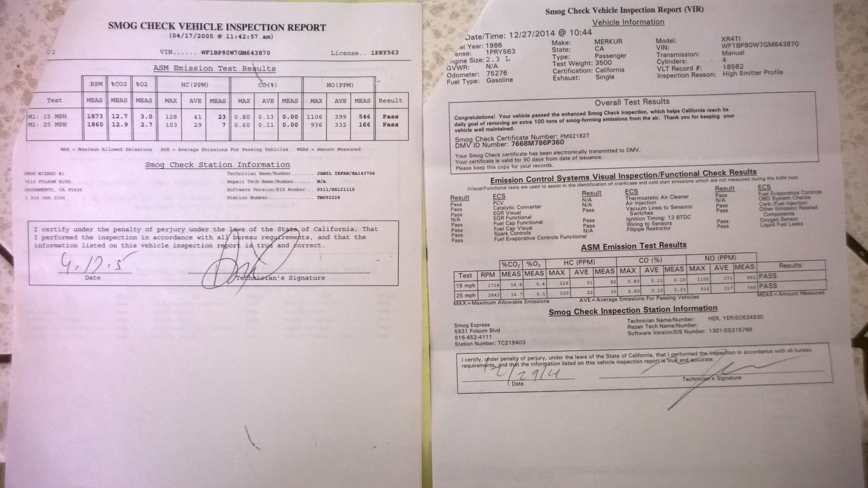

A C student is an average student - the fattest part of the bell curve. That is, where the smog cutpoints are aimed, roughly.
As you can see from your results, even a 29 year old car with nearly 200,000 miles can make the numbers.
NOx is a byproduct of combustion temperatures, and as such is a natural result of ignition. Excess NOx comes into play when you've got an overly lean mixture, carbon deposits insulating the combustion chambers or a less than ideal cooling system. NOx skyrockets with over-advanced ignitions. NOx is controlled by EGR and the cat, so if your EGR system is clogged or your cat is old, they could be the culprit. Since your HC numbers are very favorable, chances are the cat is fine. Personally, since NOx isn't directly controlled by the state of your tune, I would not really worry about it. If you passed, you passed, and there is no inherent reason to think there is a problem based on that. My XR4Ti (pictured above) has been very near the limit for seven years now. Remember, the limits are based on what other cars turn in so if you're getting passed your car is behaving like others.
Speaking of, I also have easy access to smog reports from my XR4Ti - including the first one I ever got in 2005 when I bought it, and last December:
http://www.sacsaabs.org/sac...sc/xr_10yearsmog.jpg
The cutpoints were exactly the same in April of 2005 as December of 2014 - zero change! Thinking about it, I suspect the adjustment in cutpoints for my 1980 Saab was a result of the 2001 revision I mentioned above. I will try and find a smog from a middle point when I can - I bet we'll see no changes between 2003 and 2015. The only other car I owned for this long was my '95 Alfa 164Q, which I sold a couple years ago. I don't think I have any of its paperwork left.
