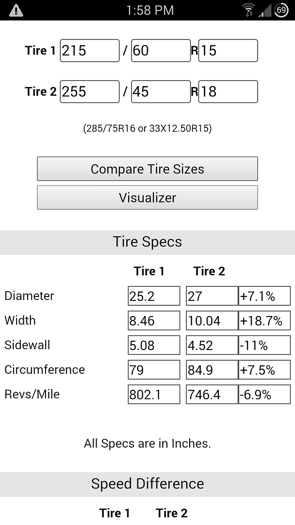

I think it should fit, I think 27" is the max overall diameter that should fit without rubbing from what I remember with my research, however you may need coilovers, not sure since the 88's have more room for a wider tire.
