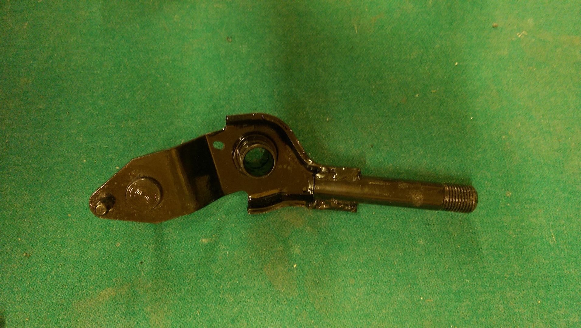

TXOPIE
Posts: 2734
From: Leonard, TX, USA
Registered: Mar 2012
Report this Post04-09-2015 03:15 PM Click Here to See the Profile for TXOPIEClick Here to visit TXOPIE's HomePageSend a Private Message to TXOPIEEdit/Delete MessageReply w/QuoteDirect Link to This Post
All of mine have been purchased from member, GTXBULLET:
$45.00 shipped
Or $25.00 shipped with factory core.
For core refund just mail you stock core with a printout of the paypal transaction and Ill refund $20.00.
This shift lever will fit all FIERO Manual 4 speed and 5 speed console shifter assemblies.

Thanks but I not only want a shorter shaft, I also want a shorter throw (which mean the lower section has to be longer). It doesn't look like that's the case with those.
