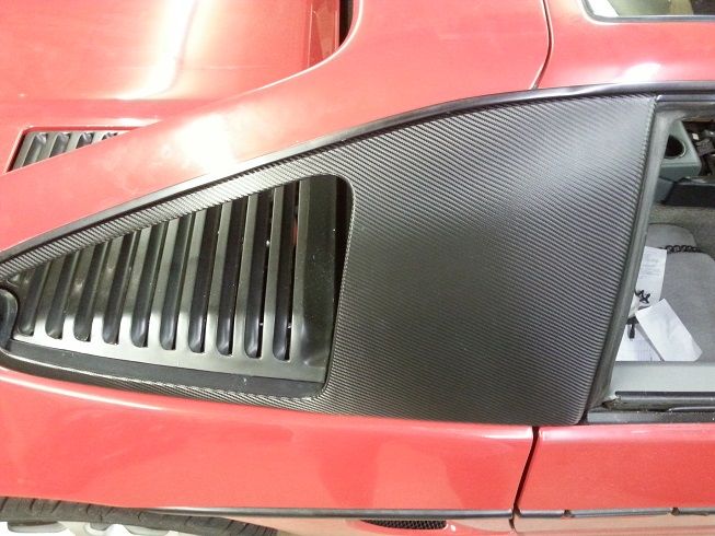

Wrapped mine in 3M carbon fiber vinyl. They are a good quality product and fit pretty well but do require a little work. The perimeter has a little extra curve to it where the oem windows are flat. If this isn't ground down a bit the window will require an excessive amount of double stick tape to mount them. I didn't do that and had to come up with an alternate method to mount them.

How are these for wind noise at highway speed? With the opening like that it looks like they may be noisy, but I'd like to be wrong. I'm thinking of going this route for my restoration, and this is really the only thing keeping me from pulling the trigger on these.

I haven't noticed any increased noise over the solid windows

Don't know much about aero dynamics but not only does the pic with the carbon fiber look great I would think that it would help in extracting heat from the deck lid louvers especially at high speed . Looked over my 88 gt louvers and thought what a bad design as compared to the 85 gt which if I remember correctly were unobstructed. In Vegas when it's over 100 degrees the engine gets up to 220 degrees. Plus it may increase down force on the rear wing.

They need to be painted or vinly wrapped.
