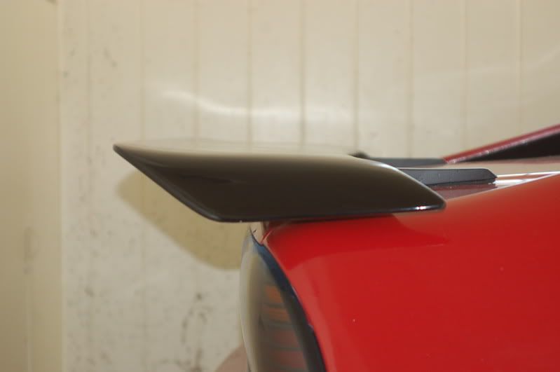

These are pics of them on a GT:

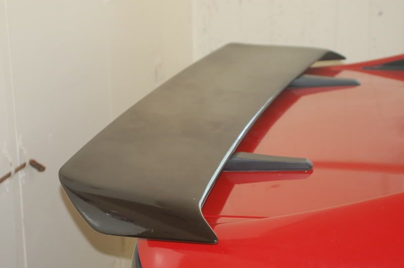

And the notchback:

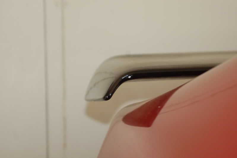

Tony Kania's GT:
These are the old style with the more blocky look. They have since been re-molded, the mounting system improved, and the edges are now rounded for a smoother look.
