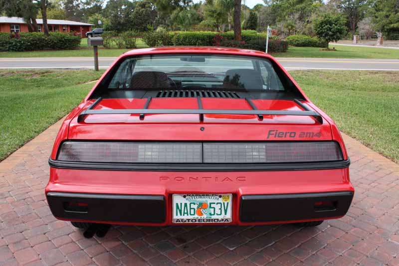

so im missing the drivers rear bumper reflector. i finally pulled the one off the 87 gt and it doesnt fit the 88? the 88 is a formula with a gt back half conversion and the 87 is also a gt but the reflector isnt even close.

Correct. The formula has the 87-88 couple style bumpers, and the GT has aero style bumpers. Different bumpers with different reflectors.

just to be sure, if you can answer or not, are the coupe reflectors bigger then the gt's?
Yep for sure wider. The bumperpad car may have the same size as GT I'm not sure.
Coupe/Formula 87-88
GT
Bumperpad 84-86

Ok well I'm pretty sure it still has the coupe formula bumper so I'll need to find a new reflector or put the gt rear bumper on. It does have a new belt on it so I'm just gunna get the Rodney part for now. Are the stock headers made from cast steel? If so then I would need to braise them closed correct? Thanks
