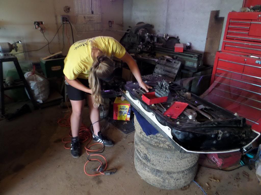

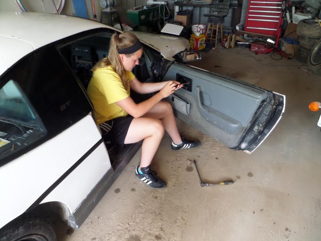

The first project she picked was the electric windows.
They didn't hardly move and with the AC condenser missing she thought the windows needed to come down.
Here Ashley is removing the door panel.
Drilling out the rivets on the door skin so we can work from both sides
Sorry but I didn't remember to get pics of her actually cleaning and lubing everything back up.

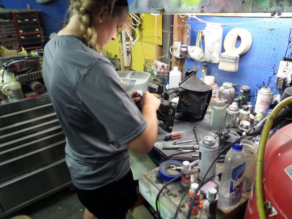

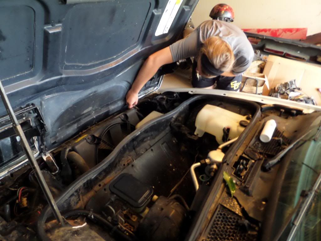

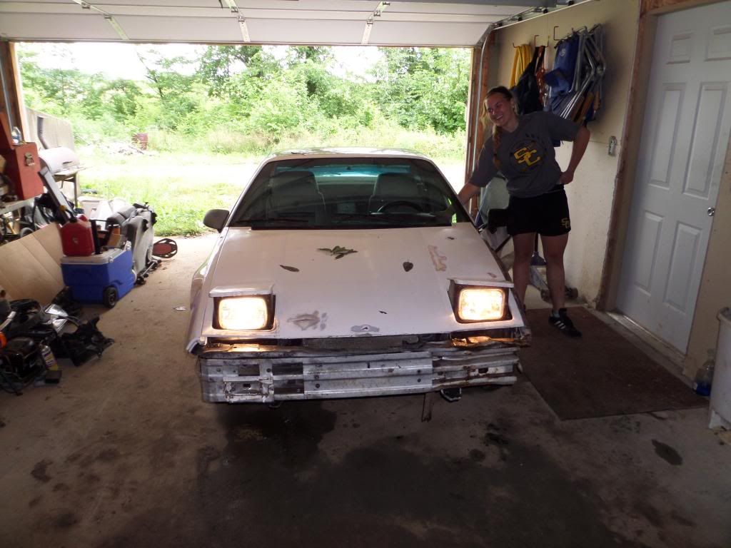

The next project she decided to take on was the headlights. She didn't care for how Sherri winked at everyone coming down the road.

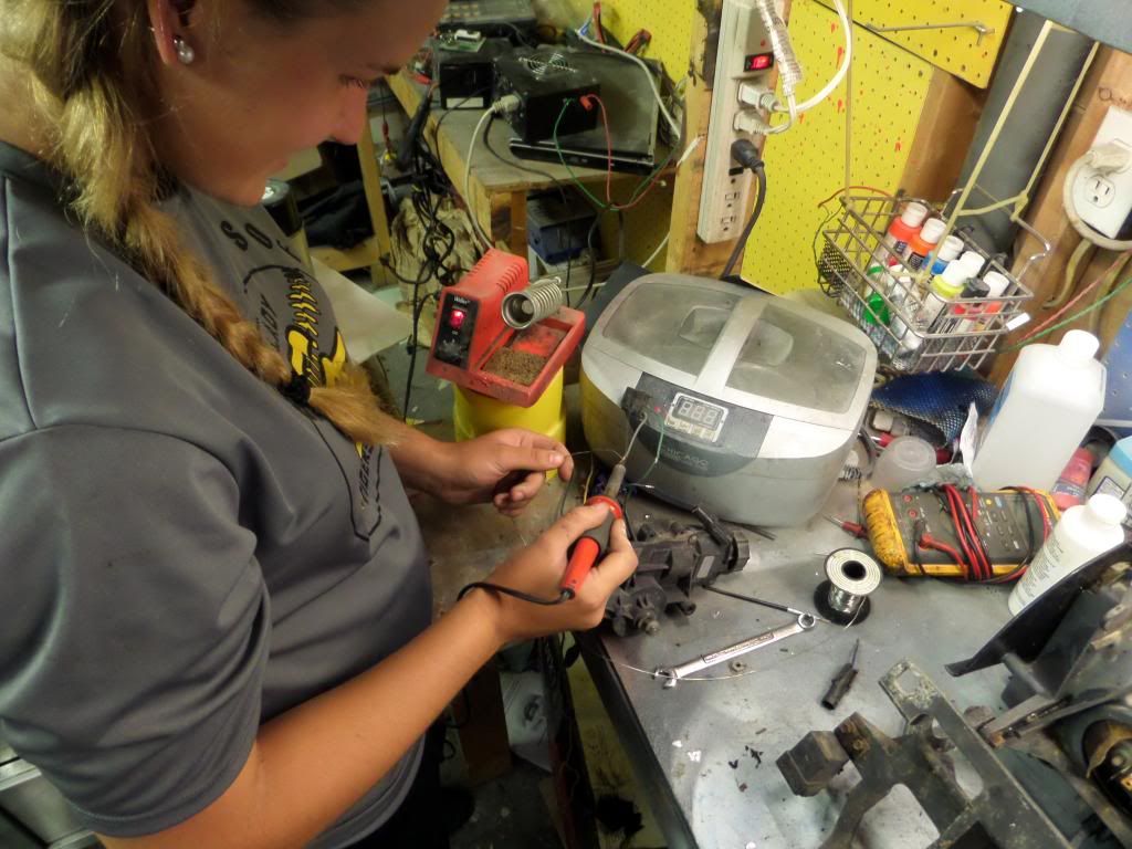

She is trying to remove the right front headlight so we can replace the motor.
After getting the light assembly out I showed her how to solder and made her swap the plugs from the Fiero motor to a set of Camaro replacement motors I had.
Finally got everything solder up now time to get the motor back in the light assembly.
I think she was pretty happy with the final results.

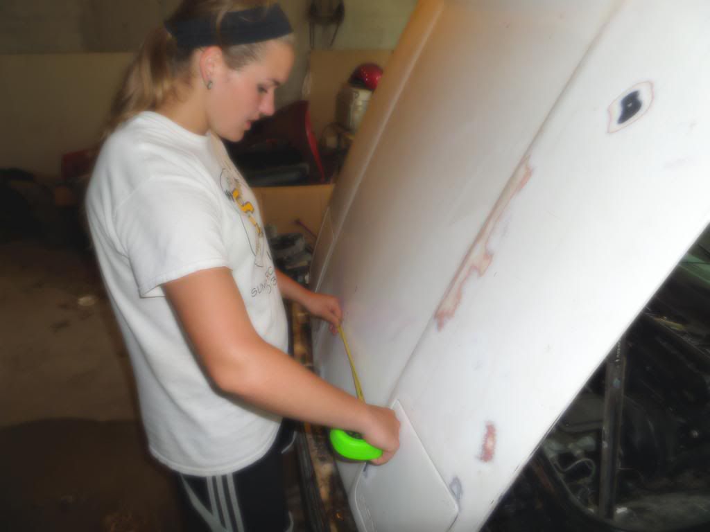

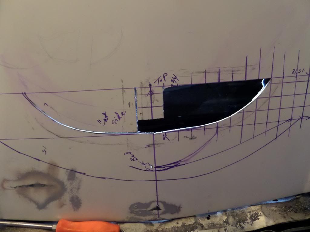

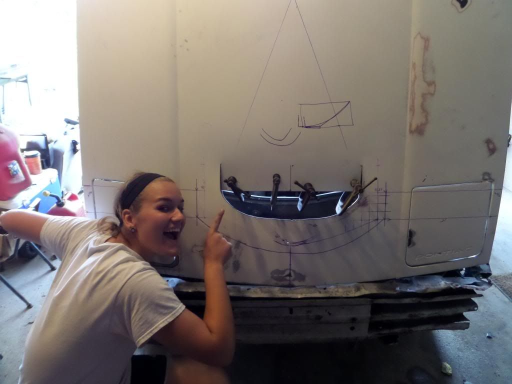

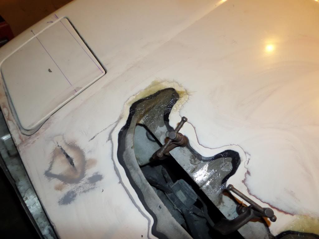

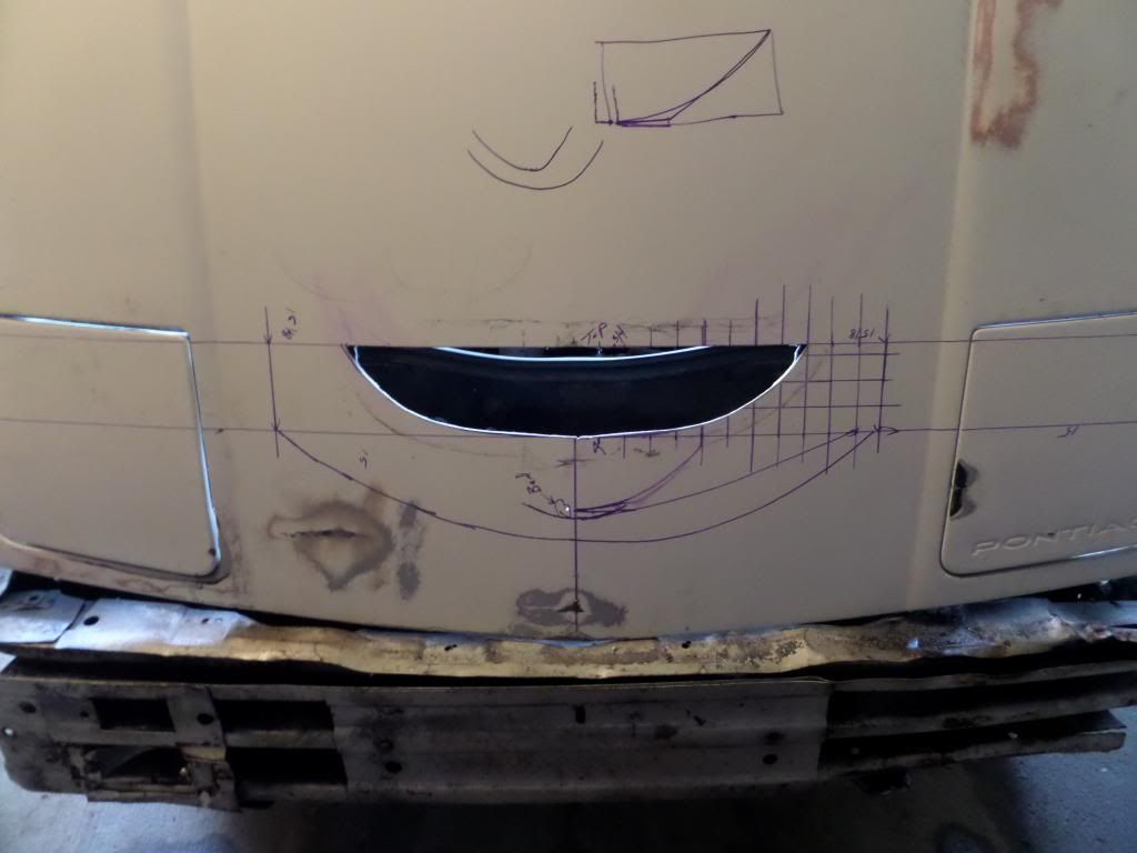

The first big project she decided to take on was a hood vent.
She had seen some pics of other Fiero's with hood vents and wanted to know if she could do that.

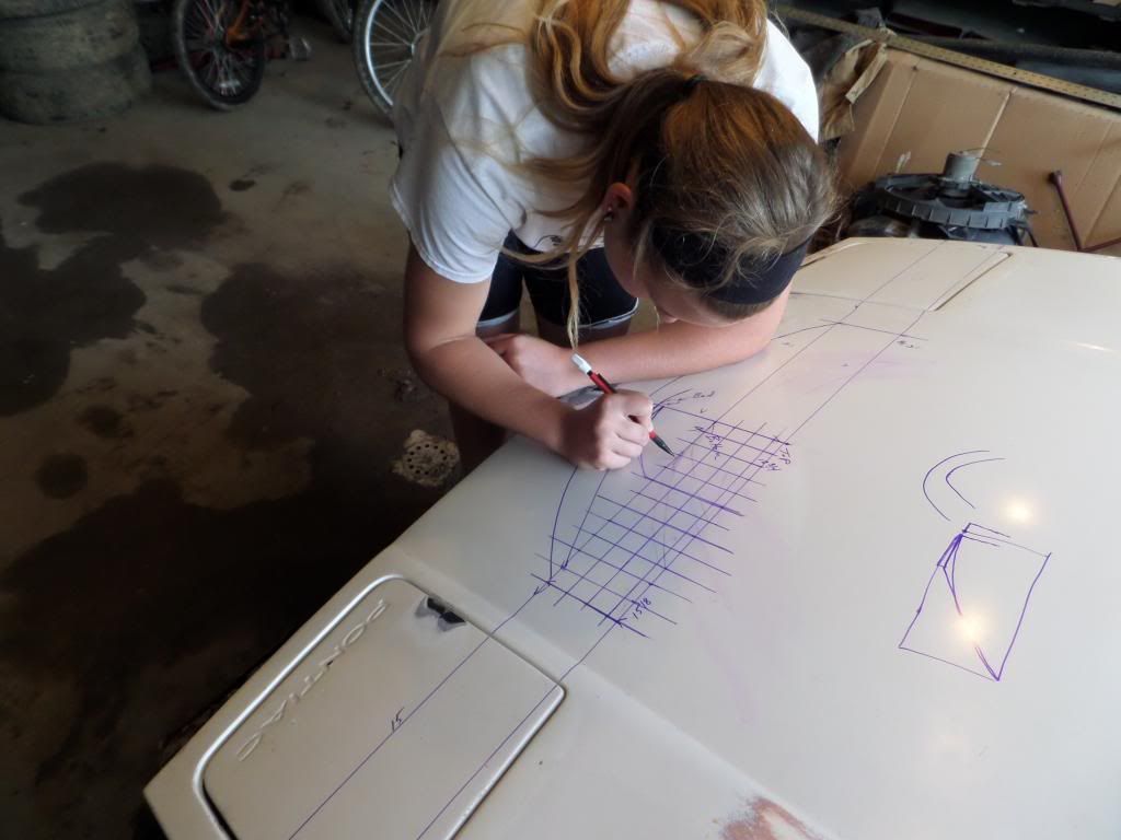

I handed her a tape measure, sharpie and a jig saw. She looked a little dumb founded so we went out and started drawing on the car to give Sherri , the daughters name for the car, a new smile.
Trying to find the center of the hood.
Verifying our center mark from both sides.
We drew out a grid so she could lay out the smile. She is just like me in the fact she can't draw a straight line with the assistance of a ruler so the grid helped her find the curve she was envisioning.
Starting to remove some material for the vent.
Both sides open now

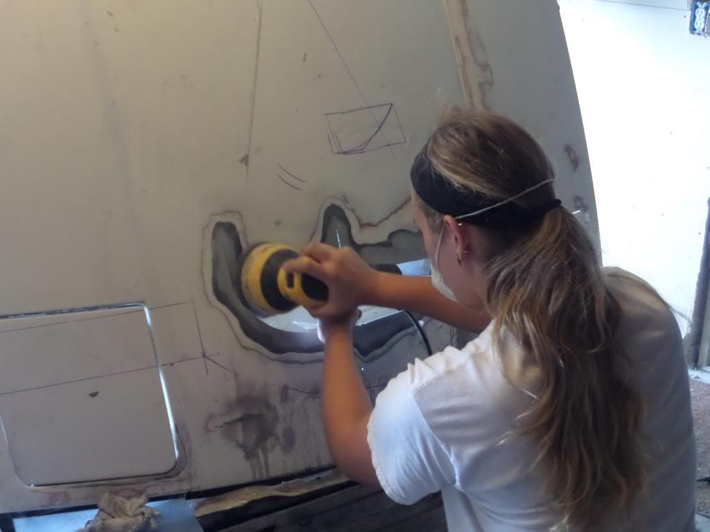

After making the cuts she sanded down the areas we would be glassing to for the vent.
She loves her dust mask!!! Just look at those eyes cant you feel the love
Sanding away

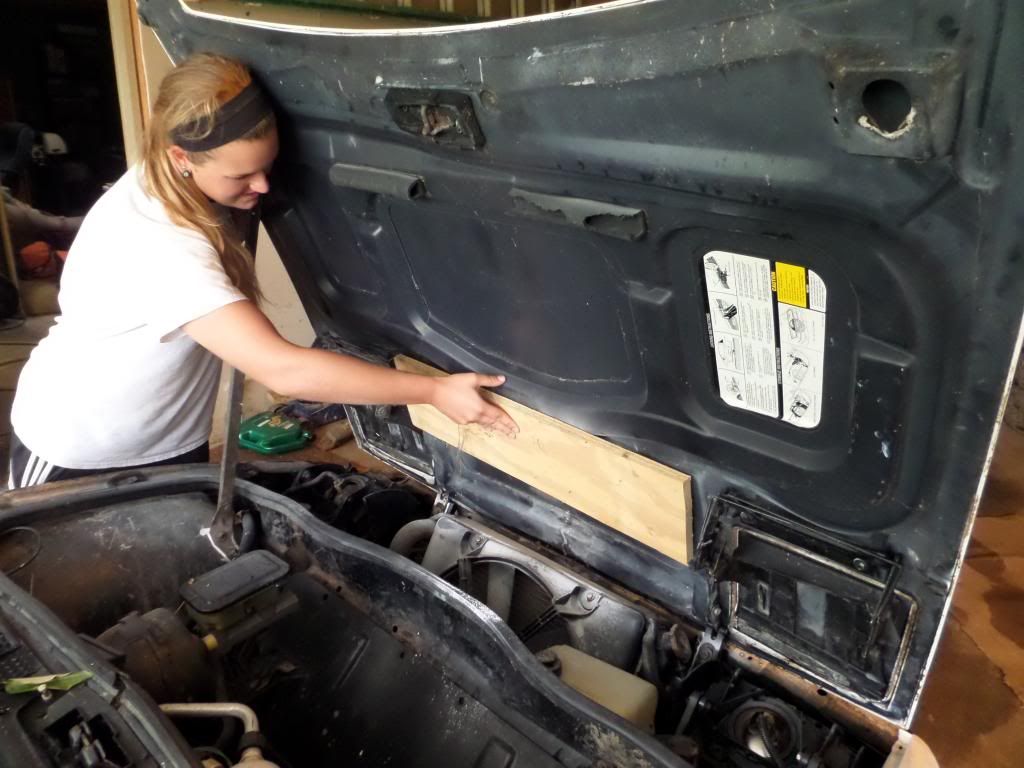

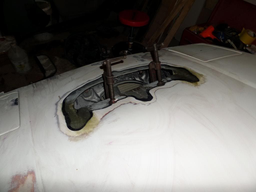

We held the hood in place with a few C clamps and a piece of plywood so the corners could be glassed in and get the basic shape of the vent.
Ashley being a goof and admiring Sherri's smile.

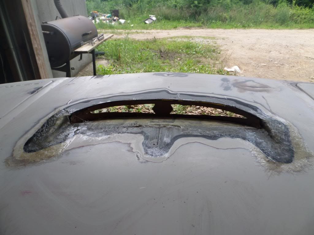

Here are a couple of different angles making sure we have proper clearance for the vent with the hood down.

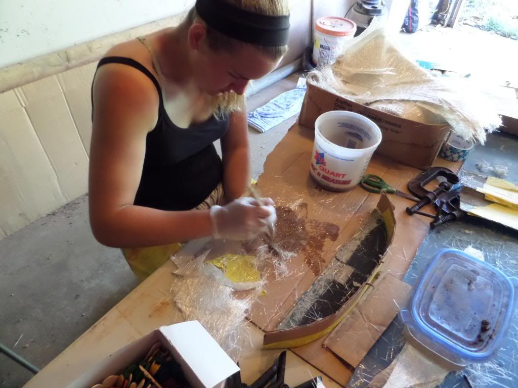

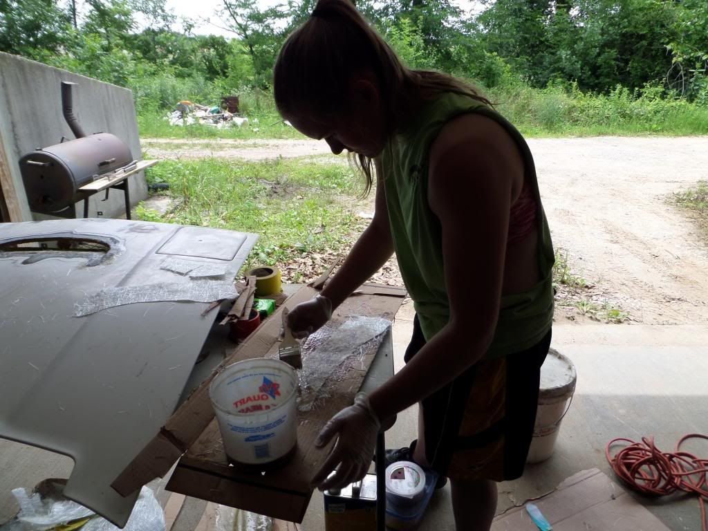

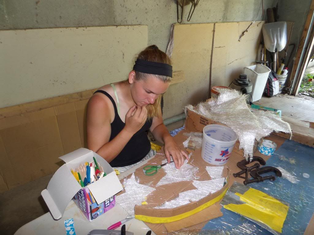

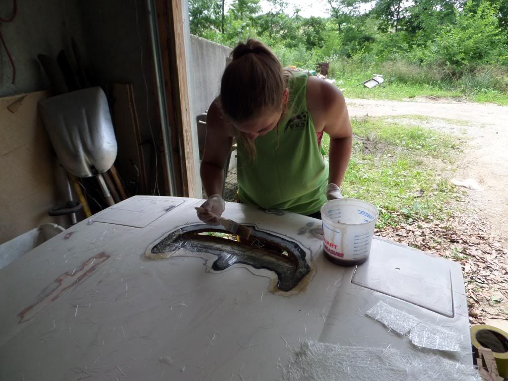

Ashley is learning how to work with Fiberglass and use a mold to make the front of the vent.
Here we have Ashley's part from the mold attached to the hood, just waiting on the resin to cure.

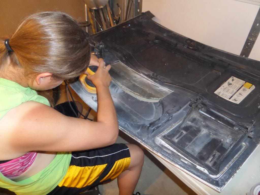

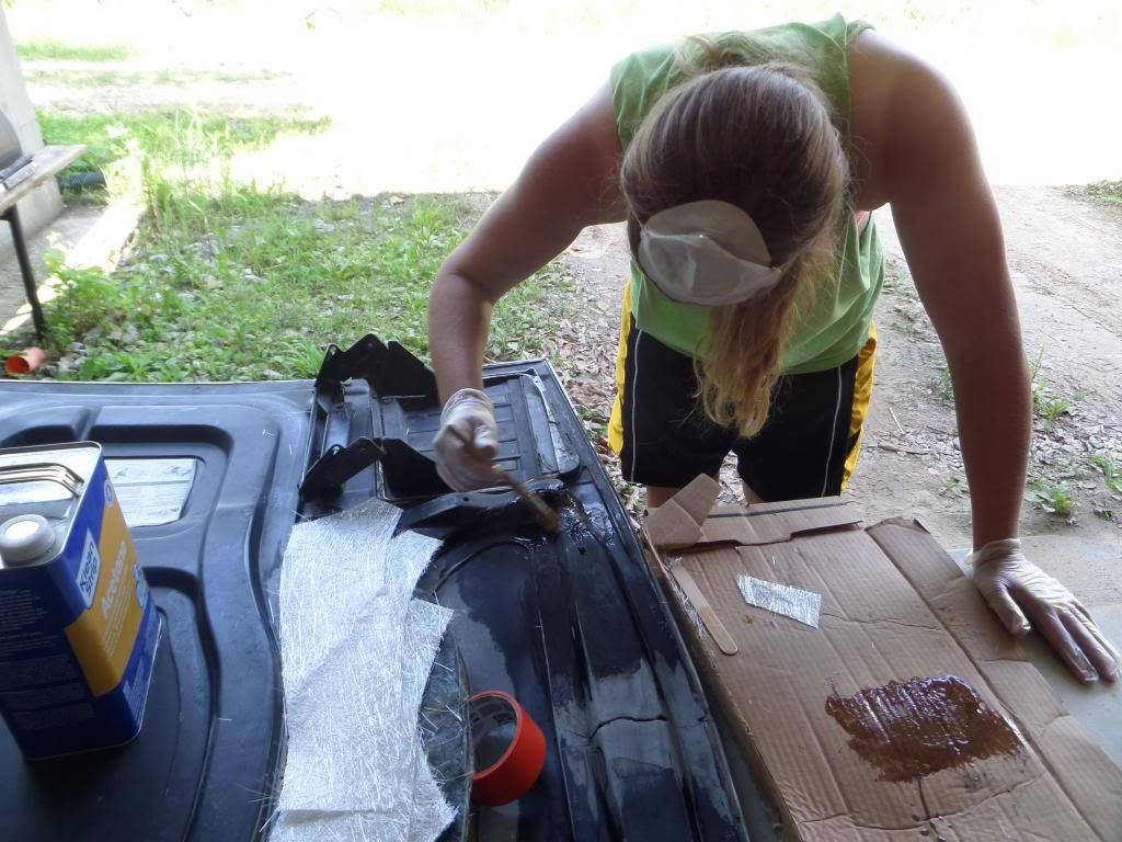

Ashley is sanding the under side of the hood to prep it for some crack repairs and the inside glassing of the vent.
Here she is fixing the cracks and putting on the back side glass for the vent.
She kept telling me she didn't see how her vision was going to work with what we were doing so I did a quick mock up of the vent in card board for her.
Doing some front side glassing of the vent.
Sanding down the glass so we can smooth it out with a little bondo.
First coat of bondo laid down and curing.

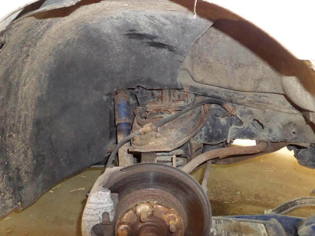

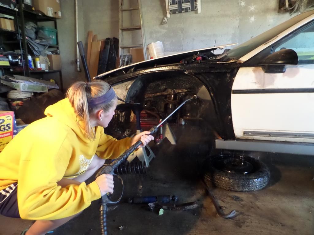

We got back to it Monday, working on the brakes.
Things are a little crusty in there right now.
I also realized I hate working on the rear brakes and hated it even more due to a rusted bleeder valve!
I have heated, quenched, beat, cussed and a few other things at this damn valve but still couldn't get it to move.
It was time to walk away from that problem for the time being or I was going to wind up buying a new caliper!

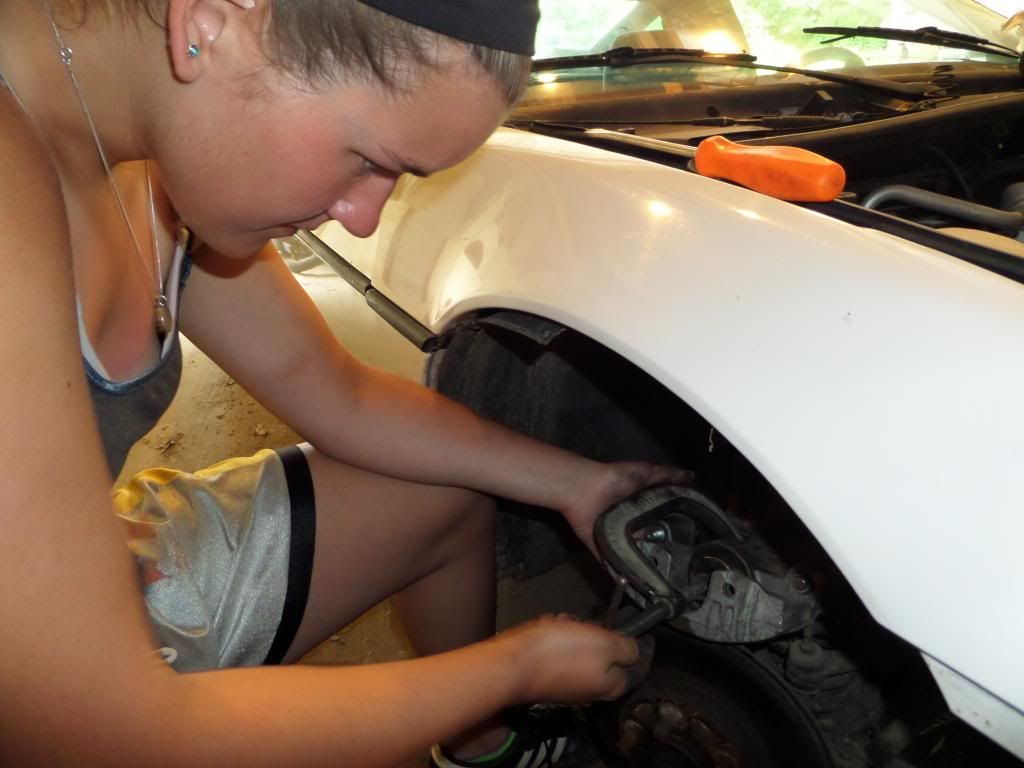

Anywho Ash is back at it working over the front brakes.
Ash cleaning up a little surface oxidation from the calipers, collapsing the caliper piston to get the pads on, checking out the brake lines and reinstalling the caliper.

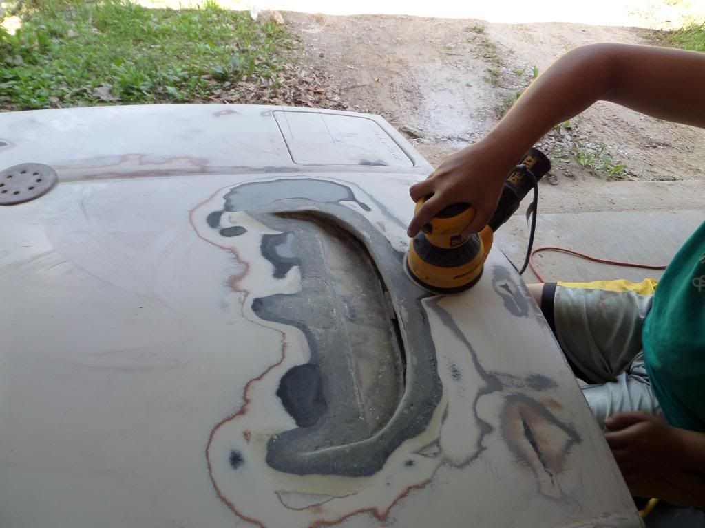

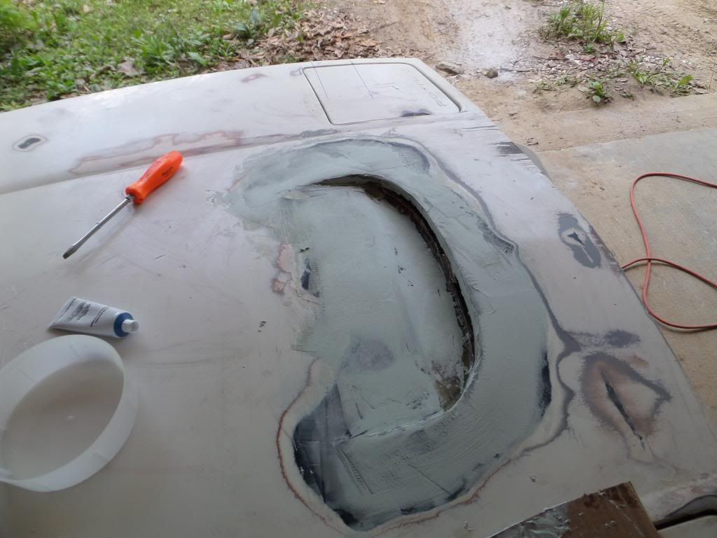

We switched back to the hood today trying to get that project finished up.
Ashley sanding down the hood repairs and bottom side of the vent.
We found a couple of spots that the glass was a little to thin while sanding so we will address them tomorrow.
While sanding one of the discs came loose and before we noticed it the sander was rubbing its hooks on the fiberglass and basically burnt them all away
This led to a trip to the local lumber yard to pick up a new hook pad for the sander and while we were there we ran across some paint that I have been reading about, Plasti Dip.

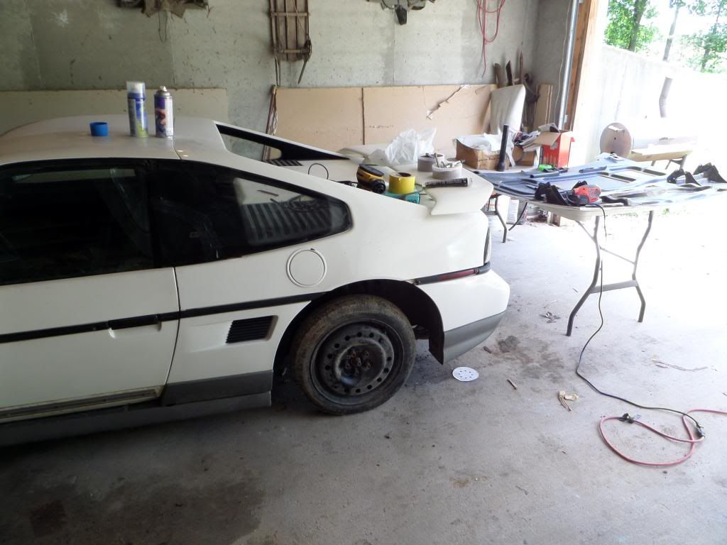

Here is a quick shot of the car before we painted it.
One of the things that caught my attention with this process was the minimal amount of prep work needed. You just degrease and wash your car. Then mask off the windows, headlights, tail lights, etc...
We are using a rattle can to do this test area so the color isn't extremely even but it gave us a good idea of the color and how the product would finish out.
Base paint a semi matt finish.
Here is a close up of the Glossifier coat applied.
What appealed to me about paint the car with this system is your ability to change colors.
If you aren't happy with the color........
Just peal it off, wash the car and go again.
I was quite surprised how durable the finish of the Plasti Dip really was. I figured it would come off with a little scratch of a finger nail but it doesn't.

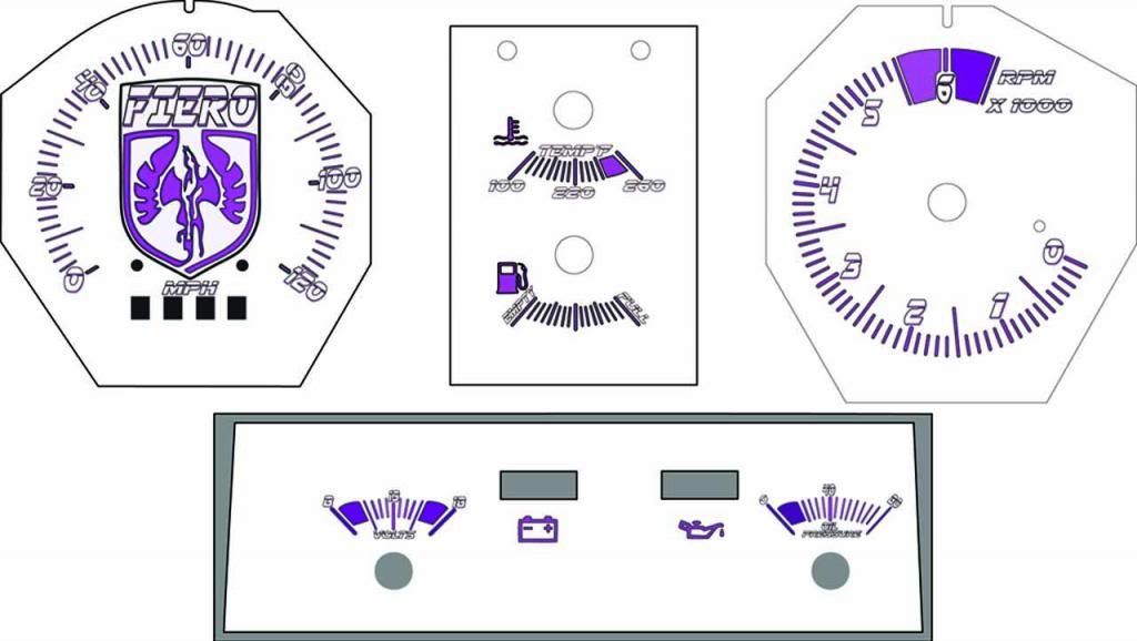

Things have been a little slow the last week or so. Ashley has had to baby sit her cousins but she left me with orders to rework the dash in the colors she has selected for the car.
Here is what I have come up with.
If anyone needs the files I have these converted into Adobe Illustrator format for easier editing.

The left front suspension has been removed to install new shocks, bushings and receive a good power washing to remove the dirt and grime built up in there.
Ash doing some power washing.
