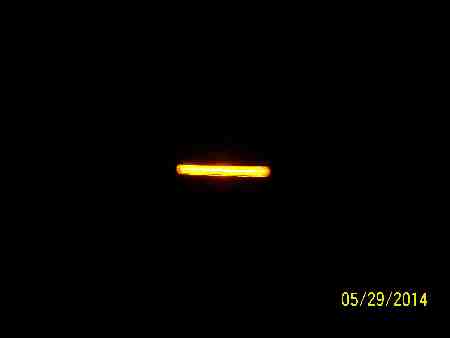

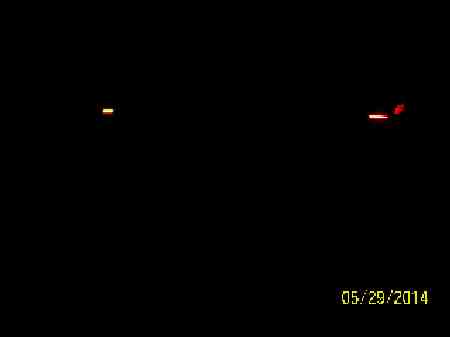

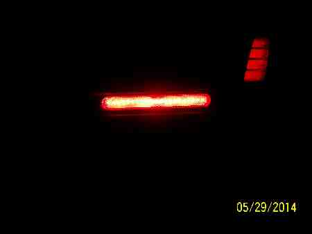

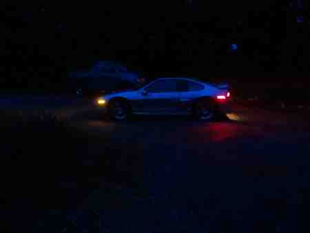

New led light strips have twice as many led’s now they come in 120 led’s to the meter. The old style had 60 led’s to the meter. This is what they look like in the side markers.
I like them as they fill in the marker all the way with light.

I soldered the leads on the attaching pads of the strips close to the marker hole the bulb went in. Wire used was from local Hobby shop in the train section. Wire can be very light weight as the load from the LED's is very light. I cut my bulb sockets off removed the bulb and used it as a plug to cover the marker end back up. I ran the small wires down the edge of the marker socket and pushed the plug back in to hold the wires securing them from being pulled buy the wiring harness. My installation was to solder the wires directly to the harness as led's last so long it will be quite a while before I ever have to remove them.
If you can solder you can do this. For the Bridge rectifier the + & - go to the light strip the 2 ~ go to the harness any direction. This is for the FRONT.
The REAR you must identify the + & - in the harness attach the wires if they light they are right if the don't switch them around.
