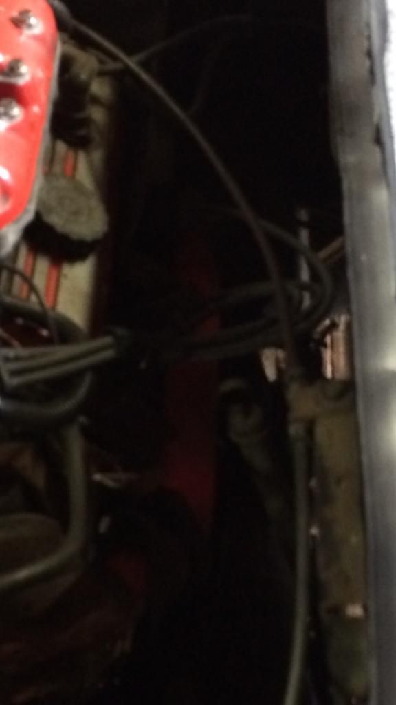

Well... After about 5 times of quick starting then dying within the first few seconds of starting we got it running... Sorta... It was surging from 1600 to 500 back up to 1600 and it would almost die but then quickly go back up. We tried re connecting the ground wire and still the same thing. Eventually it got running normal and then we noticed the exhaust headers were glowing orange (I have a picture). So we shut it off and then tried starting it about 5 mins later and it refused to start at all. It was turning over and this demonic grinding noise came screeching out of it. My dad and grandpa had never heard anything like that before... I've decided on rebuilding the entire engine. Were gona drop the engine next weekend and check to see if we need to bore the cylinders. Then I'll decide wether or not to go 3.1 crankshaft or not. Then we can dig in.
Fier-oh41229
Posts: 141
From: Niagara Falls NY
Registered: Dec 2012
Report this Post11-30-2014 11:48 AM Click Here to See the Profile for Fier-oh41229Send a Private Message to Fier-oh41229Edit/Delete MessageReply w/QuoteDirect Link to This Post

Report this Post11-30-2014 01:11 PM Click Here to See the Profile for css9450Send a Private Message to css9450Edit/Delete MessageReply w/QuoteDirect Link to This Post
Are you sure its not something simple like the timing being way off? Or the cat plugged?
An engine rebuild (or swap) is an expensive and time consuming way to fix a timing problem.

Report this Post11-30-2014 01:22 PM Click Here to See the Profile for Fier-oh41229Send a Private Message to Fier-oh41229Edit/Delete MessageReply w/QuoteDirect Link to This Post
I have no idea what it is or what it could be. I want to rebuild the engine anyway and this is a good excuse. When the engine starts running smooth it idles at 1500rpm which is a bit high. There is a bit of smoke coming off the engine which is probably a bit of oil burning off the engine. There is a slow coolant leak out of either the radiator or the hoses. Thats about all i know.

Report this Post11-30-2014 08:45 PM Click Here to See the Profile for Neils88Send a Private Message to Neils88Edit/Delete MessageReply w/QuoteDirect Link to This Post
A lot of people here keep telling that you don't need to rebuild the engine to fix the problem. But I totally understand that you want to take the opportunity to get to know more about the inner workings of an engine by doing the rebuild. Personally, I think this is a great idea. I agree with others that an engine rebuild would be overkill for a basic repair, but there is definitely lots of value from an educational point of view. Go for it, take your time with it and pay close attention as the rebuild progresses.
