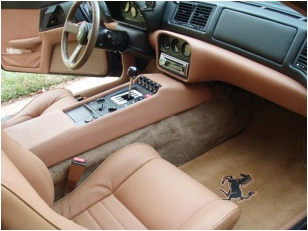

I think that I know the 355 interior shots quite well (especially with the floor mat in place). Since you are using VDO instrumentation and a 3800 SC engine there are a few quirks that you might need to know about prior to installing the engine and/or instrumentation. I detailed them along with potential solutions in my F355 interior install thread
https://www.fiero.nl/forum/Forum1/HTML/083377.html
Get in touch with me if you need more info and I will see if I can help out.

TXOPIE
Posts: 2734
From: Leonard, TX, USA
Registered: Mar 2012
Report this Post03-13-2014 03:04 PM Click Here to See the Profile for TXOPIEClick Here to visit TXOPIE's HomePageSend a Private Message to TXOPIEEdit/Delete MessageReply w/QuoteDirect Link to This Post
Nelson
SWEET! Thanks Nelson....will let you know when it goes down to that part

The information is in the short build thread but you need to make the mods prior to installing the engine if you want to do it the easy way. I did not and would recommend the easy approach to anyone else.
Nelson

I meant the under body/frame with all of the car's panels removed. Not the kit itself...They are going to be fresh panels and metal.
